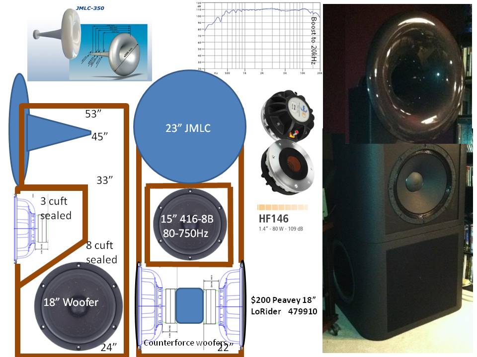

Have you given any thought to a 3-way speaker with a well designed sealed cabinet for the 416-8B? Sealed alignments offer: the best transient response; the lowest intermodulation and lowest total distortion; no port noise; AND the opportunity for REAL BASS from REAL WOOFERS.
The 416-8B in a 3cu ft sealed box has an F3 ~72-75Hz with Qtc = 0.7 Butterworth maximal flat alignment which most listeners favor. A 5 cuft sealed box has Qtc = 0.577 minimal ripple Bessel alignment. A 7 cuft sealed box has Qtc = 0.5 critically damped alignment.
Most critical listensers favor a 700-750Hz crossover for the 416-8B

I like this design/thinking. If I were starting from scratch, I might go that way myself. You have Gary Pimm/Lynn Olson's work as your guide. I'd probably opt for the 400hz LC though unless you are dead set on 1st order crossovers as it will help with the top end more than the larger horn.

Until now, no I haven't given any thought about a 3-way speaker with a well designed sealed cabinet. So, I will be contacting you about your proposal more in detail.

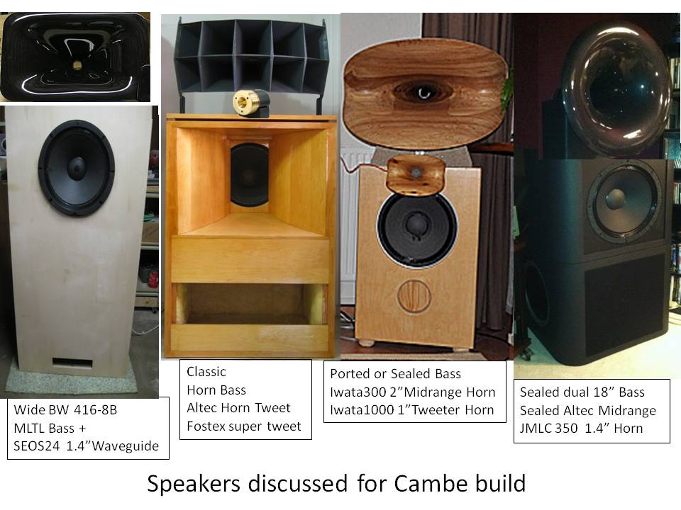

Yeah, once one moves beyond a relatively minimalist system, lots of alignments become viable to best overall meet the needs of the app, though I still prefer a wide BW mid-bass to be loaded with some form of TL if not compression horn or OB loaded.

If you decide to construct a 3-way speaker using a sealed cabinet for the 416-8B, you will probably get the best brain-trust support from starting a new thread.
Some info on your room dimensions, support equipment, passive/active , analog/digital Xovers, budget and goals can produce a more optimal design.

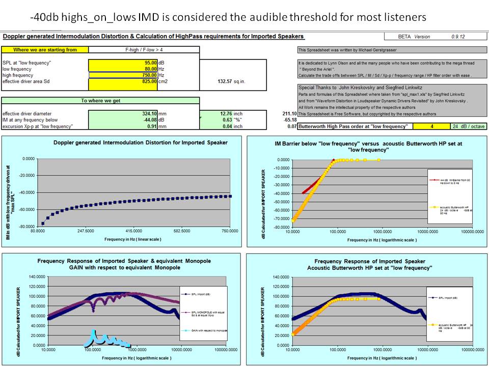

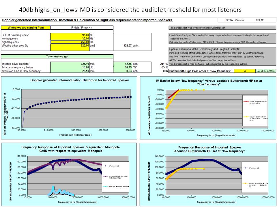

Plots on IMD for lo-30Hz vs lo-80Hz.

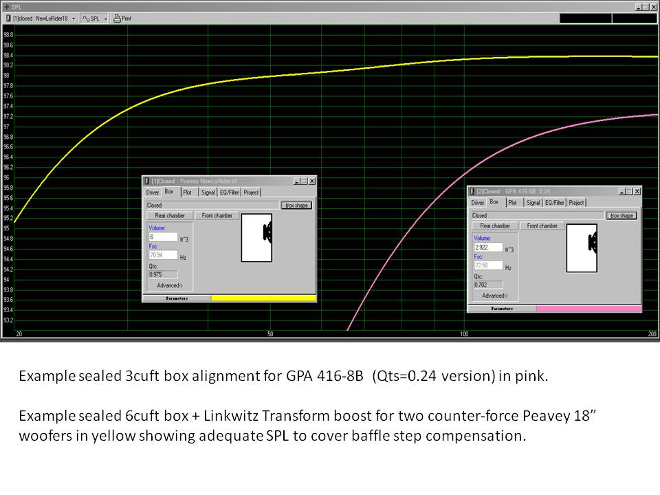

SPL plot of sealed dual 18" woofers and sealed 416-8B.

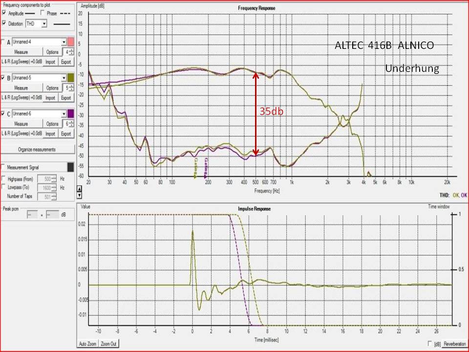

Web SPL measurement for the 416-8B which illustrates why 700-750Hz Xovers are often selected.
