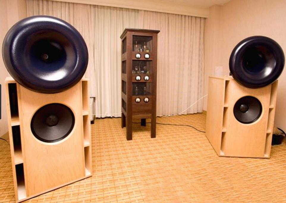

Bison was (thank you for the reminder Dave) a custom MLTL / reflex we did back in '11. Hybrid because I use the same definitions GM does. Which presumably means we're dinosaurs. Excellent.
For comparison, in volume terms it's a 10.5ft^3 [nearly] cabinet; for comparison the Stonehenge III is 5.6ft^3 & Stonehenge V, which IIRC is in essence a restyled 620 is 9ft^3. Fb is 30Hz [about]. Going by slightly fallible memory & reverse engineering what I did 6 years back (I've misplaced my notes), then assuming the GPA 604-8H-III, on a voltage source amplifier it has a moderate EBS style alignment for near-wall or corner usage. With the 2.5ohm - 4ohm typical for SET amps that shifts to a more conventional lightly damped alignment so may need slightly more space from the front wall but will still be relatively forgiving of placement & should give good output to the mid 20Hz region with typical room gain; with the SET amps it could easily be tuned slightly lower to get a bit more damping if desired; this is not a difficult box to tune as it's quite large. All panels are doubled as it's a big box. Lateral driver offset is optional to dissipate standing waves across the baffle (rocket science this isn't & I see no reason a degree of this could not be applied to the other boxes where sufficient clearance is available). Vent placement is optional; front, rear or down-firing with plinth & spaces, which would be my preference.

Thanks Scott! So it seems the Bison cab should work well then for the GPA 604III as is? Then with various room placement he could adjust the sound nearer or farther from the wall as he likes the sound etc..
Are there plans available for purchase for the Bison? I think he mailed you about them after I mentioned about the cabs. You'll probably see his mail.
Edit: He recently purchased the Vulcan plans a few days ago for his fe206en drivers that he wants to put in a different room, so you may know who he is already. His name is Rob, and he's in the Toronto Ontario area.
Sure, that's what it was designed for. I'm looking at the pdf as I type. It's a flexible design, easy to place & tune. Advantage of an acoustically large enclosure.
Yes, plans are available for a small charge -not for me, I don't want anything; it would go direct to Dave, who did the CAD drawing.
Probably easier than going through me; saves needing to relay emails!
I should add -if the space is available, GM's big MLTL will almost certainly blitz them all. I haven't looked at the details, but I'd take that one as read, above all since it's Altec. 😉
