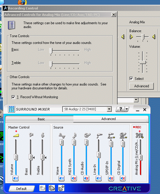

If your creative card is anything like my Audigy II ZS then there are a few important things you need to do to get it to work.
You must choose the Analog Mix as your recording source, and in the control panel (ie system one) sound settings you must go to the recording control panel, and click on the advanced button for analog mix, and tick the record without monitoring tick box.
also do not mute the line in control ( I think the unofficial speaker workshop manual says to do this).
see screen print.
Tony.
