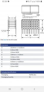

Mr. Marsh's excellent capacitor article from years ago suggested that low-value C0G-NP0 caps were low distortion and acceptable for use in audio amps. It seems today that it is almost impossible to buy old-fashioned single-layer ceramic caps as everything is MLCC. If the value is <100pF and the dielectric is listed as C0G-NP0 is the cap still acceptable if it is also MLCC?
MLCC = multi-layer ceramic cap
It's 500V rated, but it's BIG! This thing is ment to last more than a generation, but today's products are ment to last 3 years...And I see it used in high power inverters more than audio...

The issue with ceramic caps is the dielectric is ferroelectric, so it has dielectric hysteresis, this imparts distortion as energy is lost to heat each time the polarisation changes. This will distort the waveform regardless of the number of layers.
I recall a slide deck by one of the founders of Audio Precision that indicated that C0G/NP0 capacitors outperform film capacitors.
You can use X7R types as well as long as you don't impose too much audio signal across them. Also, if you do go that route, choose a physically large capacitor rated for a higher voltage (so 50 V even if you only have, say, 10 mV of audio signal across it). Obviously if you're aiming for -140 dBc THD this approach is out, but for lower performance stuff it's fine.
