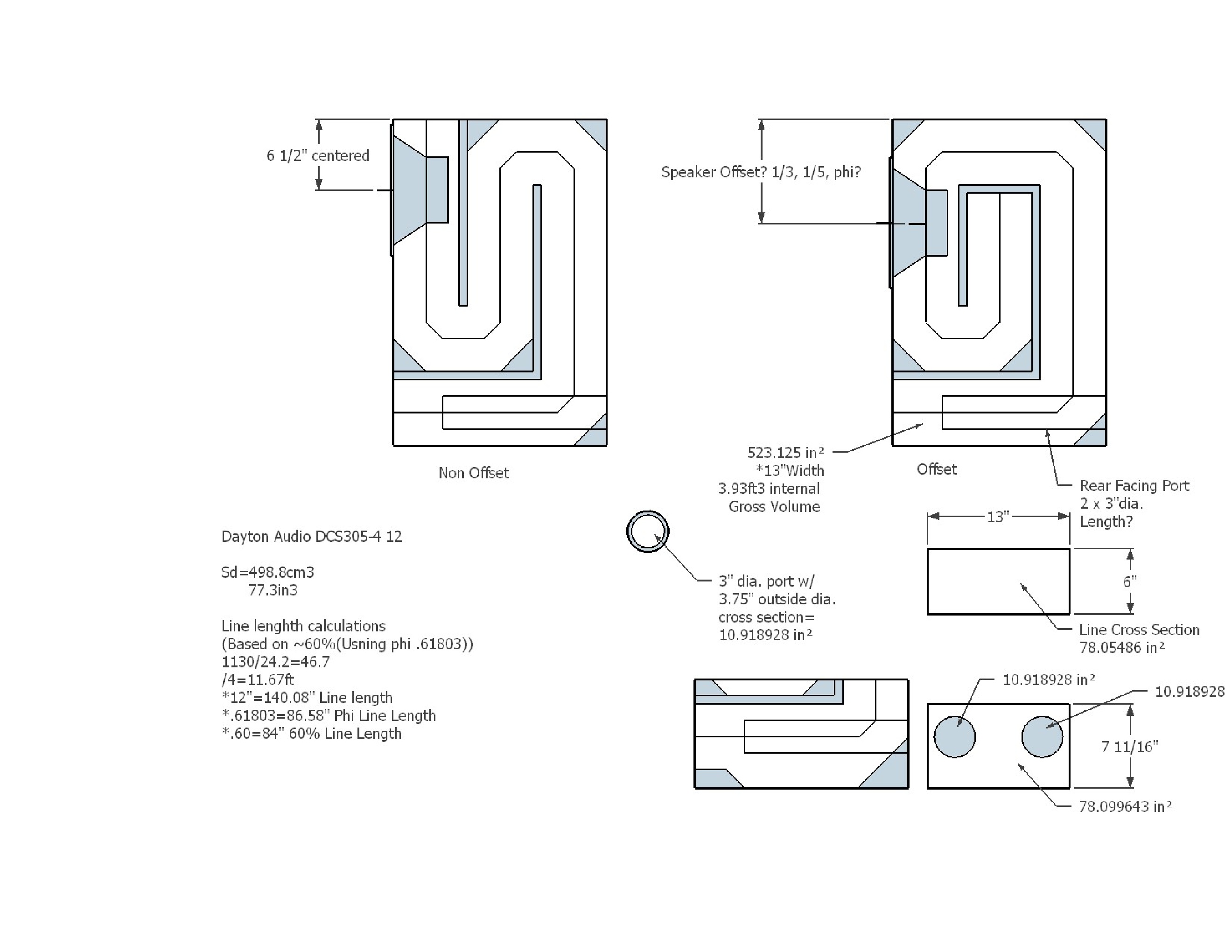

Ive had a hard time finding anyone publishing anything about useing this alignment in a subwoofer application, but the few rules of thumb ive found and that ive prescribed to my initial design are as fallows,
1. Non taper line legnth can be ~60% of a traditional TL line length.
2. Port tune to the box vb.
3. Speaker offset from the closed end 1/3, 1/5, depending on the desired harmonic to suppress, if any offset at all, max gain with no offset but a sharp dip at the first harmonic.
This is very general information ive gleamed from the google box. True or untrue it was my starting point for this design.
I used the golden ratio of phi (.61803) for the line length, my initial design goal was to incorporate phi into as many dimensions as possible.
Line lenghth calculations
(Based on ~60%(Usning phi .61803))
1130/24.2=46.7
/4=11.67ft
*12=140.08" Line length
*.61803=86.58" Phi Line Length
*.60=84" 60% Line Length
Resulting in 3.93ft3 internal Gross Volume via the layouts ive attached.
Ive also proposed a cut away of extra space where the ports inter into the line to maintain the sd cross section.
Ive also proposed two 3"dia. ports because that is the current stock of tubing i have available, extra thick with an outside dia. of 3.75". This sub will be played a maximum volume often, and my current enclosure cuff's quite a bit a max volume.
Any and all advice would greatly be appreciated and any debate is welcome. I need help with any simulations (speaker offsets) and proposed design adjustments. Also port length which ultimately would hinge on any design changes.

My first thought is that this driver should not be used in a mass loaded TL because with a relatively low 0.4 Qts, the motor is strong enough to be used in a plain tapered TL. This will have significantly higher bass efficiency as the vent area will be many times greater than the two round ducts to allow an ease of air flow fr the back side of the cone. A MLTL is really meant for a moderate to higher Qts driver of circa 0.5 to 0.7 to allow the tuning of the bottom bass corner frequency to be below that of the natural box length frequency. In this case, the length is quite long at 140in and Qts is low at 0.4. 140in is a 24Hz natural 1/4wave frequency. No need to mass load as it matches the fs already. I would do a 4:1 taper and make total volume equal to Vas and set baffle width at about 2in wider than bezel. Offset driver by 20% to 33% from sealed end.
So 3.2 cu ft is 14in W x 18in deep x 22in H. Try to get at least a 40Hz tuning or 84in long. That’s about 4 folds along 22in. Go folding scheme like this: 8in x 5in x 3in x 2in vent.
Then mount driver at first fold or 20% from closed end. I would fold vent around to front if you want to add another 18in or vent out the back or top. This will give 33Hz tuning. Perfect for 24Hz fs with 0.4 Qts.
Try sketching that.

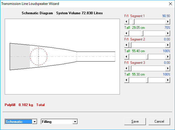

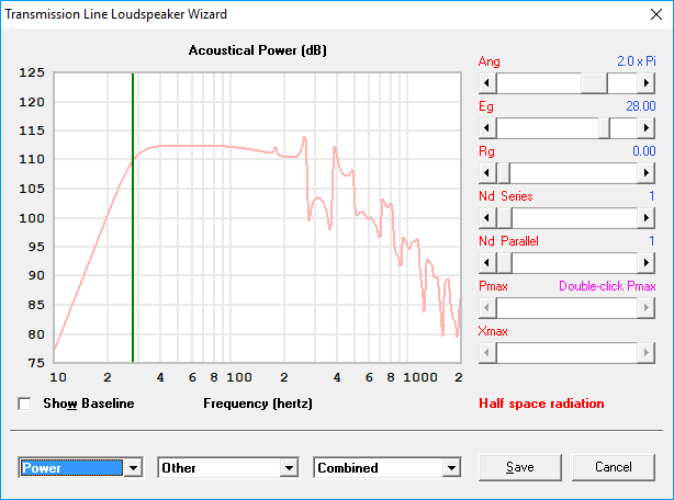

Nice low resonance. Roughly like my driver in the first link bellow. Think in terms of keeping that resonance where it is rather than boxing it upwards. TL's traffic in resonances, not much different than BR's. A long well-damped pipe doesn't. It just takes the back wave and handles it otherwise.
Nice recording but his Ruffatti organ in Davies Hall with roughly the same pieces is better.
17 foot pipe sub 12-230 Hz ±5dB - diyAudio
Long pipe to sequester rear wave - diyAudio

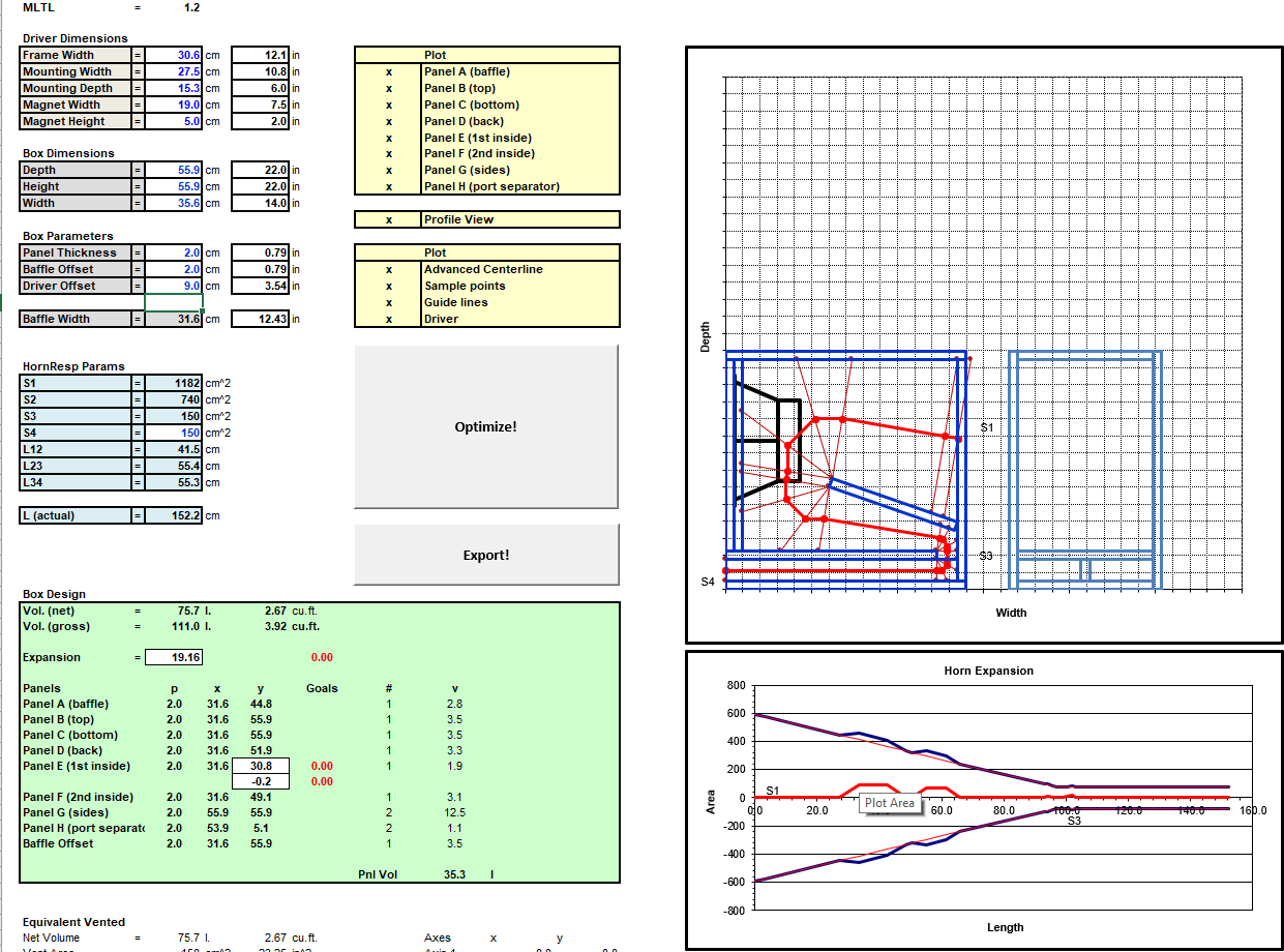

After playing with my workbook for awhile, I was able to come up with a similar MLTL to my "Boom Unit", one that would fit the DCS305, given the published parameters. This should be considered a preliminary design, and some fine-tuning will be required, but it does look promising.
