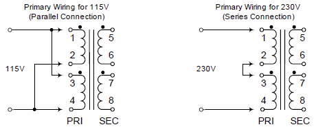

when I saw the price of the HV board. Im gonna get my transformer guy to wind
me 2 new ones. To make his job easier would be great if you happen to know what
the spec are. I curious about the 2 inner connection on the primary side Bolserst, what
is it ?

The transformer uses dual 115V primaries. They are wired in series for use in countries with 230V mains. Wired in parallel they work for countries with 115V mains.
The best help for your transformer guy would be to provide him the transformer from the working speaker as a sample to work from.
