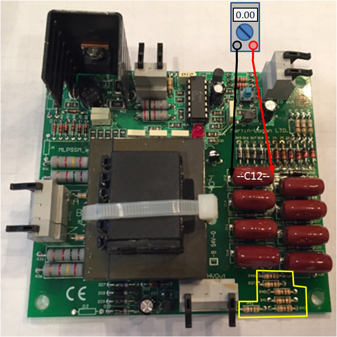

Ok, so you have narrowed the problem to the HV bias board.

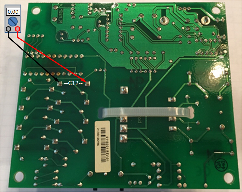

The first stage of the HV multiplier is 300VDC, so you can test it with a standard DVM.
To measure, set your DVM to highest DC voltage scale and place probes to the C12 lead wires as shown in the attached top and bottom views of the board. Compare the voltage reading across C12 on both boards to see if they are similar or if the quieter board has a lower reading. Let us know what you find out.
If they both read close to the same voltage, the next likely suspect is the resistors that Tyu mentioned. I put a yellow box around them in the top view of the board. There are 6, and each should measure as 10Mohm. Sometimes one or more can fail and read a much higher resistance.
NOTE: For the 300VDC measurement, the power supply must be plugged in and music playing so the auto ON/OFF has been triggered to the ON state. Once triggered, it should stay in the ON state for 5 - 10 minutes even if the music is turned off.

Thank you very much Bolserst,
Will verify the voltage. Yes I have
measured those strings of 10 meg resistors all reading above accept 1 which reads only 8 meg or so, wondering if it has any effect on lowering the volume.
My Odyssey is an old lady now. Since I’ve already open her up, do you have any suggestion on servicing the bias board Bolserst ? I do notice that on both boards
the side where the HV is located are all yellowed seems like it running hot.
Also the red led does not light up even when music is playing.
Many thanks again for your kind advice

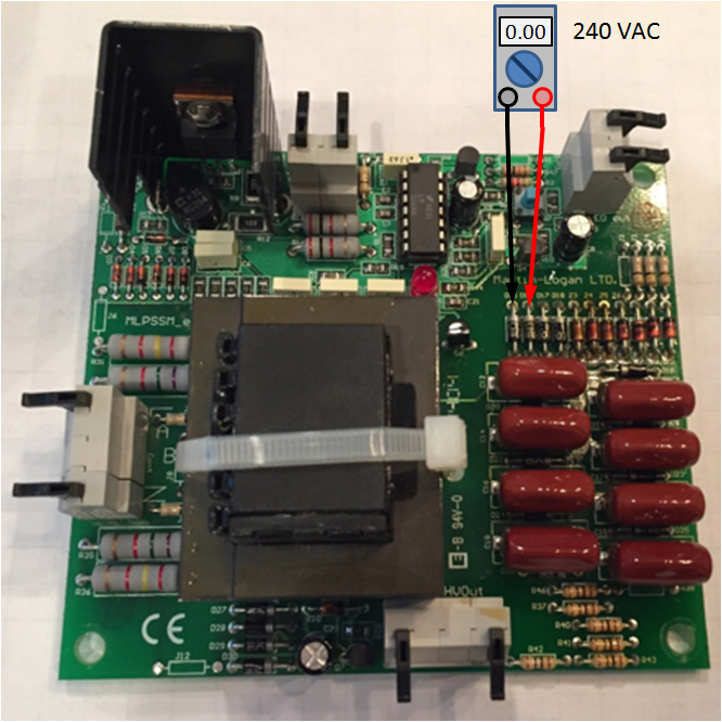

Hmmmm...sounds like I have missed something along the way. At the beginning of the thread you said one speaker was a little quieter than the other. Now you are getting very little output. Very little output(and distorted) sounds like you are not getting any bias voltage to the panel at all.
A few questions to help me understand:
1) Is one speaker still working OK?
2) Could you get a solid 300VDC reading from one of the speakers but not the other? or were both of them fluctuating. You will not get a solid reading if the auto-ON has not been triggered.
3) You mention that the LED on the board does not light. This LED lights when the auto-ON is triggered and the HV supply is activated. Does the LED light on one board but not the other? Had you ever seen the LED light on either board?
A preliminary step you might check is the output of the power transformer that feeds the HV multiplier. It should measure about 240-250 VAC when the power cord is plugged in. You should be able to measure this voltage at all times whether or not there is an audio signal or if the auto-ON has been triggered or not.
If you confirm you have this voltage present, I can show you how to temporarily bypass the auto-ON function to check that the rest of the HV supply is working OK.
Yes Bolserst your reading correctly. Originally only lower in volume on 1 panel. Remove HV board from good speaker to test. Bad speaker sounded ok so confirm Hv board is problem area. Re install good HV board back onto the good speaker. Re install bad Hv board back into bad speaker just to varify again. Yep all not sound accept at almost full volume which is distorted. I understand what the music sense signal is suppose to do thats why I ask why do I get music playing even when red led is not lit. This is on the good speaker as well.
