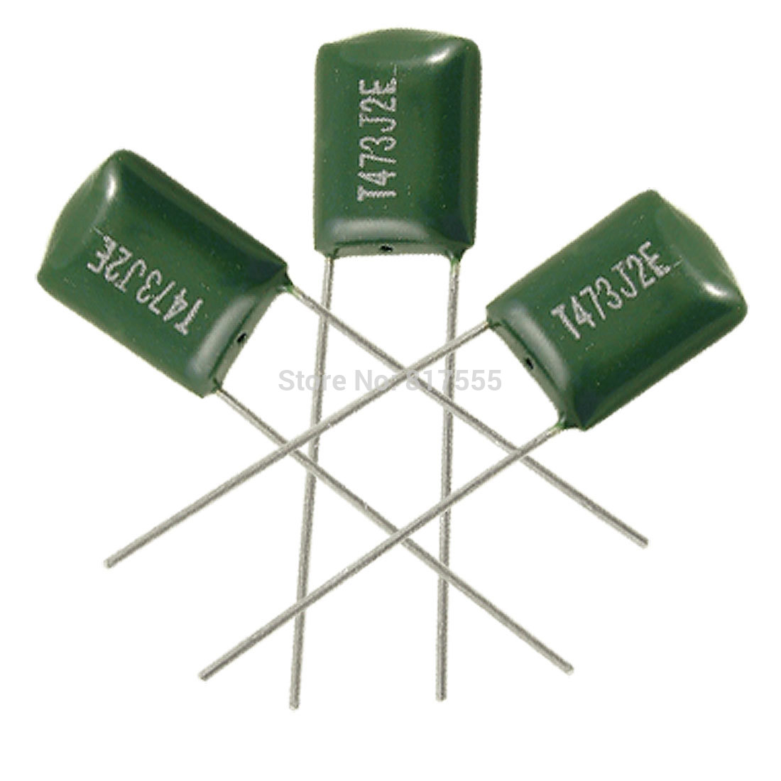

between a green polyester mylar film capacitor and a polyester film box type capacitor,which one do you suggest to use in a tone control?
  • 100-x-0-047uF-5-100V-Polyester-Film-font-b-Mylar-b-font-font-b-Capacitors.jpg
