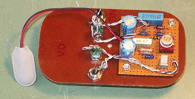

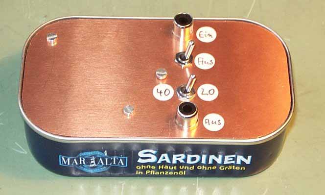

OIL ANYONE?
For Tuna Fish encased in metal casings oil filling is definitly recommended....
This one's for the smaller projects:
Sardine preamp, AKA the Aldi Project:
Cheers,;)
