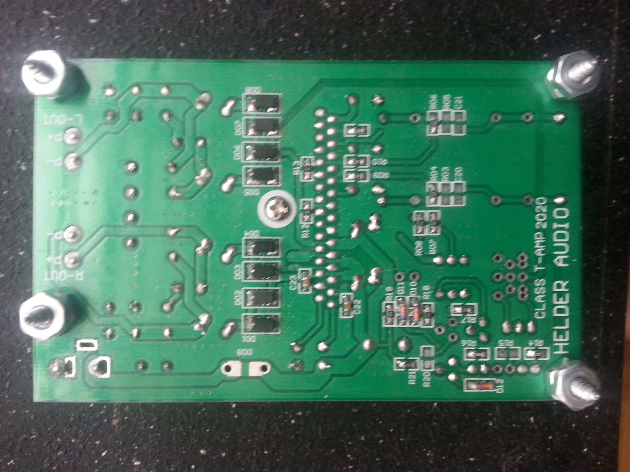

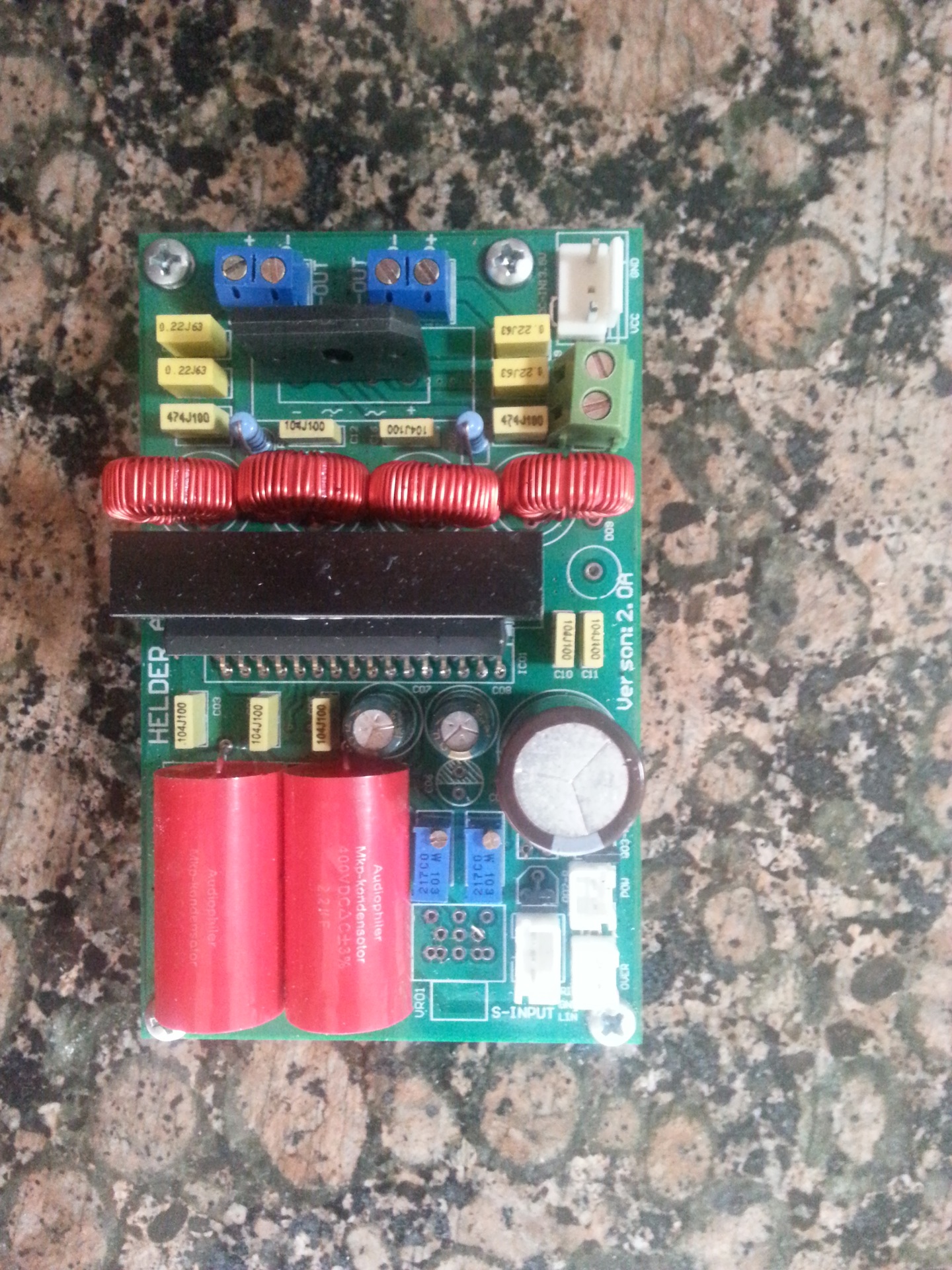

I have a MKIII Tripath TA2020 AMP from Arjen Helder and have not been able to contact him. I would like to swap the feedback resistors to an 82k or 100k ohm resistor for use with my iPhone, but don't know where they are on the board. A friend of mine will be doing the soldering for me, but I wanted to be able to show him exactly which resistors should be replaced. I have attached a pic of the amp. Thanks in advance for the help.

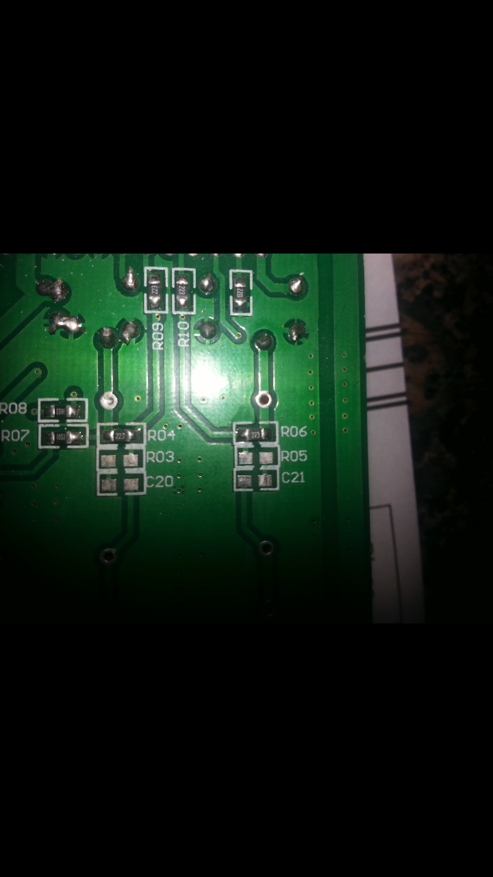

I think I might have found the correct resistor. It looks like most people say to swap the 20k resistor in the R5 and R6 spots to an 82k or 100k. However on this amp there looks to be only one 20k resistor in the R6 spot and nothing in the R5 spot. I do see another 20k resistor in the R9 and R10 spots. I'm just not sure which resistors are the feedbacks and which are the inputs.
