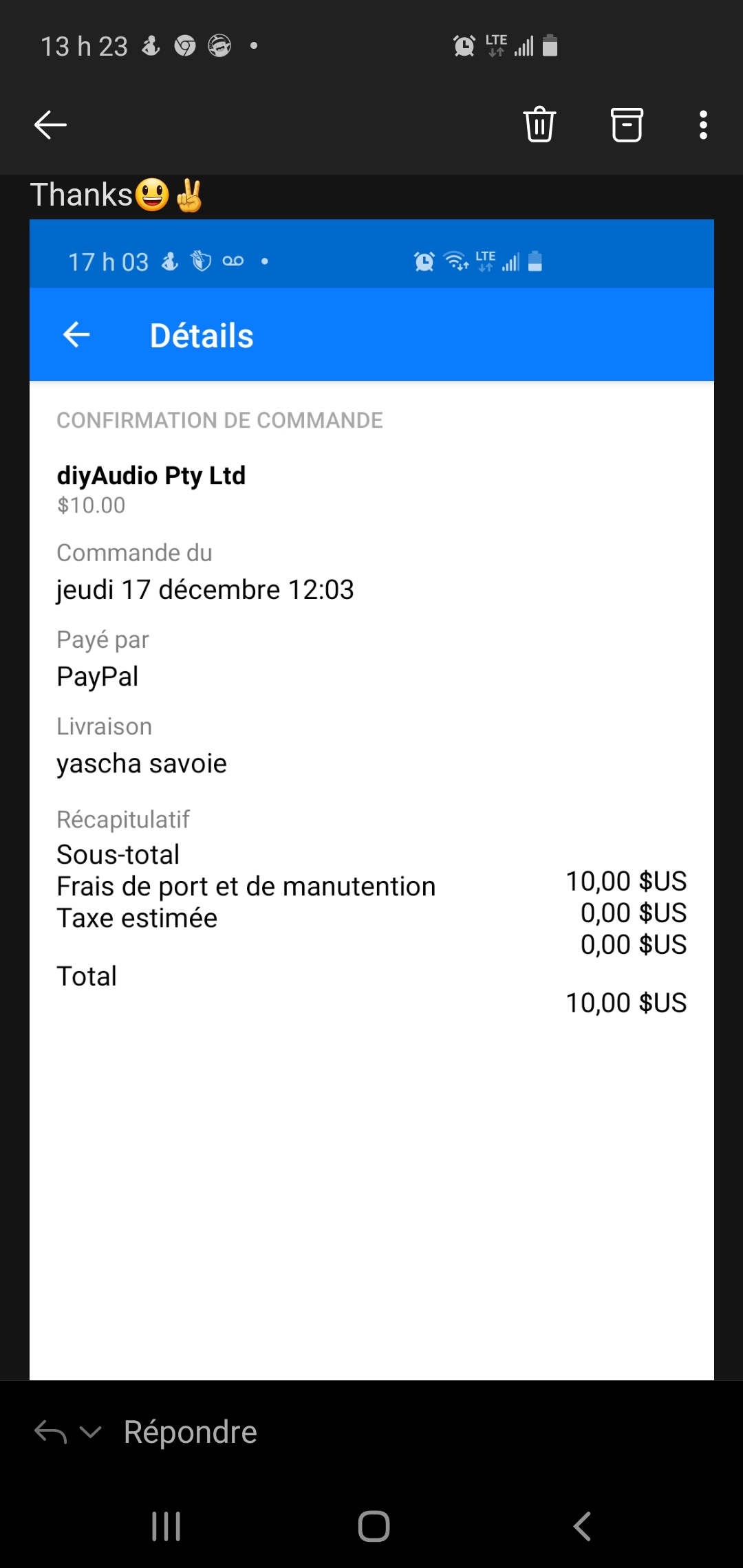

The receipt did not arrive with the email. Thanx for posting it.

Hi, can you give me the exact email to contact you please?
Or try yo sends me again the Joan plan?
I did not reveice any Return, maby you did...but i dont see anything.
Thank you!
Thank you!
