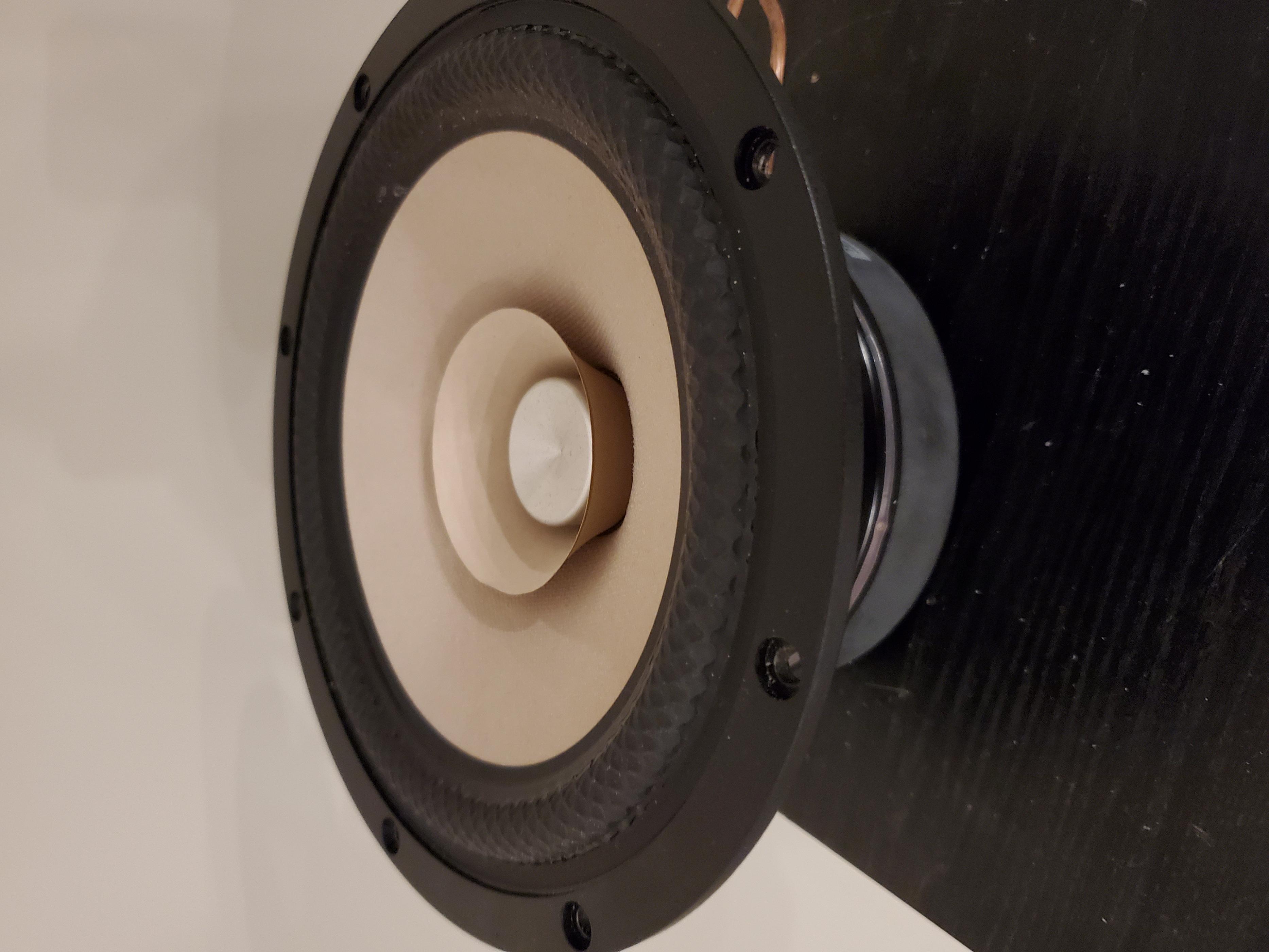

What driver have you posted the picture of? We can get Scott to see if it is suitable. I suspect Joan’s slightly different alignment may not be as flexible wrt drivers as the smaller ones.
