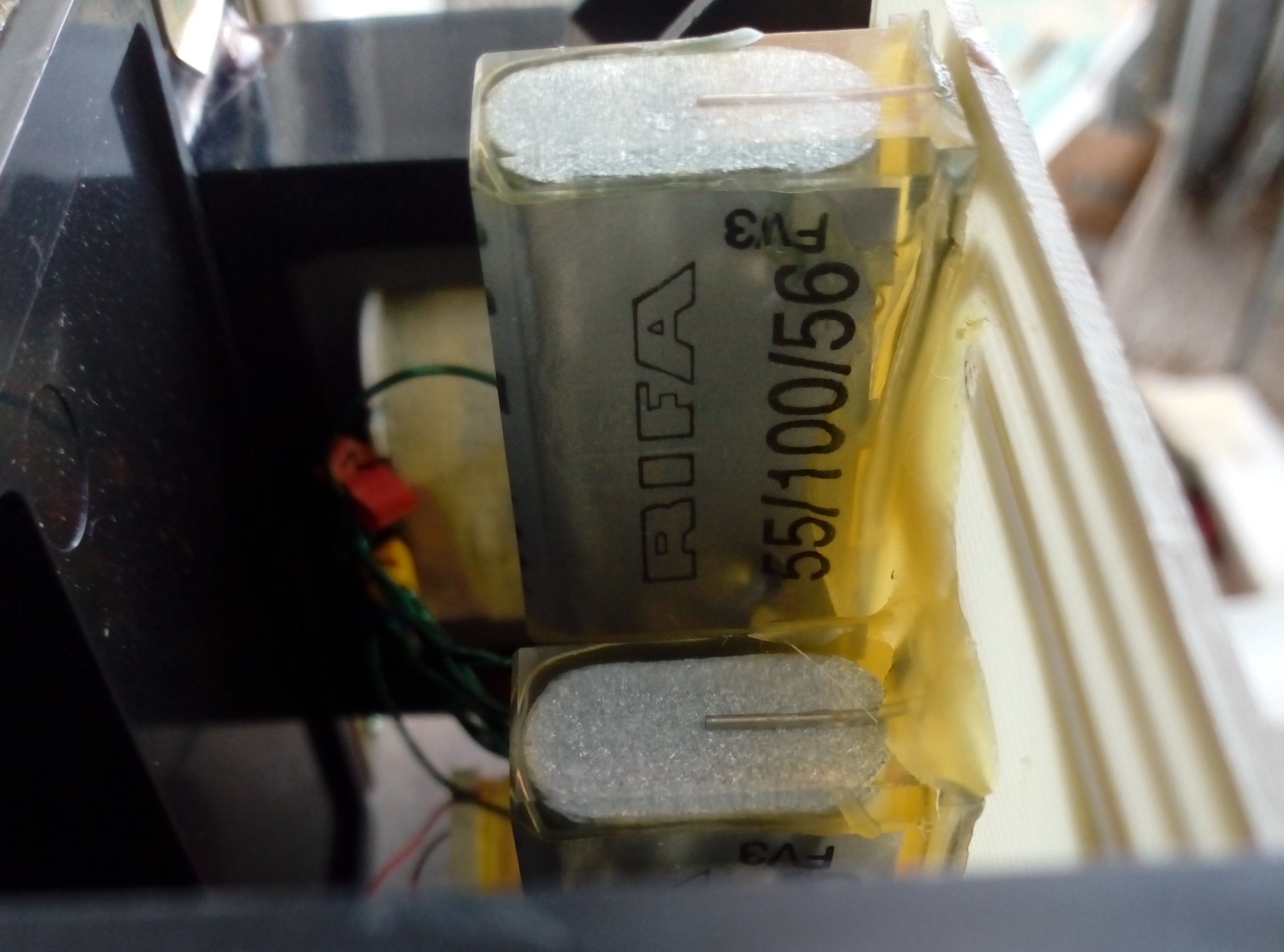

I think that there is no electrolytics in the original crossover. Only film caps. No need for the maintenance except in the case of component failure.

I think that caps factory used in my K2558 are of good quality and dont need upgrade. It's RIFA.
