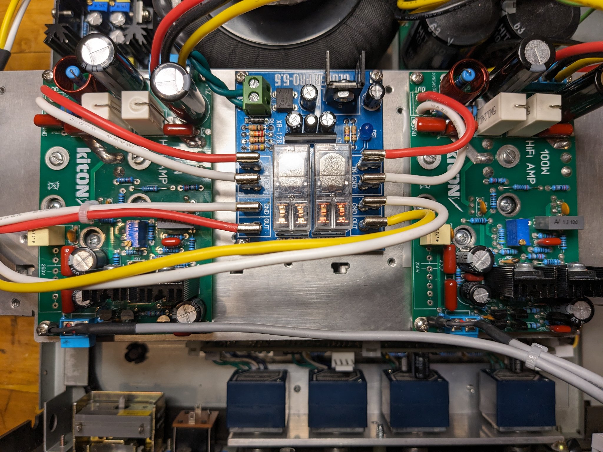

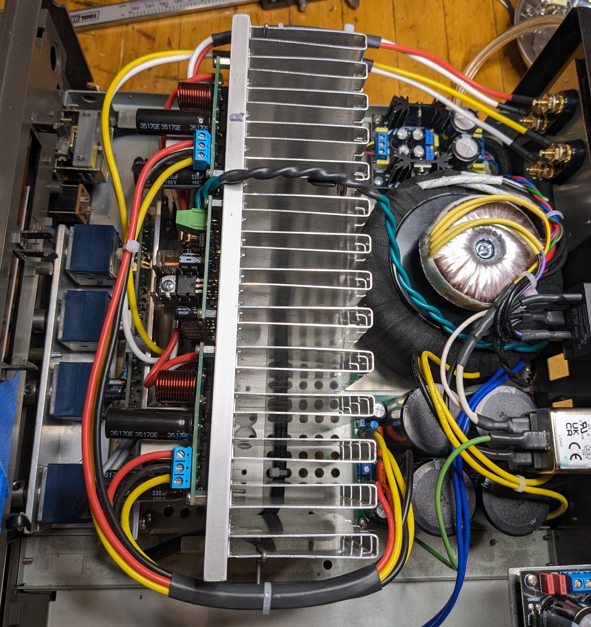

I installed everything. It's a complete retrofit, PS, preamp, amp. Only thing original is the input/tuner board which I haven't gotten to yet.

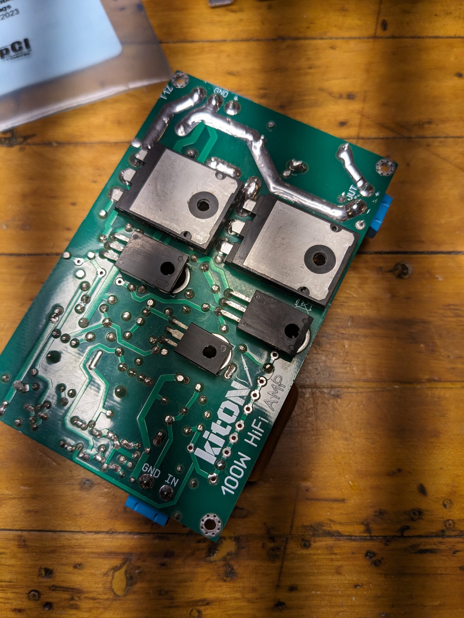

None of the pads under any of the mounting screws provide a ground connection. The preamp is on a separate transformer. I was using a portable DAC for testing so no ground there. Hmmm...
Seems like poor design to not have the input and output grounds connected right on the board. Thinking I'll solder a jumper on the underside.

No, it's a good design to have separate common connections. Very common in fact.

You might be looking at a similar kind of thing. All the grounds on that board have to be connected together for it to work right.
Still......why both of them?? I'd check the voltage between the ground lines before doing anything else. With the power supply turned on, of course.

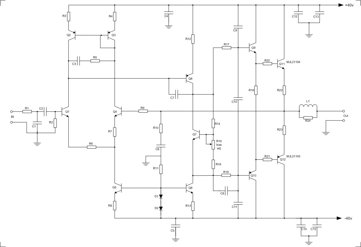

The input and output separate commons?No, it's a good design to have separate common connections.
How would the feedback work?
They are connected at an electrically quiet point. Separating them aims to keep the signal common clean from noise caused by heavy currents. So ou should measure a low impedance between the two. Some tmes up to about 100R resistors are installed between the two points to discourage ground loops. There is no current flow to speak of, or shouldn't be. Therefore no problem It depends on the design.

There's ~1meg between input and output common.

I sent an email to the place I bought them inquiring about the lack of connectivity between the input and output commons. Hopefully I'll get a response.You may be able to find some online info on how to correctly wire up those boards
Pay attention to your speaker returns as well. Normally they go to the common on your main filter caps. The common has a return to the power transformer. Then make a separate common between them where everything else in the world goes. The one to the power transformer has scary large current spikes in it.
I got a response. This is good news and totally explains everything.
"Hi David.
This amplifier uses the "Ground Separation" technique. This helps to greatly reduce noise and hum. The ground for the input signal and the ground for the power supply are separated by a 2.2 Ohm resistor - see attachment.
The downside of "Ground Separation" is that when switching the input signal or speaker or experimenting with the amplifier on, the current through this resistor can be very large and the resistor burns out. You need to change this 2.2 Ohm resistor.
In the future, please switch the signal and speakers only with the amplifier off."

Assuming this also provides a measure of protection so I wouldn't want to replace it with a higher wattage one?
It should never pass any real current - ever. It is a reference for the audio signal only. The easiest way to wipe that out is touch the speaker return wire to the audio "ground". If the amp is off, no problems. If you have that much differential current between your sources and the amplifier, you have very real, very big problems. In that case, this resistor is the "canary in the coal mine". A very good warning.
You can increase the power rating if you feel the need, but make darned sure the part is not inductive. Looks like a 1/4 W or maybe 1/2 W resistor depending on the brand and model.
