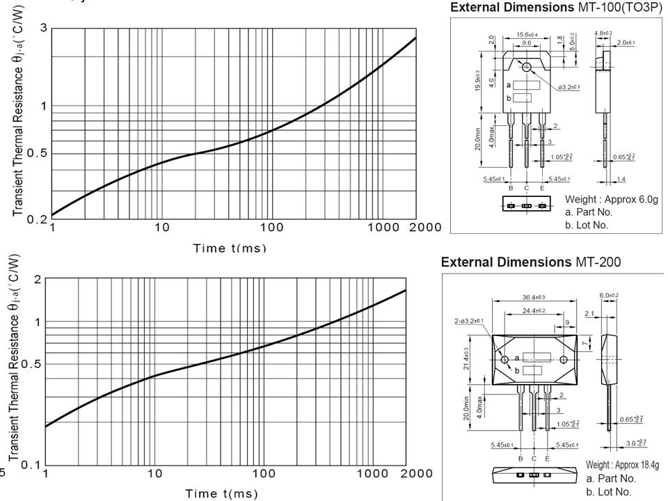

Save the Planet! Go Green! For low Class-A bias with Class-AB Output Stages I favor using ThermalTrak NJL3281D (NPN) and NJL1302D (PNP). The thermal diode really does reduce thermal transient distortion, especially for the first 30 minutes after turn-on.
For high Class-A bias, high power Class-AB amps with many output transistors pairs where fast Vbe thermal transisents do not occur the Sanken NPN 2SA1216 and Sanken PNP 2SC2922 have superior sound and thermals.
