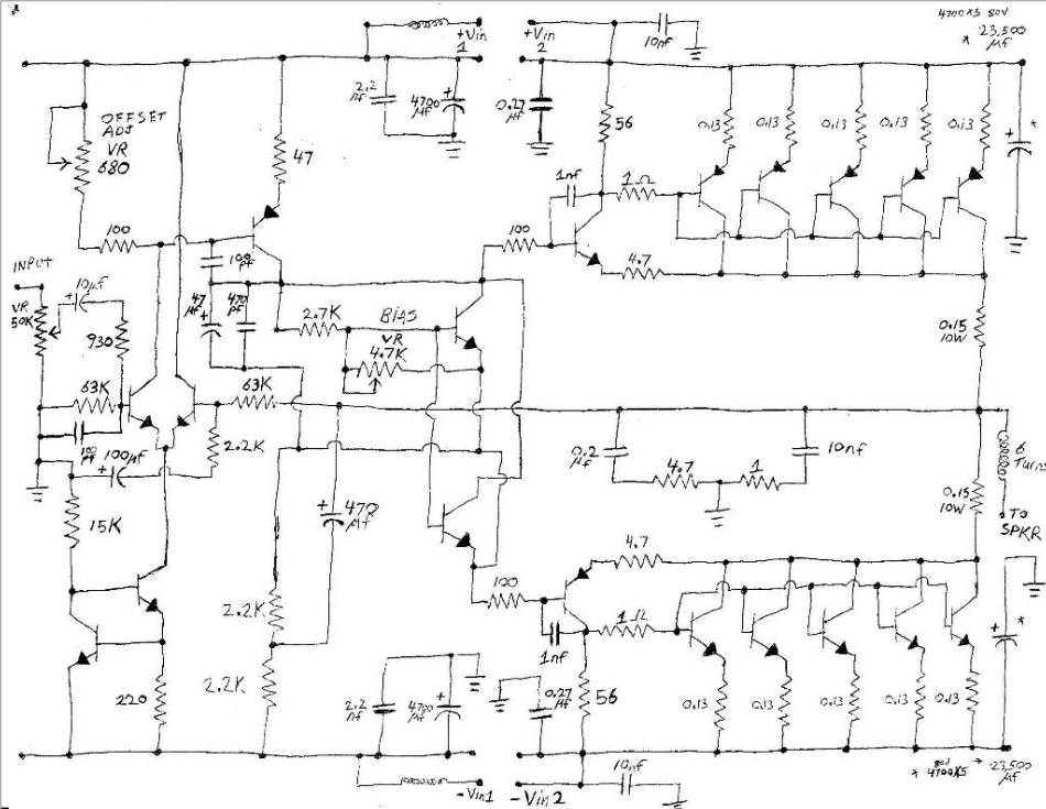

I don't see it being that hard to use the higher gain/ft transistors.
If they oscillate, just put a small cap over the B-C leads of the drivers with a low value base resistor.
This amp I built using 230W MJL4281/4302 is for a subwoofer, but this amp also delivers excellent treble response as well. I went TO-247 types because of their high power handling, ease of mounting, and that because they are so large, they work better with the heatsink.
I also have some 200W MJL21195/96 transistors but I didn't use them because the gain is lower and also have more gain droop than the 4281/4302. Also I used 5 pairs of output transistors (overkill 😀 ) to reduce gain droop and reduce individual transistor temps to that the total heat made is spread better along the heatsink.
If you don't wanna use the 4281, then use another transistor such as the 21196 or comparable flat transistor that can handle the wattage you need.
