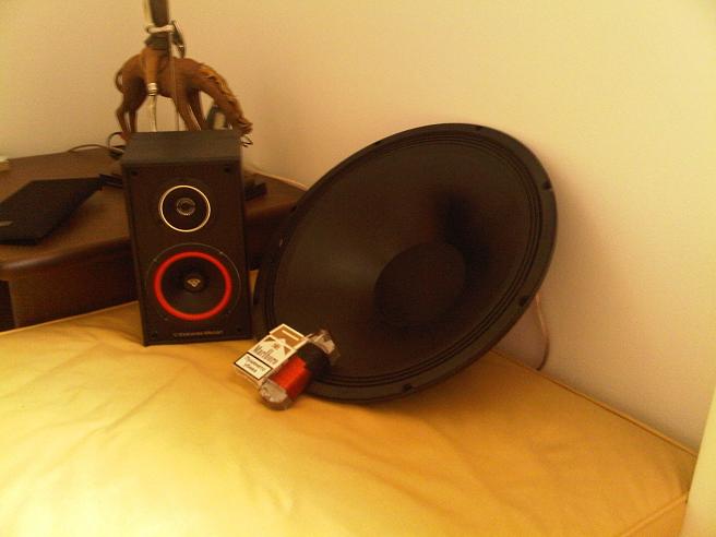

Got it. Now I remember reading somewere that air loads the driver only at low freq. when woofer is "pumping" and not affecting higher freq's.
Hello T101,
are you speaking about AE speakers, but have you tested the Goldwood GW1858 that you have bought.
Can you tell me more about your impression and your system?

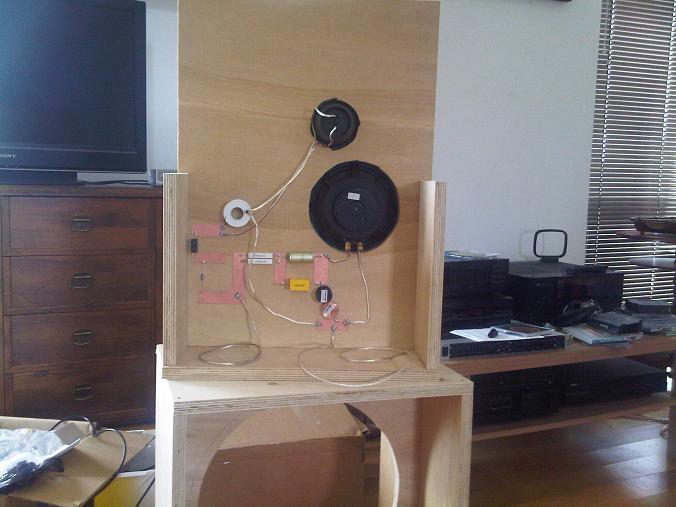

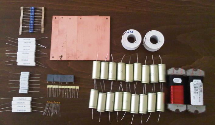

Guys, here they are! I went for 7X22 mf Russian MKP - metalized polipropilene for the 150 mf capacitor in the crossover...
I got my self some smaller capacitors to bypass all bigger capacitor in all crossovers!
Wish luck to me - from tomorrow the build begins! 😀

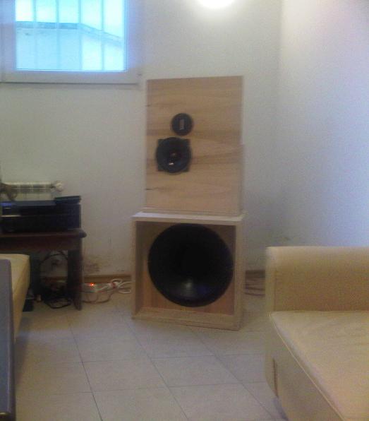

Here They Are!!!
Hi Guys!
Mine are ready for a whole week now! 😀
I used them to power my birthday party 😀 the bass was unbelievable!!! It was as if we were in a disco club!!! And this was achieved while driven with only a 75 watt RX-497 Yamaha!
With my BIG Yamaha MX-1000 (which unfortunately stays at our summer house) the speakers happily received 150-180 watts and were asking for more! 😀
With the smaller amp they were beginning to be unhappy somewhere around the middle of the travel of the volume control - this was expected thou...

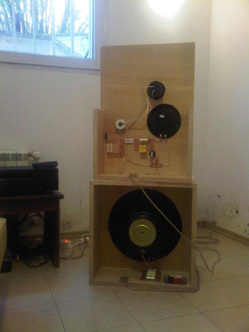

Now about the sound!
Well, I think that concerning the bass they act like a monitor speaker... they only play bass when it is present in the recording... - I point and underline that in order to make distinction from horns and bass reflex and especially the bass reflex, which in some cases adds low sounds that do not exist in the record or plays them allot louder than original!
And when there is bass it is tremendous! Accurate as it can be! I invited some musicians to listen to the speakers and they said that this is the most accurate bass reproduction that they have ever heard!!! Double Bass, Drums and etc. - you can tell what is the texture of the strings of the bass guitar or the Double Bass... you can tell whether the drum is with leather or plastic membrane and how stretched is it!!!
The top part... well I have a bit of a struggle with attenuation and another bit of headache with the crossovers... but at least I gave the crossovers exellent design 😀
The OB part of the speaker makes very good 3D effect... as a matter of fact the best I have ever heard! And that is not all! Due to the almost 360o dispersion the sweet point is very wide - I mean it is so wide that even if you are standing in front of the one speaker, you still have stereo. As a matter of fact you can have the stereo effect in many different places - for instance outside the base of the speakers and at distance greater than the distance between the speakers...
I didn't write before now, because I still can't find words to thank Mr. Martin J. King! Because I am one ordinary DIY man, not much time, not much knowledge in the audio or acoustics... He made his articles and research in such way, that there was no moment that I didn't knew what to do! And the edge software is just marvelous! Thank You Martin!!!
Another reason why Mr. King is so special is that many times we (particularly I) have witnessed how someone gives delusive advices on the WWW. I personally have spent over 1000 euro - this is 1500-1600 USD on something completely unusable! I did that following strictly the advices in Bulgarian DIY forum! And more over handling the crossover part to a specialist known in that forum and paying him for that...
And now a guy from the opposite part of the world puts some very hard work on giving me and any other enthusiast for free something really marvelous and incomparable with any other product.
How to thank such person!?!
And I spent little over 700USD for all of it! For that money one can't even put his hands on a pair of Tannoy Sensys DC-2!
And I think nf one can get even near proximity of the sound of the MJK's H-frame + OB's for under 5.000 USD!
Thank You Martin!

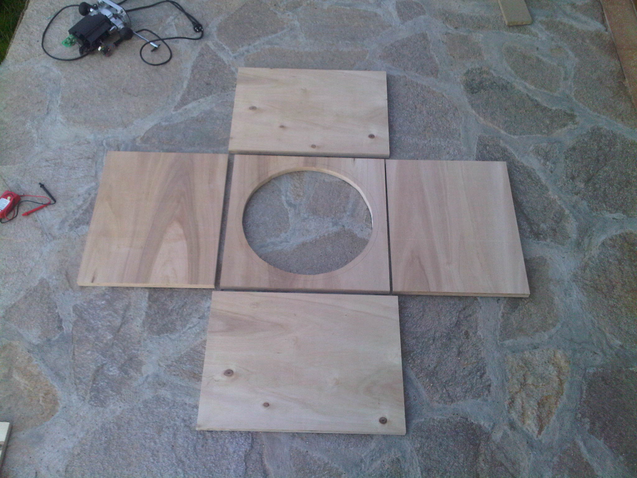

p.s.1. The dimensions of the OB are 700X510 mm (27.5X20 in), the material for all the construction is 21mm thick (more than 3/4 in) and is Poplar plywood. I mistakenly made the internal dimensions 51X51 cm 🙂 (20.0787 in) - I found that after the first speaker was finished, but made the second the same... and there are no negative consequences on the performance... not that I know how they act with the 28mm (little over 1 inch) smaller internal dimensions... The wings of the OB are 150X350mm.
The overall height is 1280 mm (50,393 in) and they are really big speakers... Not that they are mine, but they are beautifull 🙂))

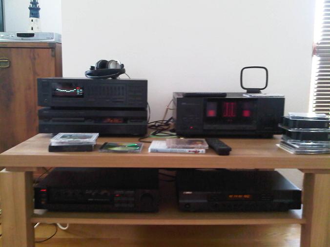

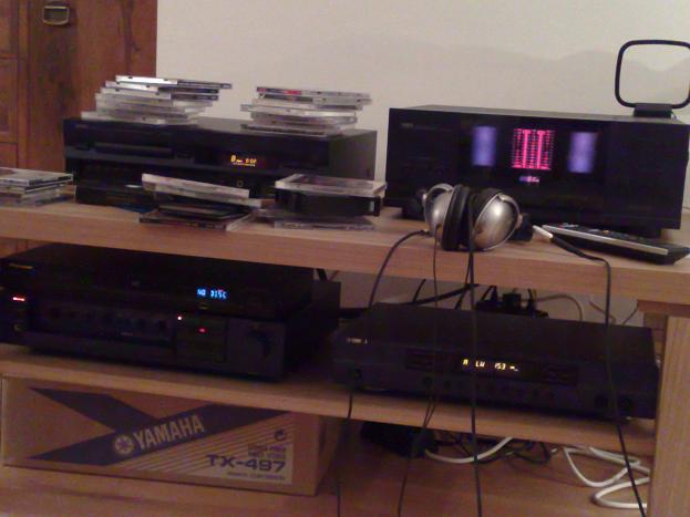

p.s.2. underneath you will find a picture of my pride 🙂 - all the top Yamaha's I could put my hands on... all in perfect condition: MX-1000 amp, C-85 preamp, CDX-993 - 20 bit DAC - player, EQ-1100 - eq 🙂 and last but not least TX-497 tuner - not on the level of the others, but remote controllable and pretty decent sound.

Underneath it is Goldwood GW-1858 - no surprize 🙂
For midrange I use a Bulgarian made full range with Russian cast chassis unknown membrane, custom 2 layer voice coil on paper former... - very good tone and detail, but originally constructed for TL acoustic enclosure and with too much treatment of the membrane with impregnating covering... everything is great except that the solo drum is too quiet... voices and guitars on the same frequencies are with normal level and very clear, but the solo drum (the one on the most left besides the pedal fuse) is hardly audible.

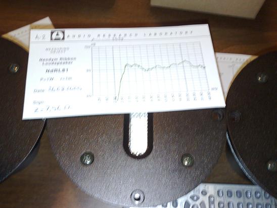

For high frequencies I use ribbon drivers called NdRL81-II - they are made by the Bulgarian professor Ivan Vulchev - he rules! 😀 and they are exellent!
As this was a budget low cost project for me and my trainee at our Law office we used only low cost components such as the ribbon drivers for 35 Euro each and 30 Euro second hand for the full range drivers + 5 Euro for the phase plugs 😀 . The crossover components cost 50 Euro for all except the Erse inductances, Including 18 pieces of 22 mf Russian capacitors with metalized polypropylene film made in the far 1989 year in the former USSR 😀
All the wood used costs 75 Euro with the cutting and we have 3/4 of the second sheet left to spare, the glue and the screws cost 8 Euro and 2XGW1858 with shipping together with the Erse Inductances and customs taxes costs 440 USD (286 Euro)
Total cost is 560 Euro - 770 USD 🙂
And we proved that if the DIY man is properly advised he is able himself to achieve really great results at a totally low cost!
