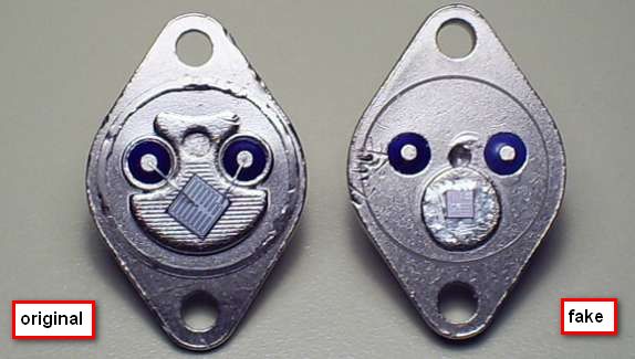

It may also be that you have poor copies (fake) MJ15003's. Often fake devices are smaller than they should be and may suffer greater heating or degradation as a result.

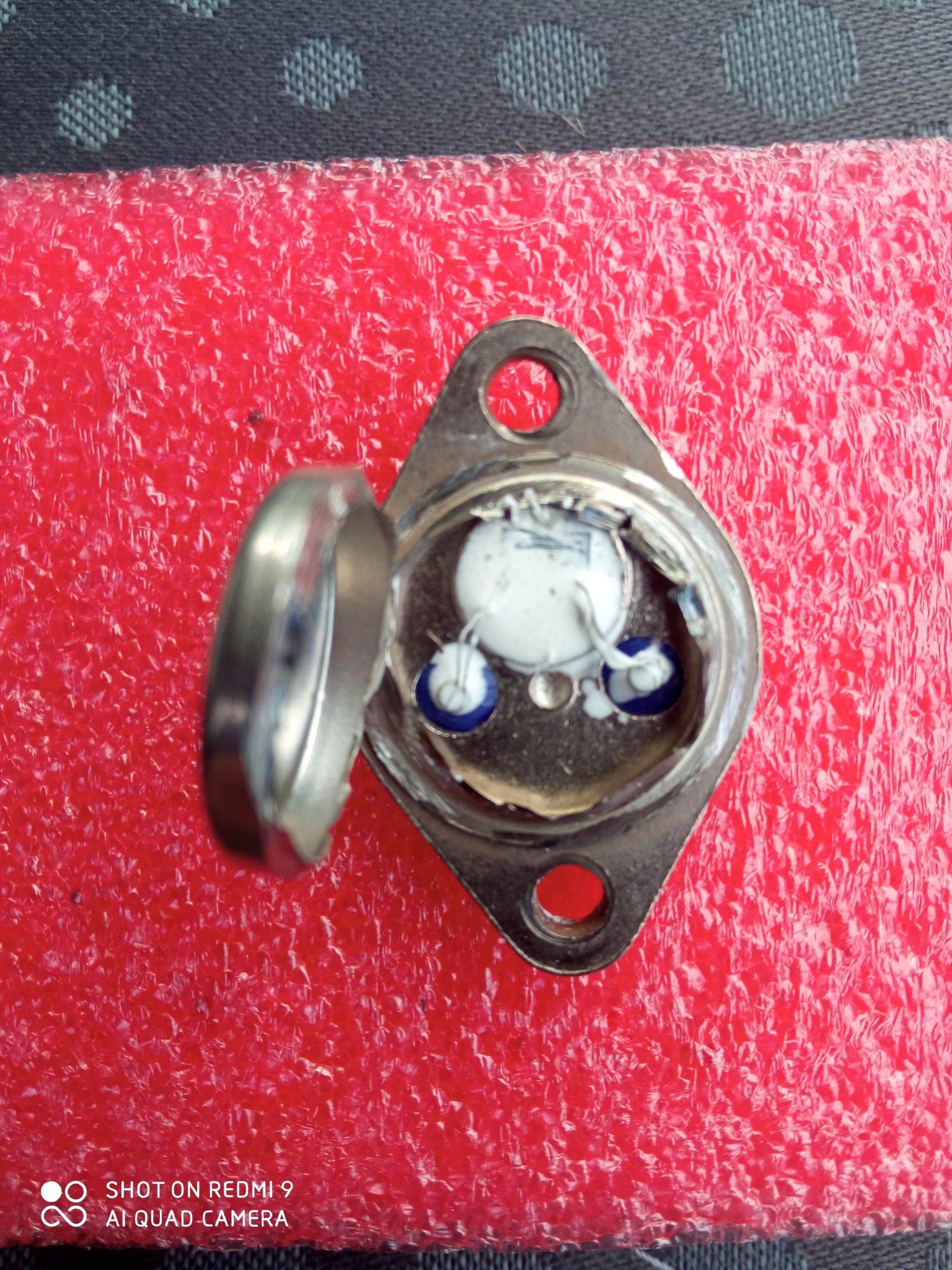

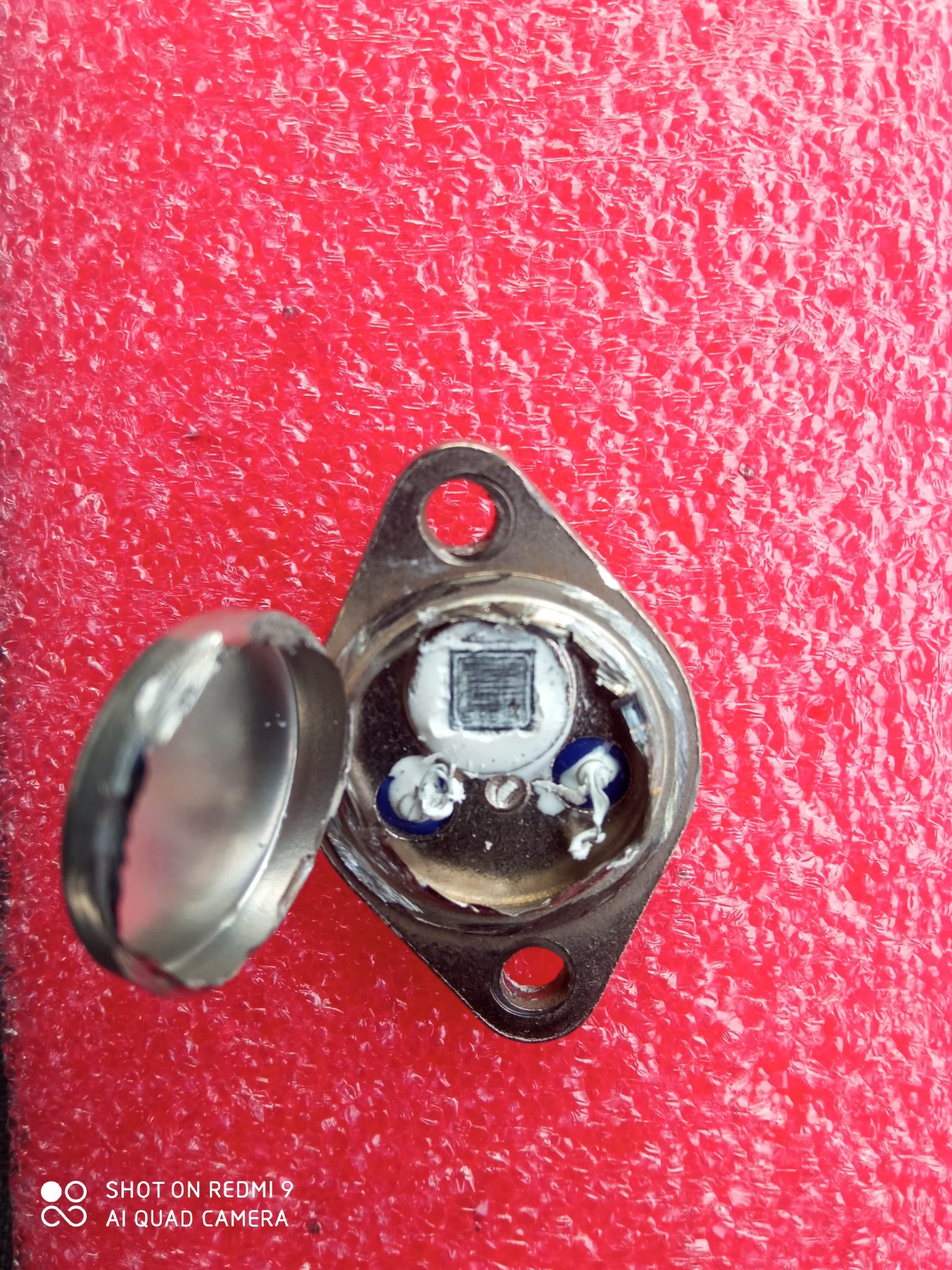

Most likely the transistors are fake. Open one and show everyone the crystal. Similarly, this
Reactions: huggygood
