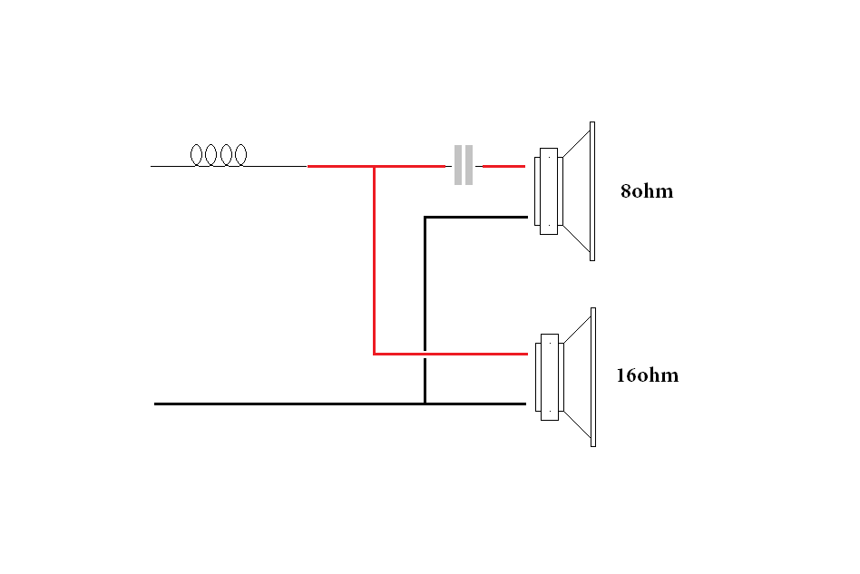

Tinitus,
The problem is, you didn't actually ask a question.
Would you like to add a sentence that ends in a question mark? And given that you are a moderator, it seems unlikely that you don't understand the diagram, though I could be wrong on that. Still, I'll give it my best shot.
Given that you have a coil in series, we must assume that the two drivers are both woofers.
The COIL in the diagram will see the combined impedance of the speakers.
Rt = (R1 x R2) / (R1 + R2) = (8x16) / (8+16) = 128 / 24 = 5.3333 ohms
That is the impedance you must use to determine the value of the Coil relative to your selected crossover frequency.
EDITED: Revised for a Math Error. Hopefully, I got it right the second time around.
Next because the two drivers do not have the same impedance and they are in parallel, they will get the same signal voltage but will not consume equal amounts of power.
Let's apply 10v to make the math easier.
If we designate the 8 ohms as R1 and the 16 ohm are R2, here is the power applied to each speaker.
Pr1 = E²/R = 10²/8 = 100/8 = 12.5 watts
Pr2 = E²/R = 10²/16 = 100/16 = 6.25 watts
So twice the power is consumed by the 8 ohm driver.
We would then have to look at the Sensitivity specification of the speakers to determine the output of each, in order to determine if one speaker is going to be louder than the other. If the 16 ohm is rated at 90dB and the 8 ohm is 87dB, then they will be reasonable balanced. Assuming they both have the same cone area.
In my view, there is no right or wrong, there are only the goals and objectives of the design. Under some circumstance, this configuration might further the design, under other circumstances, this configuration might be detrimental to the overall design goals.
Is that what you had in mind for the question you never actually asked? 🙂 🙂
so you say both drivers will have the same roll off slope, only with different SPL
