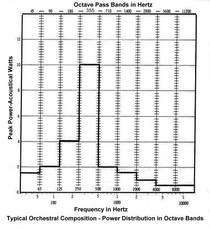

But Power Distribution is not uniform across the spectrum. For Full Orchestral music, the peak power band is in the range of 250hz to 500hz. Above 500hz the power demands drop quickly. Below 250, they drop, just not as quickly but it still drops pretty quickly.
If the range 250hz to 500hz is consuming 10watts, then the range of 125hz to 250hz is only consuming 4 watts. Conversely, the range of 500hz to 1000hz is consuming a modest 2 watts.
If you are crossing Bass-to-Mid at 300hz, then your Mid drivers are going to need most power handling and excursion range. If you cross Bass-to-Mid above 500hz, then the Mids need not handle quite as much power nor will they need quite as much excursion capability.
So, as an example, if you cross Bass-to-Mid at 800hz and you start with a 100w woofer, then theoretically you only need a 20w mid-range and at 10 watt tweeter. Though I think in practice that would be cutting it to the thinnest of razors edge in terms of power handling. But it would not be unrealistic to have a 100w woofer, a 50w mid-range and a 30w tweeter and feel comfortable calling this a 100w speaker system.
Handy Power Distribution Chart -
If the various drivers are initially rated the same using the same method and standard, and if they are flat in their working range within a given design, then the output level will likely be the same.

Wattage is a big misnomer in speaker building and is almost a worthless parameter in terms of designing. In terms of relating total output of a completed design with its sensitivity and wattage input is about the only place of usage, aside from knowing when the driver will go into thermal meltdown.
I'm not sure misnomer is the right word, but I think we still understand what you are saying in context.
Wattage is not worthless, but the key is to select components that result in a complete speaker system that has a predictable Power Handling capacity that is within the range you need.
This removes cabinet issues, room interaction, impedance differences, and input differences to the point of being nill. IF AND ONLY IF the drivers have a flat frequency response, will they then put out the same level of output consistently to be rated as the same.

The handy power distribution chart is good at helping to size the heatsink of a narrow band amplifier.
The chart is no good at predicting the peak SPL in any frequency band.
The Chart is a broad average, no it can't predict the power distribution of any one given musical work. I suspect the power distribution between "Bass I Love You" and John Denver's "Rocky Mountain High" are very different.
But the tests were done with full Orchestral music, which has pretty substantial dynamics and wide frequency range, and it servers as a fair average of power distribution across a wide spectrum of music.
The chart can help you have an understanding of the general power distribution of real music, but no it can't predict the power distribution of a single give musical composition. Nor can it predict the peak SPL of a given work of music. But then, it is not intended to do that. It merely gives the power distribution on average of Full Orchestra Music.
