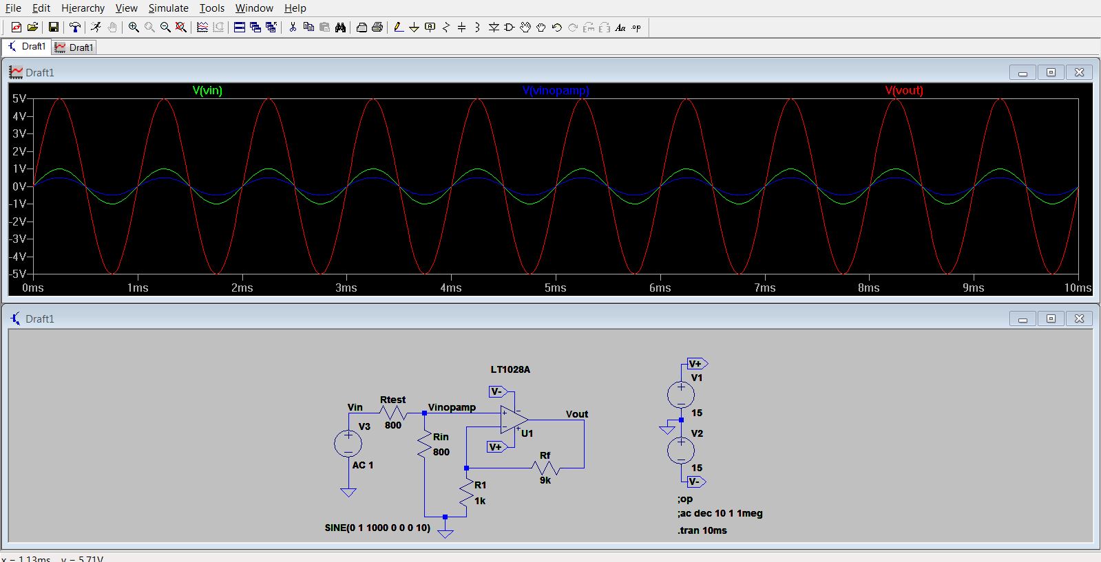

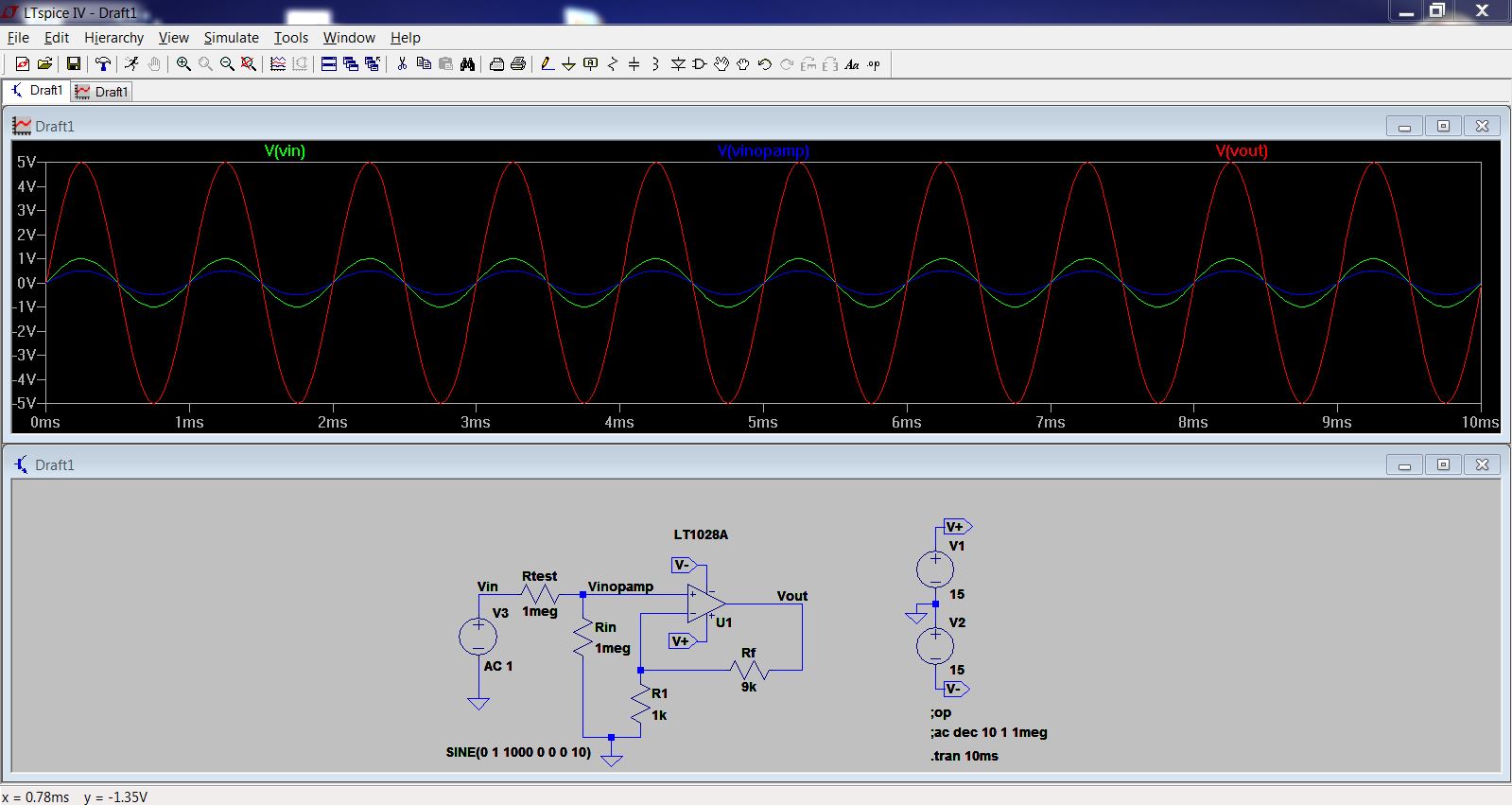

Here is how you can check the input impedance on any amp either for real or in simulation.
Can you see how it works ? and what Rtest does ? Look at the relationship of the voltages. Can you see how it "proves" the input impedance is the same as Rin ? The last picture shows the scale better of "Vin" and "Vinopamp"

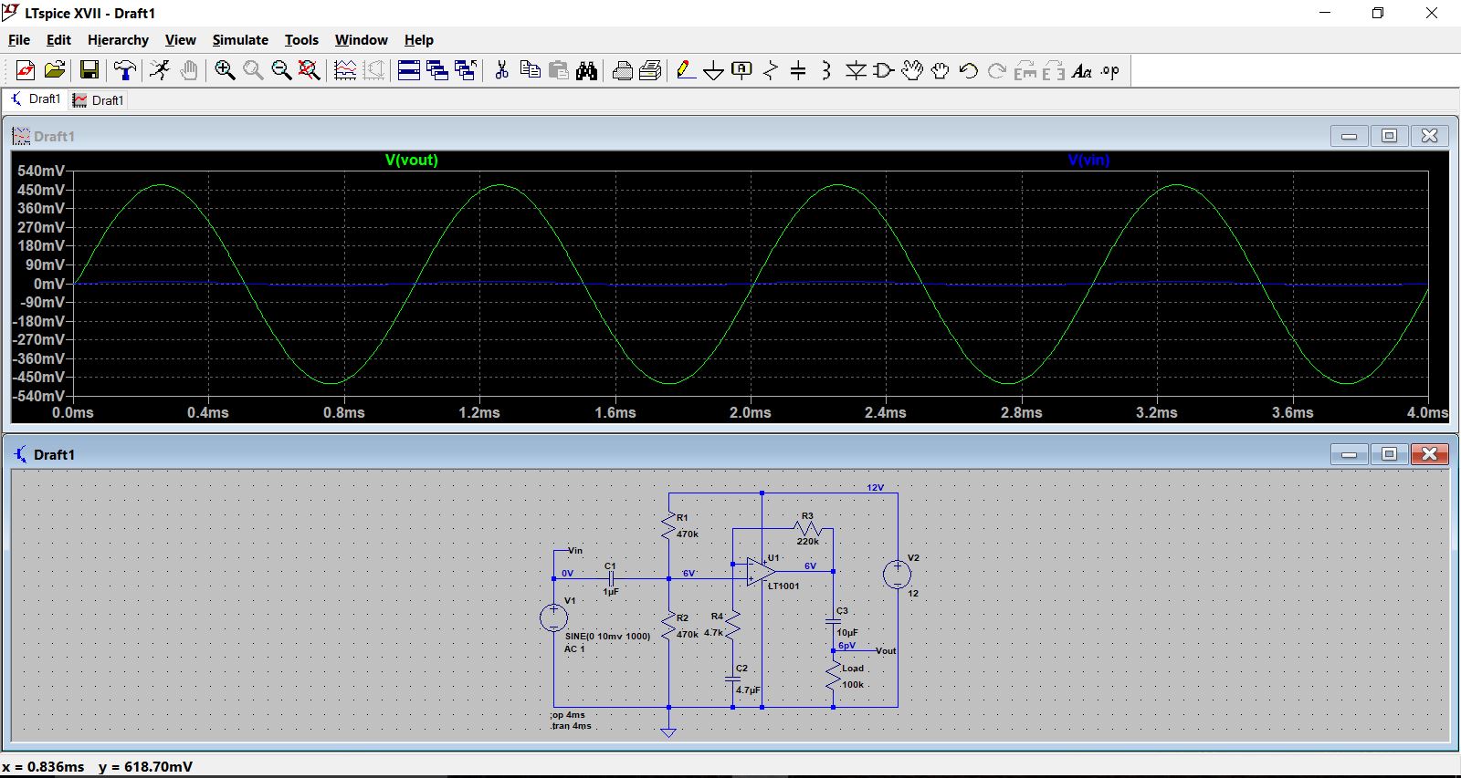

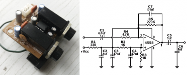

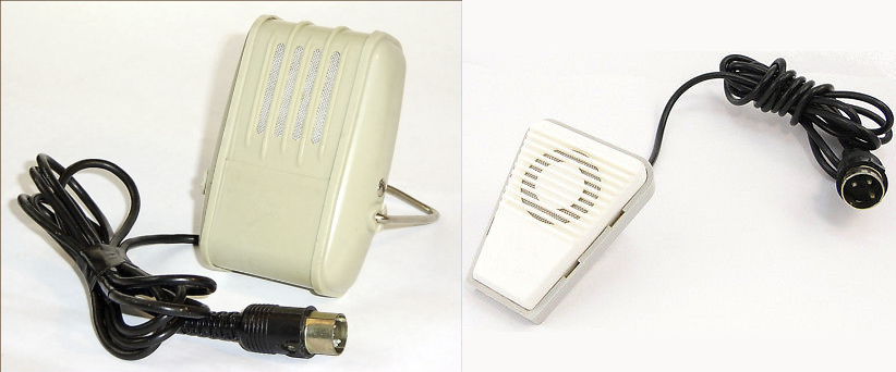

Hello!
Recently I found 2 vintage soviet microphones октава мд-47 and мд-201. I thought they would do great for vintage type voice recording. When I was testing them I noticed that their output is extremely low. I added a preamp from an old DVD player but that didn't help much. Could some modifications to the circuit help rising the signal?
Thanks in advance!
Thanks in advance!
The problem is that the opamp is configured in inverting mode and that means the input impedance is extremely low at 4.7k (set by R4). That low impedance is killing the voltage the mic produces.
You could reconfigure it if you are careful. I don't think you need the cap across the 220k, or at least nowhere near that big, and also definitely not the 1nF at the output.

Yes, 12 volts is enough for that opamp and the 470k's bias the opamp to approximately half supply voltage. The gain is equal to the ratio of the feedback resistors plus 1 and so is (220,000/4700)+1 which is 48. If that is a bit high then reduce the 220k to suit.
Yes, its correct. A quick check of the voltages on the opamp pins should go a long way to confirming its OK.
The + input (non inverting input) should be at approx. half supply voltage as dictated by the two 470k resistors. The output should also be at this same voltage, as will the inverting input.
Yes, there was the problem, the 470k resistor wasn't grounded. Thank you very much. Works great.
