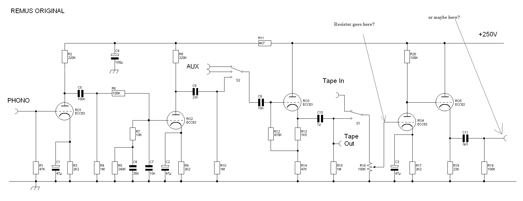

Having just (pretty much) finished refurbishing my amp, I'm looking to start my next project, which is building an audiophile-grade two-channel switchable MM phono and line input mixer.
Having looked through the web and a few "sound practices" magazines, I have decided to use Jan Lodström's REMUS design, largely as it seems fairly straightforward to build. Over the next few weeks I will be asking a few questions which I hope you can help me with.
First question is, do you think this is a good design for what I want to do? Keep in mind that I couldn't care less about built-in EQ. In fact, I am keen to not have any, in part because I want to keep the sound as "natural" as possible when I listen and mix at home and in part also because I intend to build by-passable send-receives for each channel (or for the whole thing - have not decided yet) and use an outboard isolator if and when I DJ at parties or when I record a mix (the only two times I am really interested in using EQ).
Second question is more technical - where would you actually add the "summing" part in the design. After asking people in the forum, I was advised to "sum" the two signals by using two resistors. The question is, do I build two pre-amps and add the resistors at the end, or do I build two of the section up to the potentiometer and then hook them up to one final stage with resistors? If this sounds confusing, I have attached a schematic of the amp with some notes, which should make my question clearer. I would also appreciate some advice on how to decide what the right resistor value to use is.
