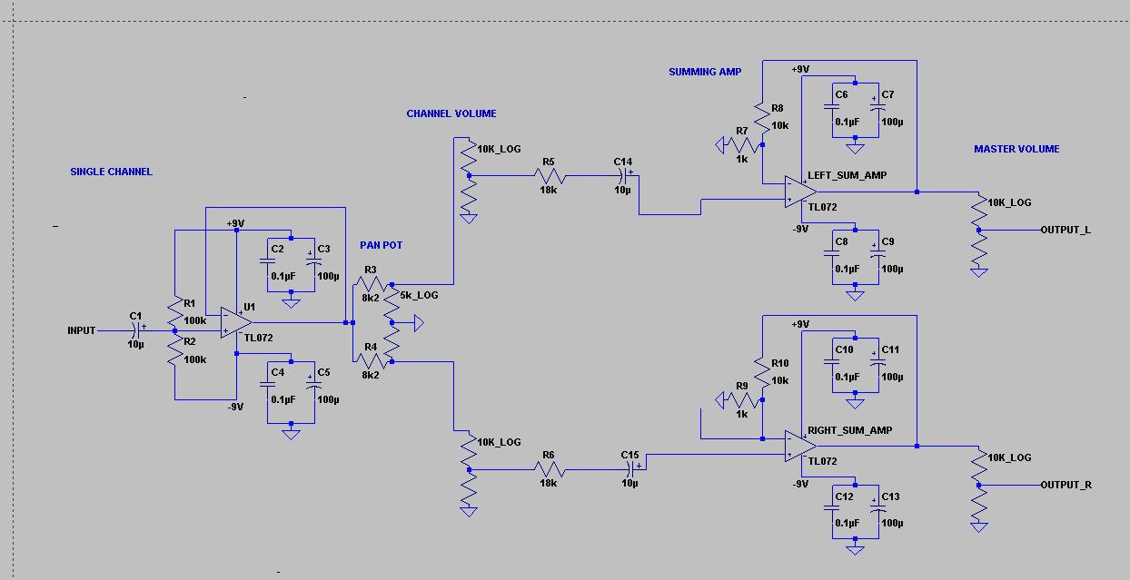

There is an issue with that design. There is no DC bias for the op-amp non-inverting input. He may get away with it by using a FET input op-amp, but it's going to have poor RF rejection and possibly suffer all sorts of funny symptoms.
Yeah, ritchie's right about that design, there's nothing to set the bias on the opamps. Easy to fix, but indicative of the kind of issues you're likely to encounter. You'd need a couple of large value identical resistors (100k?) from the + opamp inputs after the 10uF caps to both supply rails.

Ok, so I had a go at drawing this thing up... LTSpice didn't have a pot symbol, so I just put two resistors together to make one.
Not sure if I got it right, but I basically just put the two schematics together.
But I am wondering, should the channel volume come before the pan pot? If it is after I guess I'm going to need a dual-gang pot to avoid having to use two pots.
You think this thing will work?
