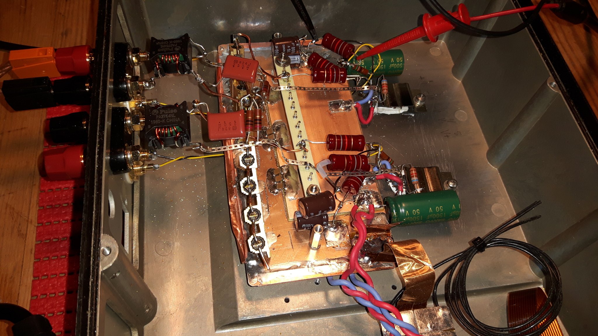

This worked out pretty well. Done over the weekend, using some Cu print boards as GND, V+, and V- rails. The GND plane is good for freely placing components without worrying about return paths. Or put another way, ensuring lowest possible inductance in the signal loops.
Having built enough point to point tube amps, I figure no need for circuit board in such a simple circuit as this. I am too lazy to spend days designing the layout and having to wait for the prints to arrive...
I only had a transformer providing +-15V, so the power is not as much as what theses chips are good for. But next to my 4W tube amp, it'll just do.

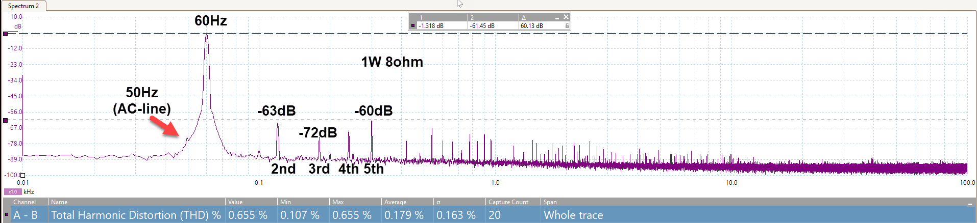

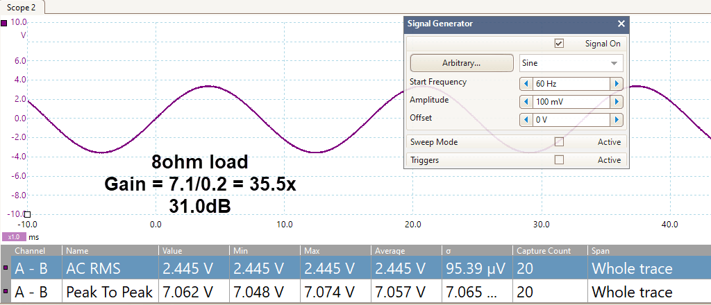

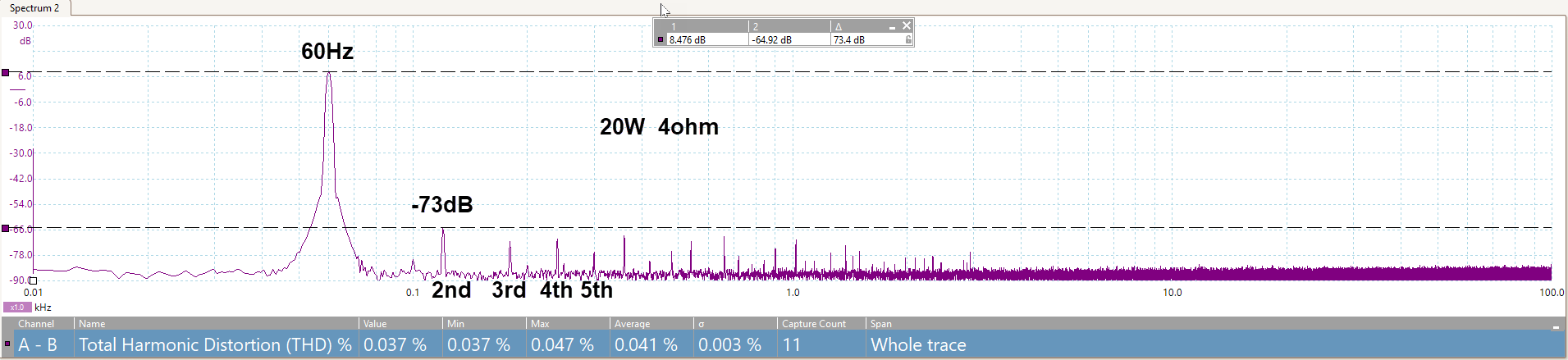

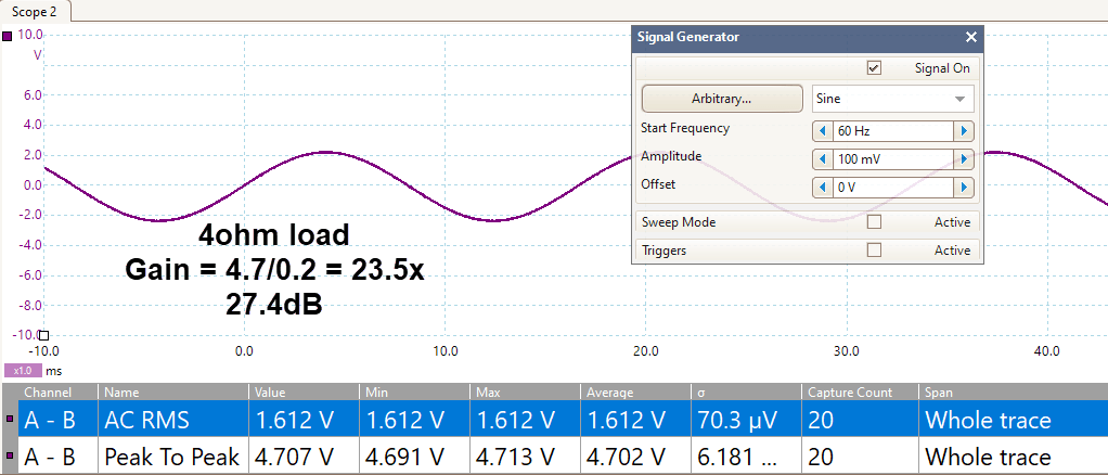

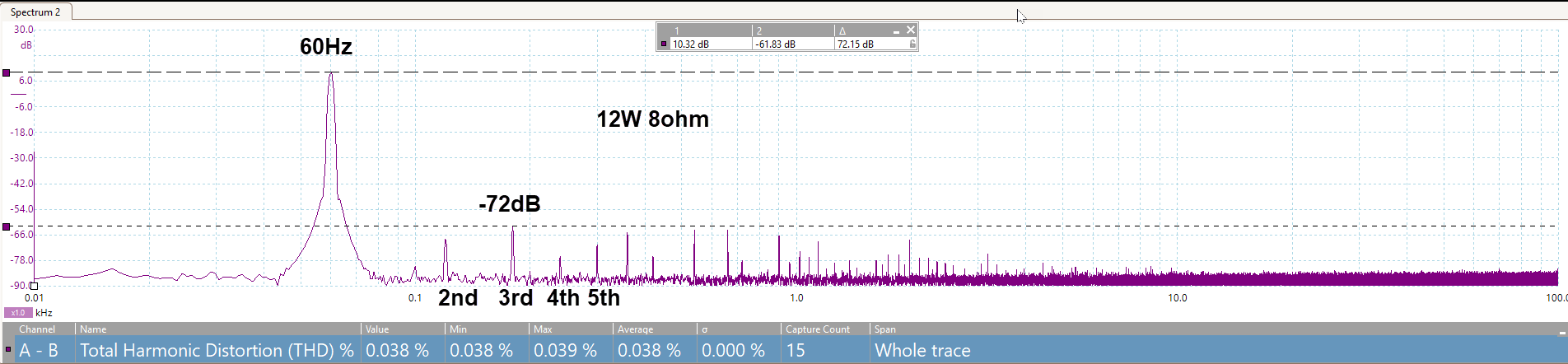

Some measurements.
Edit: Note the lower perceived distortions as the power is increased. As if at 1W, the artifacts of SS are playing a relative bigger part in the mix. The best performance is just before clipping, and 4ohm load is 'better' than 8ohm.
Exact opposite a tube amp characteristic.

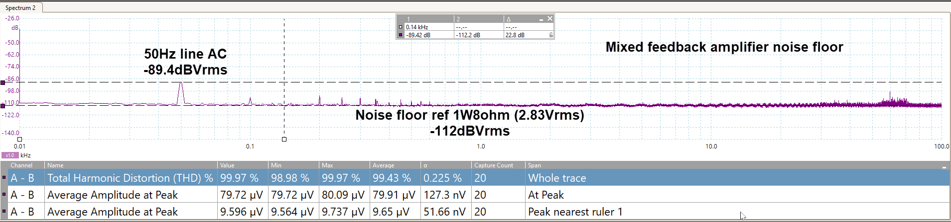

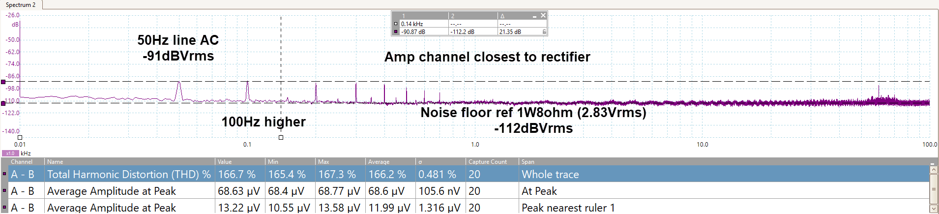

The noise floor is interesting, the channel nearest the rectifier having a tad more 100Hz...
Note, these are very low levels. There is a slight hiss placing ear into speaker.
