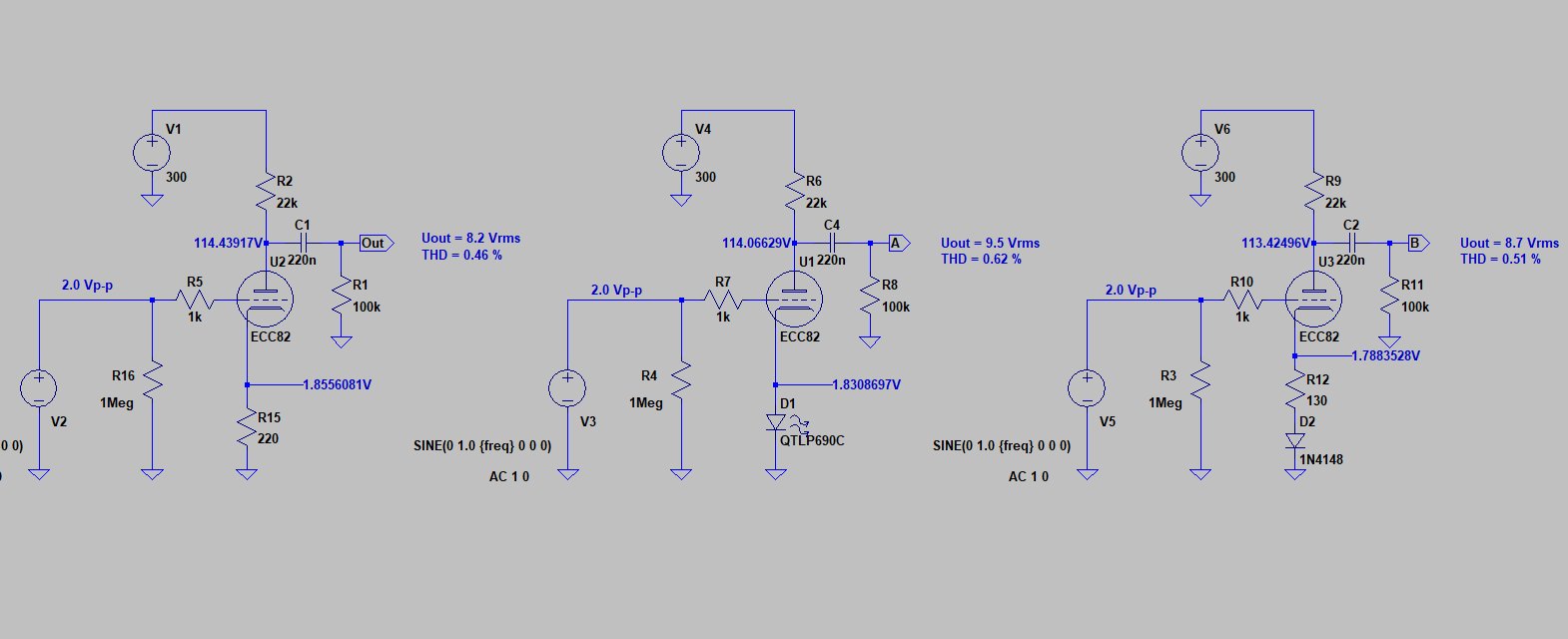

Has anyone had good experience with mixed kinds of cathode bias? I'm thinking here of combining a resistor and a LED or SIC diode or similar. in my case it would be for an input stage. The goal would be to eliminate the cathode bypass capacitor by enabling the use of a smaller resistor like 100 ohms or even less if possible. An example is shown with a SIC diode. Ale discusses SIC diode bias on his Bartola Valves website.
I have tried pure SIC diode bias a few times and in the end preferred a resistor, but combining the two might give good results. I'll set up a comparison when I have time.
One question - does it matter if the SIC diode is above or below the resistor or is there no difference?

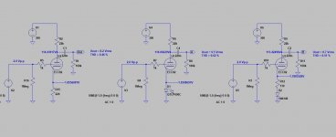

I simulated ECC82 with un-bypassed cathode resistor, fixed bias with yellow LED and mixed bias with silicon diode/resistor.
Input signal is 2 Vp-p, output level and THD is printed at the output of each circuit.
hello Andy - I don't think it's a good idea. If you want a small amount of unbypassed cathode resistance, Filament Bias does it very well, and is certainly better than using diodes IME.
You can also mix grid bias with a small unbypassed cathode resistor: this works very well for DHTs that have big bias voltages (10Y, 300B, PX25...). The small unbypassed cathode resistor gives just a little degenerative feedback, which might be just what you need.
The input stage i was considering here is indirectly heated, not a DHT for which I'd use filament bias. I think that's what Rod was assuming. The ECC82 simulation is spot on - I presently use a 220R cathode resistor on an indirectly heated driver tube with a big amorphous plate choke. But for other cheaper builds I might use a resistor load or a smaller plate choke. However, 220R is a typical value and I was looking for ways of reducing this.
I agree with Cagomat - I've always preferred a resistor to any kind of sand in the cathode. I'm just wondering if a single diode would affect the sound if used with a resistor. I'll rig something up and see if I can hear a difference. I'll start with the SIC diode and then try an LED.
The SIC diodes I have are C3D02060F which produce about 0.86v each.

I doubt a diode will be better than a cap.
Some amps rely on cathode resistor to setup feedback and gain. You may not want to change out that resistor.
If you are designing from the scratch, put the resistor in the bottom, if you do need one. Thus, you have the option to hook up global feedback to the junction of the resistor and the diode.

Well, I listened to my input stage in cathode bias with an unbypassed 220R resistor first. Then swapped in a SIC diode with 110R resistor. All this with a 136H NP amorphous plate choke and FT-2 teflon coupling caps.
Unbypassed 220R resistor was smooth and natural.
110R resistor plus SIC diode was a little less natural, not quite as smooth. Plus point was it had a little more definition in the sound. This at the expense of sounding a bit more artificial and slightly sharper.
I'm on the fence here - the extra definition and focus was potentially attractive but it came at the expense of losing the more natural sound of just the resistor. I'll listen some more. Right now I'm 50-50. So I'd say it's worth a try and see how your own ears react to it.
I haven't tried a LED. For 1.7v bias that looks like one red LED, but no resistor. I'm not used to LEDs so any info welcome.
