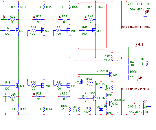

Hi
Since I intended to try a (C.D.) Current Displacer (ref: http://www.tubecad.com/2006/12/blog0088.htm )
I need your comments on the following schematics where there are some possibilities (PCB with provisions):
1) Have the C.D. (purple line) and the Mosfet M8 mounted (red line). This way all mosfet share the same bias current (negative and positive)
2) Only the C.D. (purple line) as advertised by http://passlabs.com/pdf/articles/leaving_class_a.pdf and not M8.
3) Mount M8 and also M7 the same way as M5, M3, M1. This way is the usual normal way.
What do you think?
