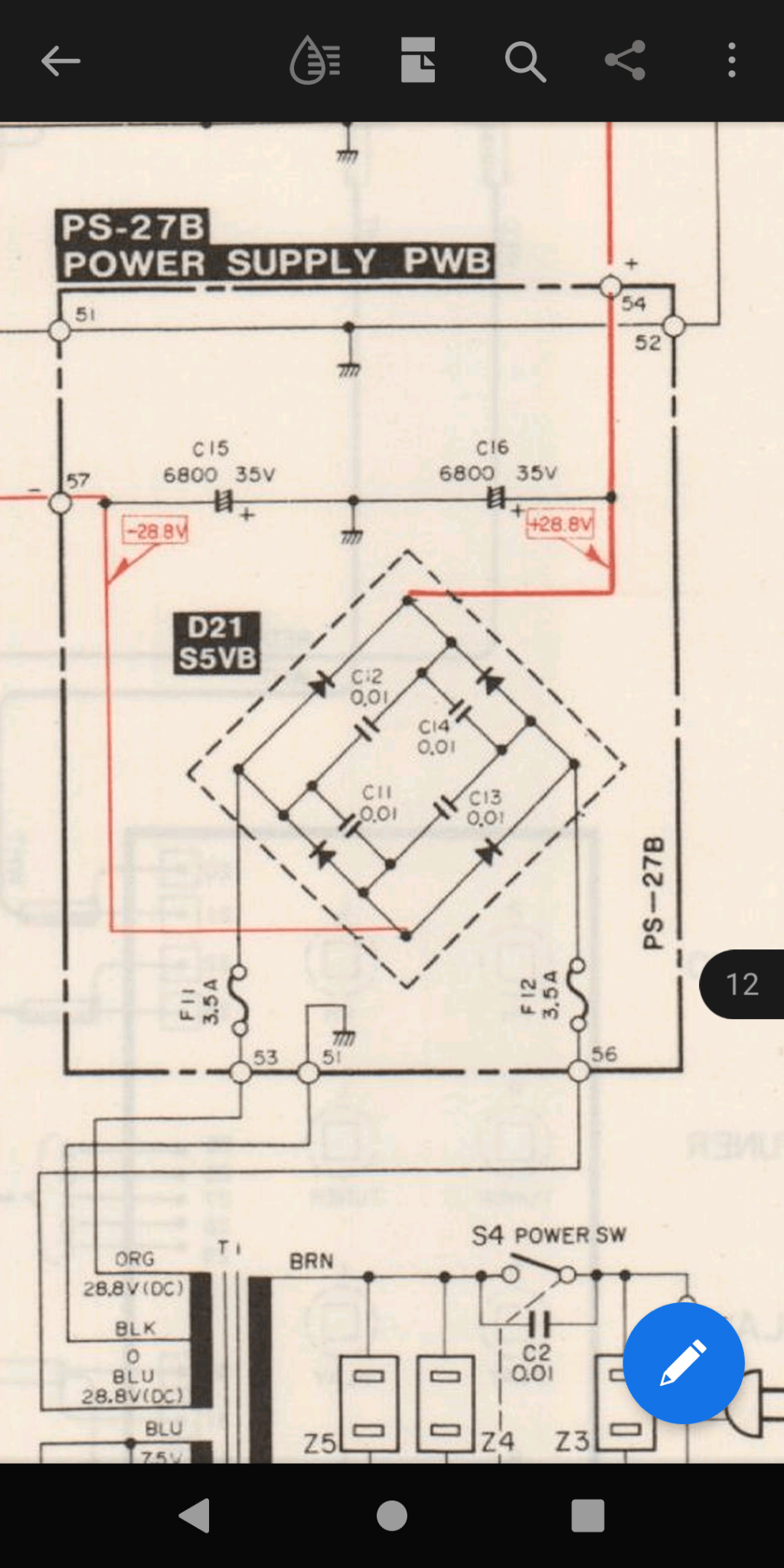

  • I suspected the big 6800 uF 35V cans on the Power Supply.
  • Left capacitor indeed drained very quickly compared to right one. After 10 seconds, left one is down to 1,5V, while right one still at 20V
  • I replaced the big caps with new ones with same specs: 6800 uF and 35V. Problem remains same...
  • I checked the voltages on the Power Supply with my multimeter and got strange results: AC voltage on some parts of the Power Supply while it should only deliver DC. Then I asked my brother in law for help as he is a technician. He tipped me to measure the diode bridge
  • Diodes on D21S5VB are ok, resisitance is 0,8 - 1,5 MOhm in the counter-current direction and 0 Ohm in the right direction of the current.
  • Then the small ceramic capacitors C11-C14 0,01 uF. C12 & C14 gave suspicious readings so I replaced those and when problem remained replaced C11 & C13 as well.
  • Now the Power Supply gives a nice 34V on both channels (so 68V total)

I forgot some important info:
  1. After replacing the ceramic elcos on the power supply, I tested the amp on cheap backup speakers. They are midrange 8 ohm speakers, no bass. Everything seemed fine at first.
  2. But when I tested it on my 4 ohm Loewe Konzertboxes there was a low background hum, that wasn't there before. Like when you connect a turntable without grounding it.
  3. Popping and cracking started again on left speaker after 5 min., so I immediately ended the test
Possible explanations / new problem:
  1. The new ceramic elcos are 103J instead of 103M (0.01 uF +/- 5% instead of 0,01 uF +/- 20%).
  2. Voltage from power supply is now 34V on each channel, 68V in total. While according to service manual it should be 28,8V on each channel...
So maybe I solved a problem but I surely created a new one...

Nothing usually goes wrong with those ceramic caps. Pretty hard to kill except maybe mechanical damage. If one was shorted, you’d know it. Some types will drift in value, but never anything serious.
The purpose of those caps is to suppress ringing in the transformer caused by the rectifier diodes. It doesnt even happen all the time (heavily load dependent) so it’s hard to tell if they are even needed. If you do get transformer ringing, it manifests itself as a low level “bizzzzzzzzz” sound coming from the speaker. And you can’t get rid of it any other way than properly addressing it (With the caps on the rectifier).
Thanks. Then I'll try to replace the 2SA798 with two transistors first and than see if the buzz is still present. I've found the threads discussing how to "make" a dual transistor to replace the old one.
