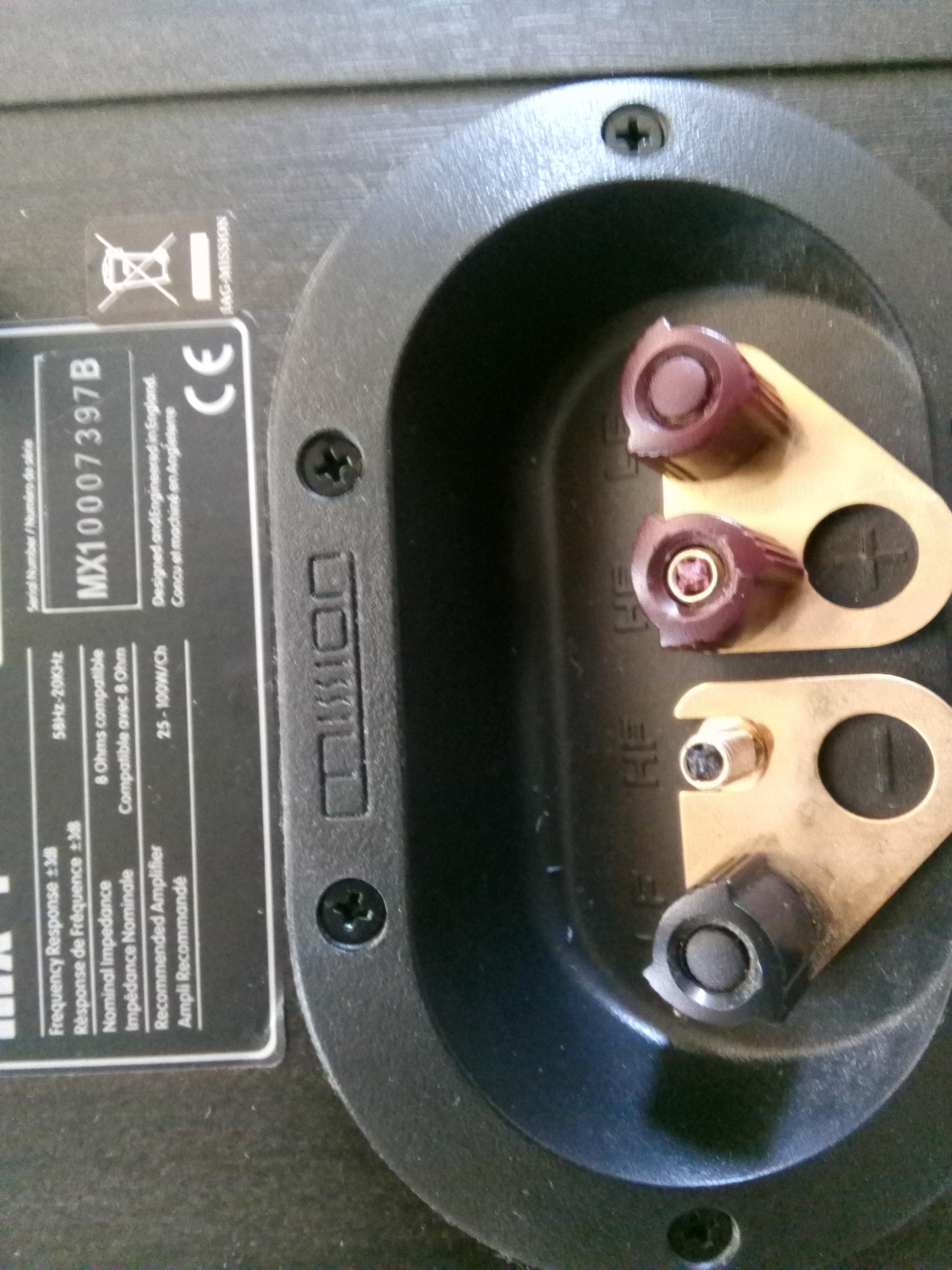

I tried to take out the plugs in the Speaker terminals on my Mission MX1s so I could plug my Banana plug cables into them but the top plastic part broke away when I tried to lever it out so I tried another one and I got the same result the top broke away? How do I get them out or are these fake Banana Terminals on the speakers? I can't upload photos of this for some reason?
This is what Im talking about, I cant see why they would make them fake? Has anyone else had this problem?

Seen pics of them removed so these must be just tight. Run a drill down the centre of them so they collapse.
I've struck a few banana socket caps which as a bit tight but they work out eventually. Isn't it a Euro requirement to prevent the possibility of mains plugs being installed?

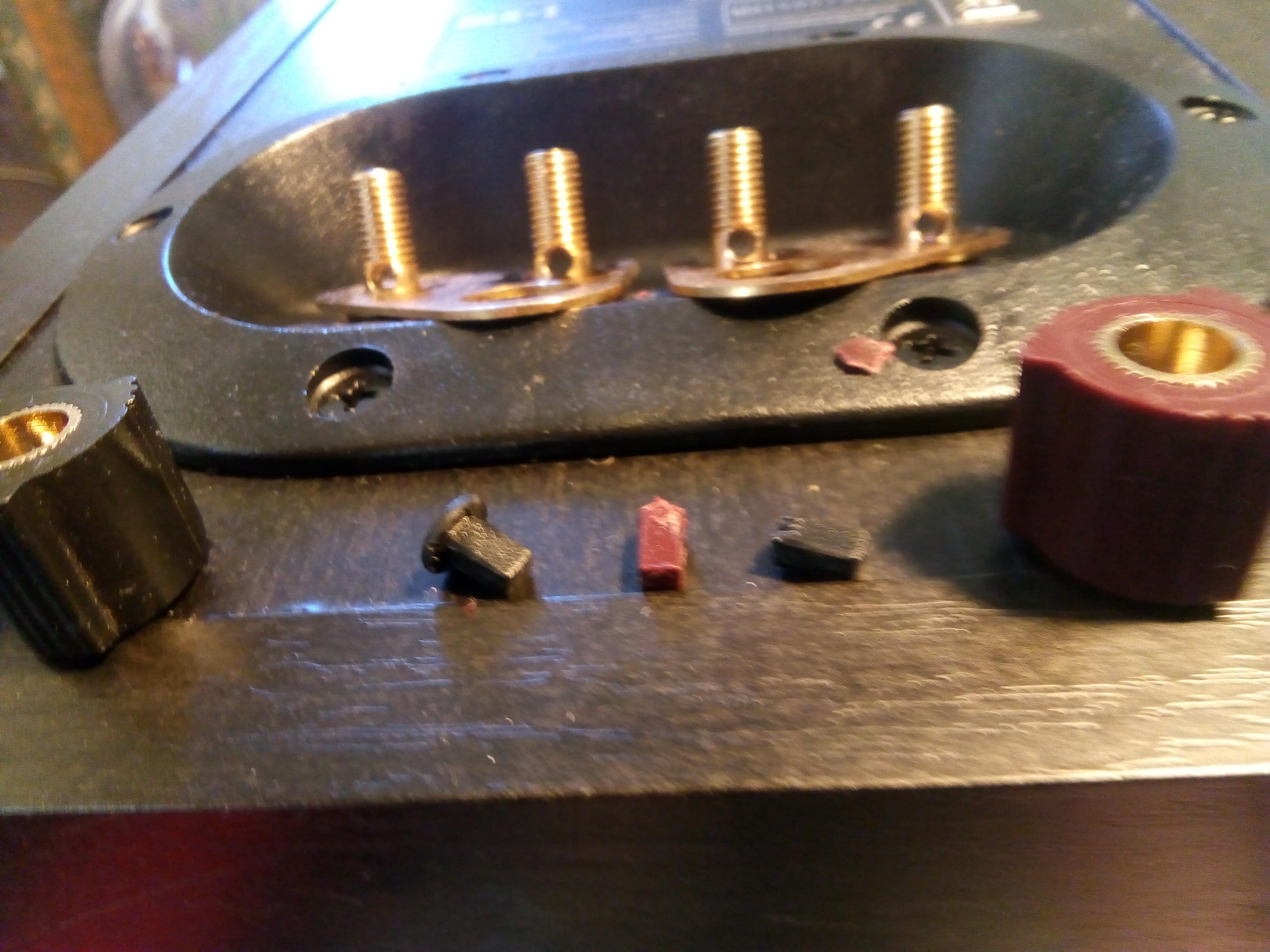

I managed to dig the bastards out and found they had put square pegs into round holes? You wouldnt beleive it if I didnt have the photo for proof would you? OMG! lol 😀
