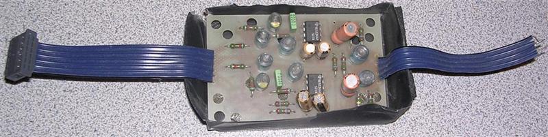

Hi audio-kraut,
Paul is saying that they used the standard (for the day) vicious high order filter to roll off the response. I still have the extra filter module as spares. That chip set does not do SPDIF out. I am thinking that I may feed the RF into another demod / filter / DAC on my Nakamichi OMS-7 (same chip set with dual TDA1540 DACs).
Depending on the filter design, it may ring. I never bothered to look at them closely. The sound was not appealing, the Nak filter is a different beast again.
I think your DAD-7000 used a nicer filter as well. If you peek inside the black box that moves freely near the back of the unit, you will see a pair of NE5534AP op amps surrounded by a bunch of polystyrene caps, also some electrolytics. The resistors appear to be metal film types.

Make sure that box is in there. With any luck, the plastic was removed and the board remounted. The filters I have use flat cables, one with a connector attached. Of course I may be mistaken and this is a later version. The fact is that you still need the filter to keep the hash out of your system.

I depends a great deal on your system. I would not run a CD player without any filtering on my system. I think your filter is the earlier version of the one I showed a picture of. I'll bet they added muting transistors and a buffer. Using a relay instead of the muting transistors may improve the sound quality.
