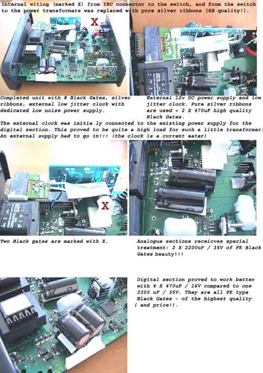

Few years ago I modified DPA DAC with exactly the same chipset / receiver chip with great results. LC XO2 with dedicated power supply / transformer and Black Gates...It had discrete analog stage boards as add-ons boards - permanently soldered to the main PCB. The result was excellent.
I had put together little reminder of what I did - for the guy who own the DAC. Sorry for a huge jpg compression.

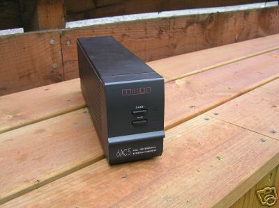

What size is it ? The dac5 I have is a small thing with the SM5840, DAC7 chipset and the LT1122.
It is really tiny see attached pic. Serial number C6137xx.
rfbrw said:
Seems mine is an earlier incarnation with SAA7323 not SM5840. Still junk though.
1. The plastic front fell off yesterday. 🙂
2. My DAC5 was fixed up incorrectly so the transformer was upside down.
3. When repaired (due to note 2) numerous cap's had been bent / squashed.
4. Also the digital input has been replaced (I guess the original connector was tight, and not screwed to the chassis)
Extreme_Boky why did you put a clock in the DPA dac ?
Did you feed it back to the transport ?
I have a DPA pdm1 series 2dac with discrete SMT op amp boards.
