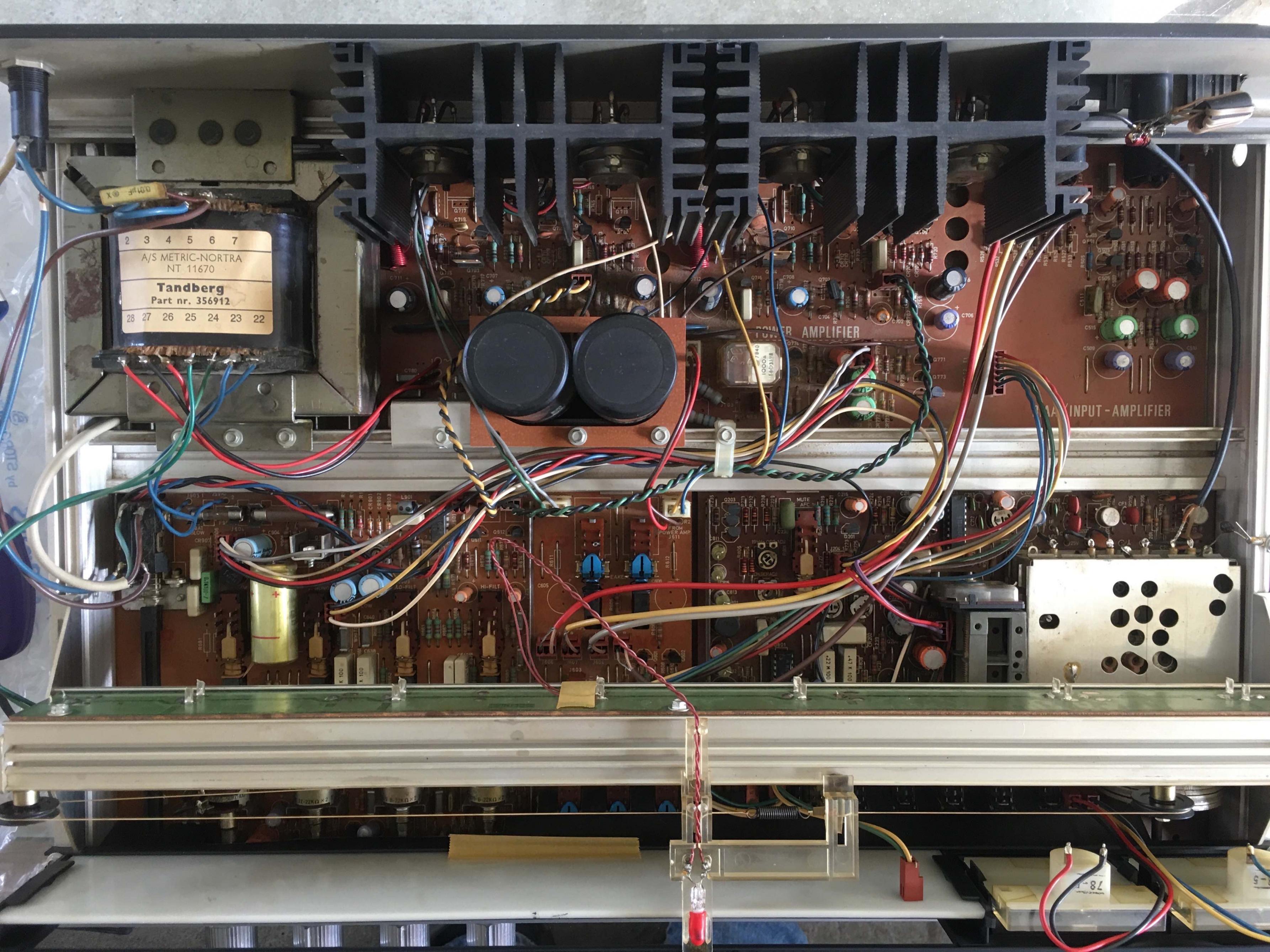

OK rayma, I won't touch this section. I agree that Mission engineers probably know what they are doing (better than me!) even if I was sceptical about the shielding. I just repaired a Tandberg TR2045 which got a shielding as often seen. I just thought about trying but after reading your words, it's probably a wrong idea.
I also have a few Cyrus One / Two amplifiers and PSX at home, and repaired or rehabbed them. I then noticed how they are remarkably well built. So I'll leave it as it is, just change what's necessary.
