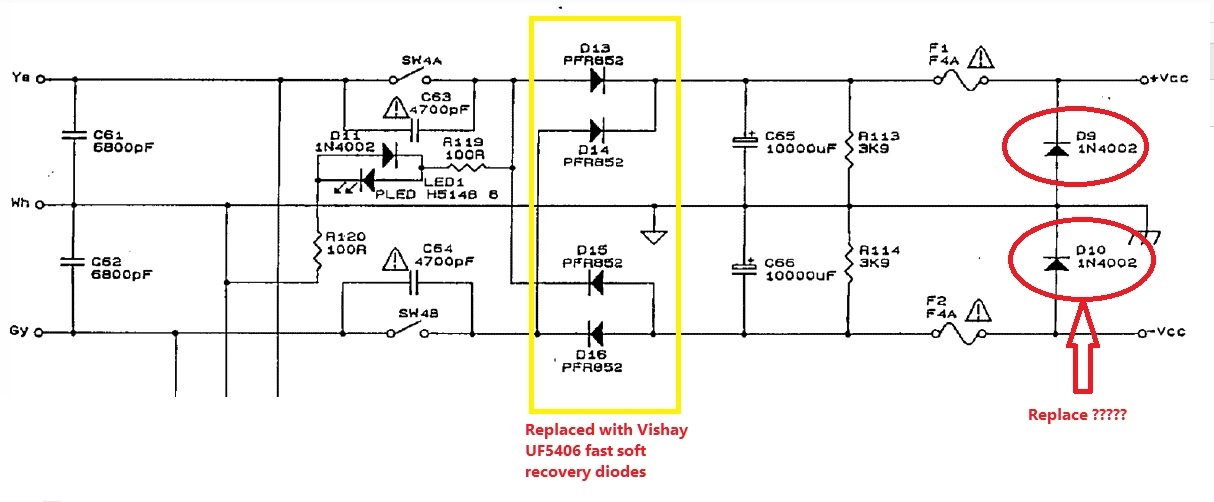

Hi again,
I replaced the 4 D13-16 diodes (attached drawing) with Vishay UF5406 fast soft recovery diodes now I noticed that there are 2 more 1N4002 diodes just after the smoothing/reservoir capacitors , is it a good idea to change those aswell?
If so so which one that mentioned below would be the best.

The UF5402 has a better spec for PIV leakage current, so no issue in that regard as a replacement. The UF5402 seems to be the most appropriate replacement imho.
Using the UF5406 as a replacement is a poor choice imho, as the on-voltage spec is higher and the part will get hotter, and it is not an equivalent part to OEM device. Why did you choose that part?
There is no need to change D9/D10 if they are the original parts - their function has no operational performance issue that could be improved on.

Which part will get hotter? the diodes?
If so why? isn't the maximum "on-voltage" the upper limit of the diode to pass voltage before it fails?
The only reason that I used this diode as I had it in hand at the time
A diode typically gets heated up by dissipating power when it is on (forward biased), with the level of power being the current multiplied by the 'on-voltage'. You are using a diode model that has a higher 'on-voltage' than the OEM part.
The UF540x range datasheet shows two groupings - one group is the lower voltage rated parts, and the other group is the higher voltage rated parts. It is likely that the manufacturer just makes two parts, and uses quality control to sort or bin the parts to the actual part numbers shown. UF5406 is in the higher voltage group, and so is likely to have a higher on-voltage (for the same current level) than a part from the lower voltage group - that is consistent with pretty much any range of power diodes.
You have misinterpreted the datasheet spec for 'maximum instantaneous forward voltage'. That spec relates to the 3A current test condition, and there is a footnote identifying the test as a pulse test, that effectively keeps the diode die temperature at its ambient level (as the forward voltage will fall for higher die temp). So the spec value for 1.7V identifies the max rated voltage that the junction will reach for 3A at the ambient temp of 25C.

Thank you very much for the detailed explanation.
As I have few UF5404 (the same group with the UF5402 in the datasheet) in hand would it be better to use it than the UF5402? would it make any difference?
It's reasonable to think that the UF5402 and UF5404 would have a similar on-voltage, and as such each of them would perform the same in your application, as both of them meet or exceed the OEM part's PIV rating. Without testing them for on-voltage then that isn't confirmed.

That amp has a large toroid 31-0-31Vac rectified in to 10,000uF bulk caps per rail, and 4A DC feed fuses. The higher voltage rated UF540x have 50-80% higher on-voltage at rectifying current levels above 3A.
I've replaced the UF5406 with the UF5402, I don't know if it's related or maybe it's just me but now it feels that there is a little less bass and "punch" from the amplifier, does it make any sense?
Is it possible that changing the rectifier diodes have this kind of effect or is it just my imagination?
