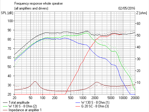

Two ways to lift bass. One to simply raise level, two to depress the midrange. Of course placing close to the wall lifts bass too.

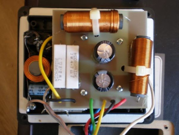

I thought the simplest plan here is to depress the mid with a bigger coil. Looks doable. Replace the mid coil with about 1.8 mH and short out the 470uF caps. Taking the bass up 1-2dB by losing the caps and depressing the mid 2dB is quite a lot.
1.80 mH Ferrite Inductor
You could also lift the bass or increase its slope with a 3-4mH rather than 2.45mH at the input:
4.00mH Ferrite Inductor
In fact there is scope to reuse the 2.45mH in the mid filter. It fits.
The mid changes look like this. Ignore the low 3-4 ohm impedance, I simmed it as a 2.5 way with single drivers. The tweeter needs a 2.2R 7W wirewound to match the new mid level. or 1.5R series in front and 22R shunt after the filter, which sounds better IMO.
I buy ceramic/wirewound resistors at Maplin for about 70P. Don't get too prissy about exact values, and remember you can unwind coils to smaller values easily enough. Inductance is the square of the number of turns, so you don't take off much.

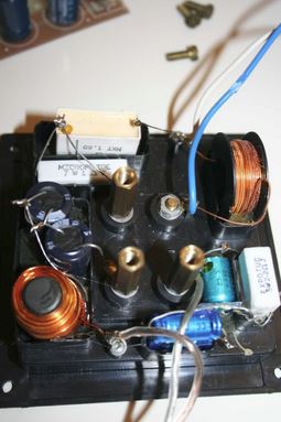

I've just finished modding a pair of 753 Freedoms.
First thing to note is that the Freedom is in fact a 2.5 way speaker, so it's no surprise they sound considerably warmer than the original.
Not so much to do with the much simpler crossover on these. If anything they are a tad dull, so I replaced the original 3.3 ohm tweeter resistors with 2.7's.
Replaced all the ring terminals, cleaned up the binding posts, got rid of the ferrous nuts and washers, by-passed the elcap across the upper mid-bass drivers with a small value Wima, as there's no room for an equivalent value poly cap.
Interestingly, those same back to back 470 uF caps that high pass filter the upper mids in the original, are used to shunt the lower units in the Freedom.
Before the mods the sound was distinctly "meh', rather uninspiring.
Post mods, they've sprung to life, fast and engaging as a 753 should be.

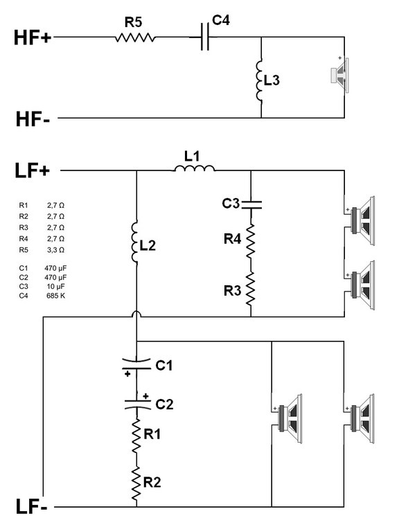

Hi Audiomark.
I don't kow if you're still partecipating here but I hope so.
I was reading your posts here as I bought some second hand 753 Freedom's. I think the lack of low's is just my case and I found a confirm of my fear that the wiring and stuff inside is a really cheap one when I read your posts.
May you help me telling me if I could bypass my lower bass crossover section resistances too as you did in the original 753's? Did you maybe manage to find any further tweak? Somebody is also helping me on another forum and they asked me to ask someone else the DCR between the - and + of low's section, if you may. That would be much appreciated.
Here is the schematics of my crossover I've drawn:
- Mission 753
