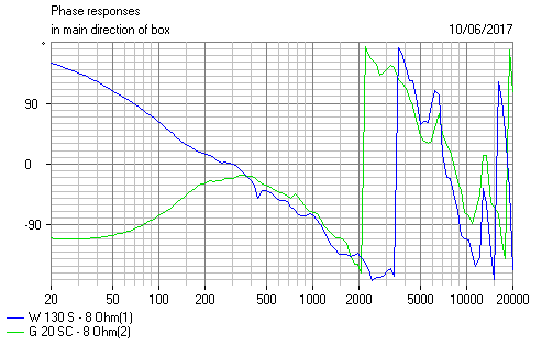

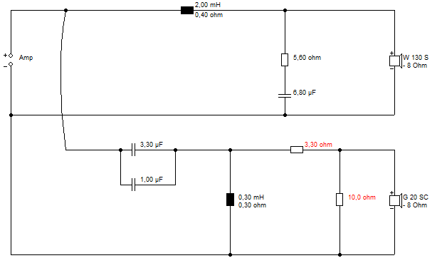

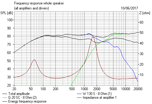

..also, would I be right in thinking that changing this cap combination to a 6.8uF cap, as suggested on the first page, would have the effect of rolling off the treble a bit? ..or is that over-simplifying how it works?
The most probable answer why they used a combo of poly/electrolyte capacitor is the simplest one. Either they had a stock of these and/or it was cheaper that way without making too much of a compromise. Increasing to 6.8 uF would elevate lower trebble, lowering XO point, increasing the SPL summed in XO region, which may or may not be a good thing, who knows.

Hi Ed. You've probably worked out that I'm no expert but my logic says if you have checked the components and solder connections then maybe there is an issue with one of the tweeters/drivers. Did you replace all 4 caps or just the 3.3 and 1uf for the tweeter?

I would guess that 5uF would be fine for the tweeter but not sure that is right for the main driver ....but would need someone with more experience to comment on that. I used 6.8uF for the tweeter as it was suggested in the first page but I believe there is a tad too much lower treble coming through (only just though), so waiting for my 4.3uF's to arrive.

You want to do some modelling to guess what modifications might do. Maybe a third order tweeter filter with say a 6.8uF added would lift the 3kHz area, which is mostly what you hear.

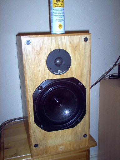

Let me explain it to you. Back in the day about 30 years ago, tweeters could only survive about 10 watts at parties. They tended to blow up.
Then somebody discovered a magic mix of aviation fuel Kerosene, magnetic ferric oxide particles and a binding agent which got them working together. This increased momentary power to about a 100W. Because it just wicks away the heat to the magnetic gap.
Nothing is perfect. Hit them hard at parties and the oil tends to evaporate. Leaving solid sludge of magnetic dust. We need to replace the evaporated Kerosene oil.
Parts Express in the US sell you a minescule 0.1mL of new magnetic oil. For $5. Happily, Blue Aran in the UK can do much better, enough for about 5 tweeters: Sonitus Audio Ferro Fluid (ferrofluid) for Speakers and Compression Drivers 0.5ml PS3.60
TBH, the Mission 751 isn't the greatest speaker in the World. But nothing stopping you cleaning out the old solidified gunge and putting some new stuff in there. It's like oiling your bicycle chain. It just works better. Get it wrong by about 50%, it still works.
