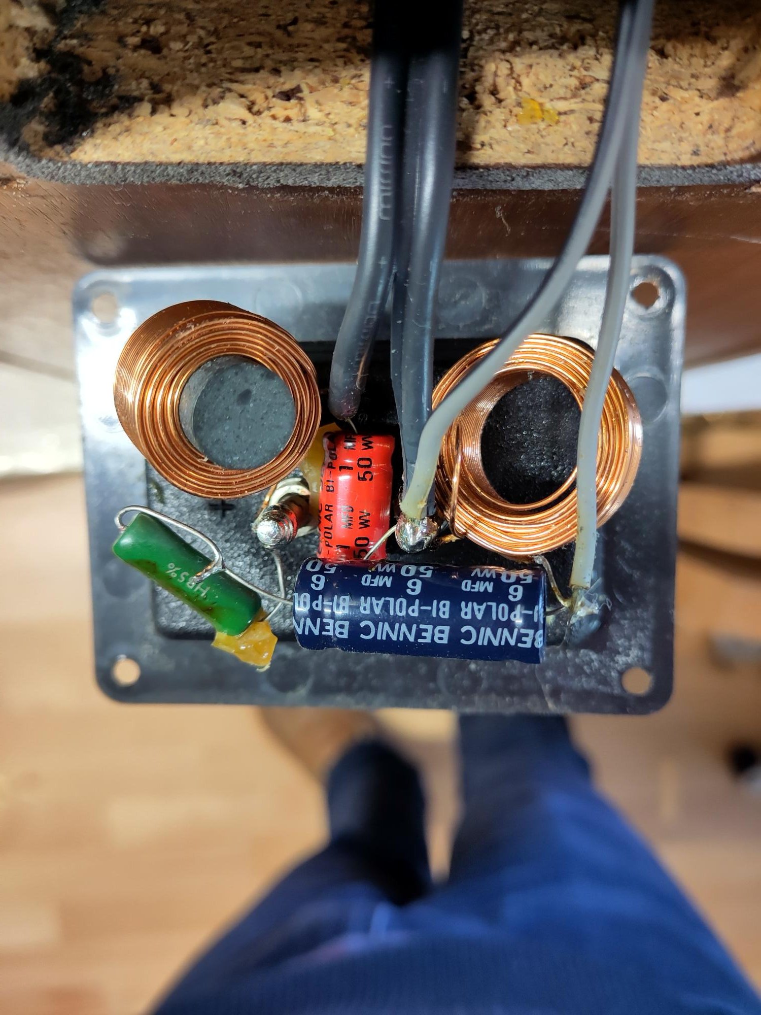

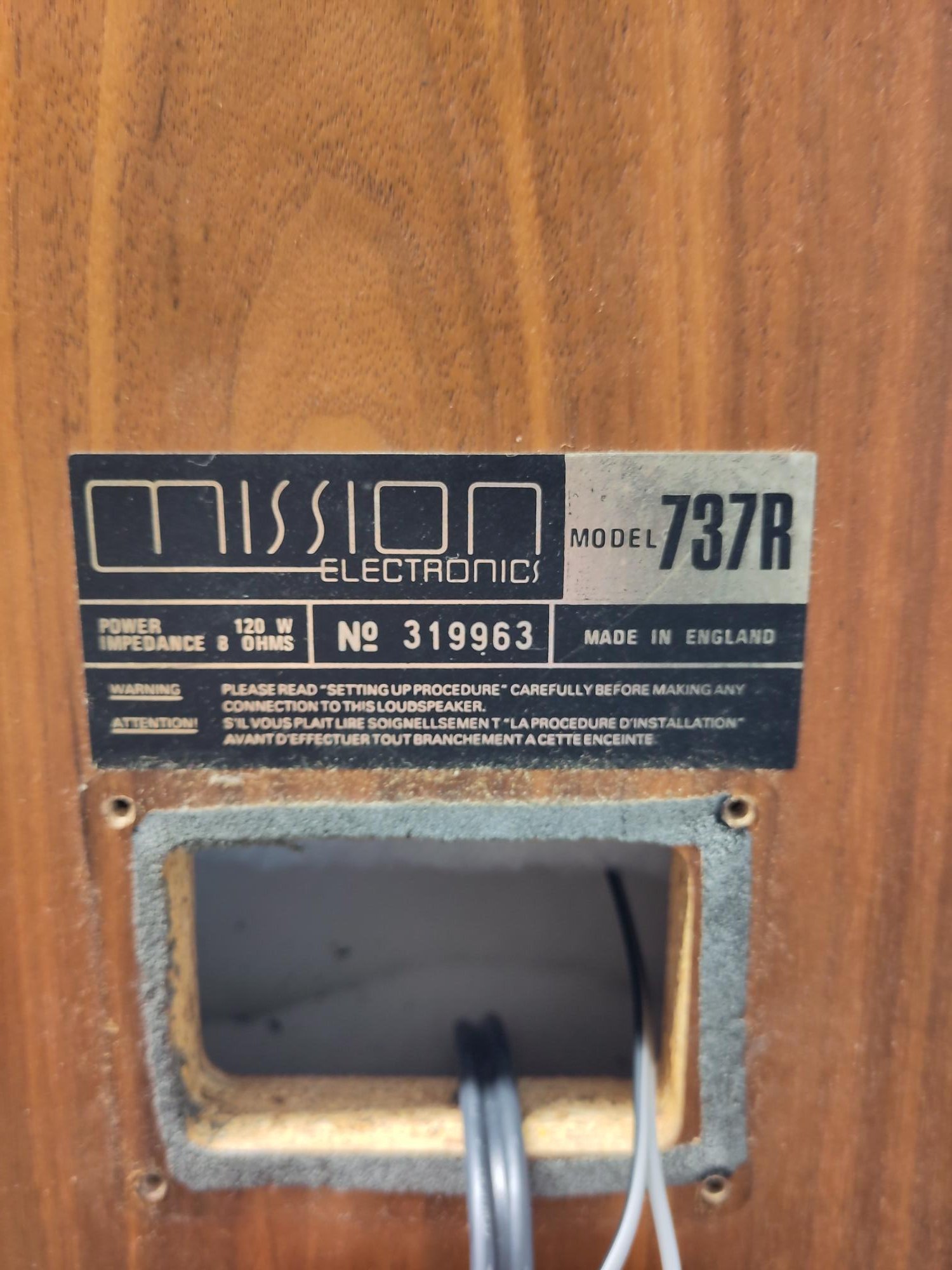

Attached are a couple of pics of the data plate and crossover on the speaker with the issue, nothing appears burnt out, or smelling such, although, I guess the shellac, has all dried and cracked off when I touched it, would I be better off to remove all components and remount on a board I then attach on the inside of the cabinet? I have taken a look at the coils on both woofer and tweeter, both of which visually appear fine from initial inspection. The only issue I found was that the studs for both +/- terminal were loose, which I have now tightened, electrolytic's appear visibly okay, but I understand these do not age well and perhaps should be replaced anyway.

P.S. I would not assume that there is anything wrong with the bipolar electrolytic capacitors.

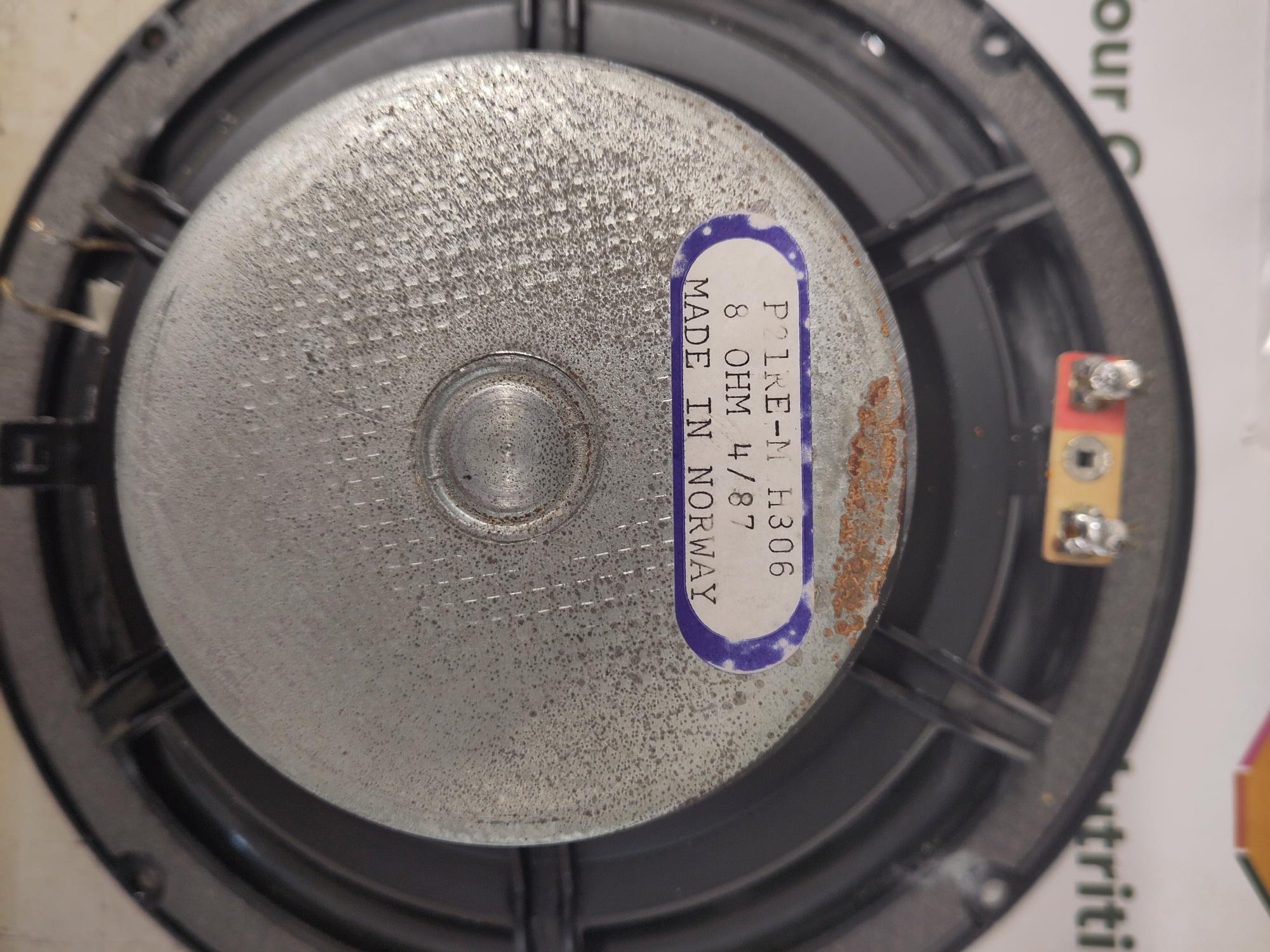

Look at the rear of the drivers to see if you can identify the tweeter and woofer make and model numbers.
I read that the woofer is a Seas P21RE-M, where the 'M' stands for a Mission - a larger magnet version of the P21RE.
Reactions: Stewgh

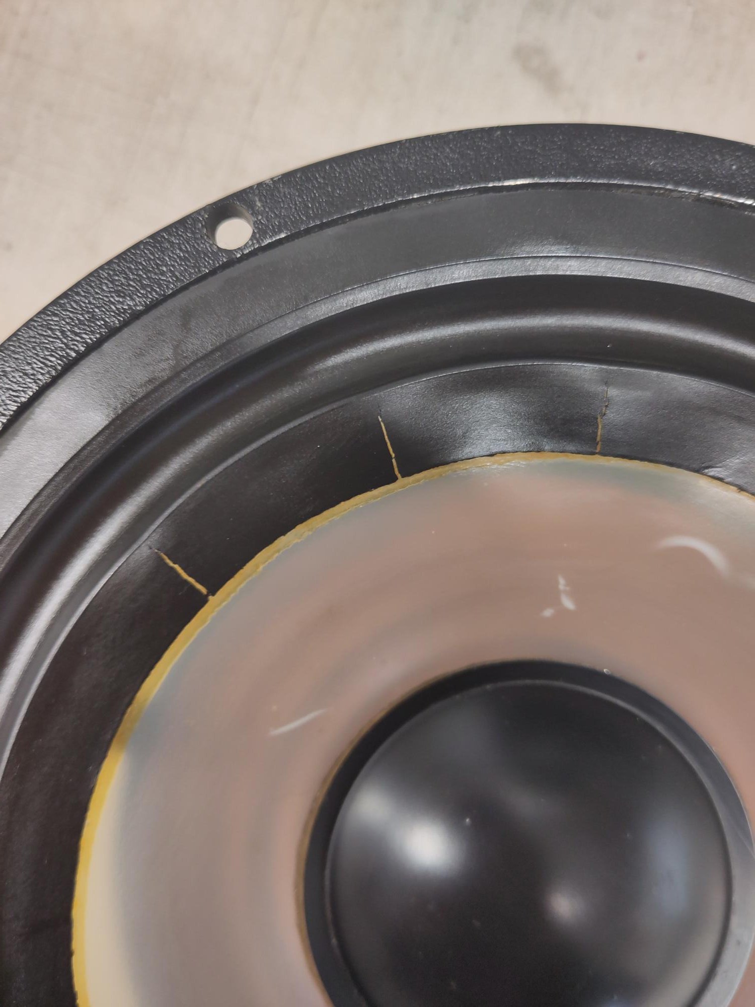

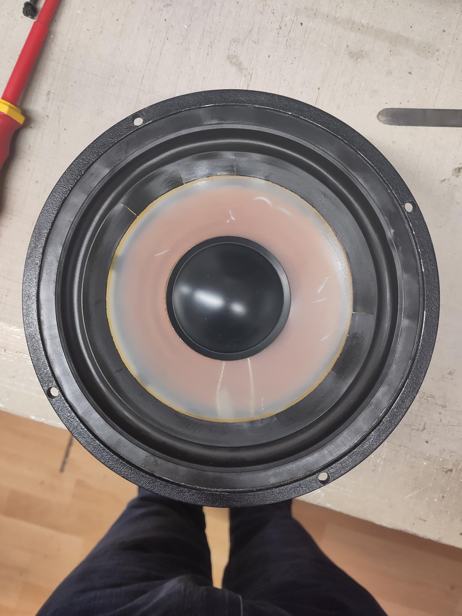

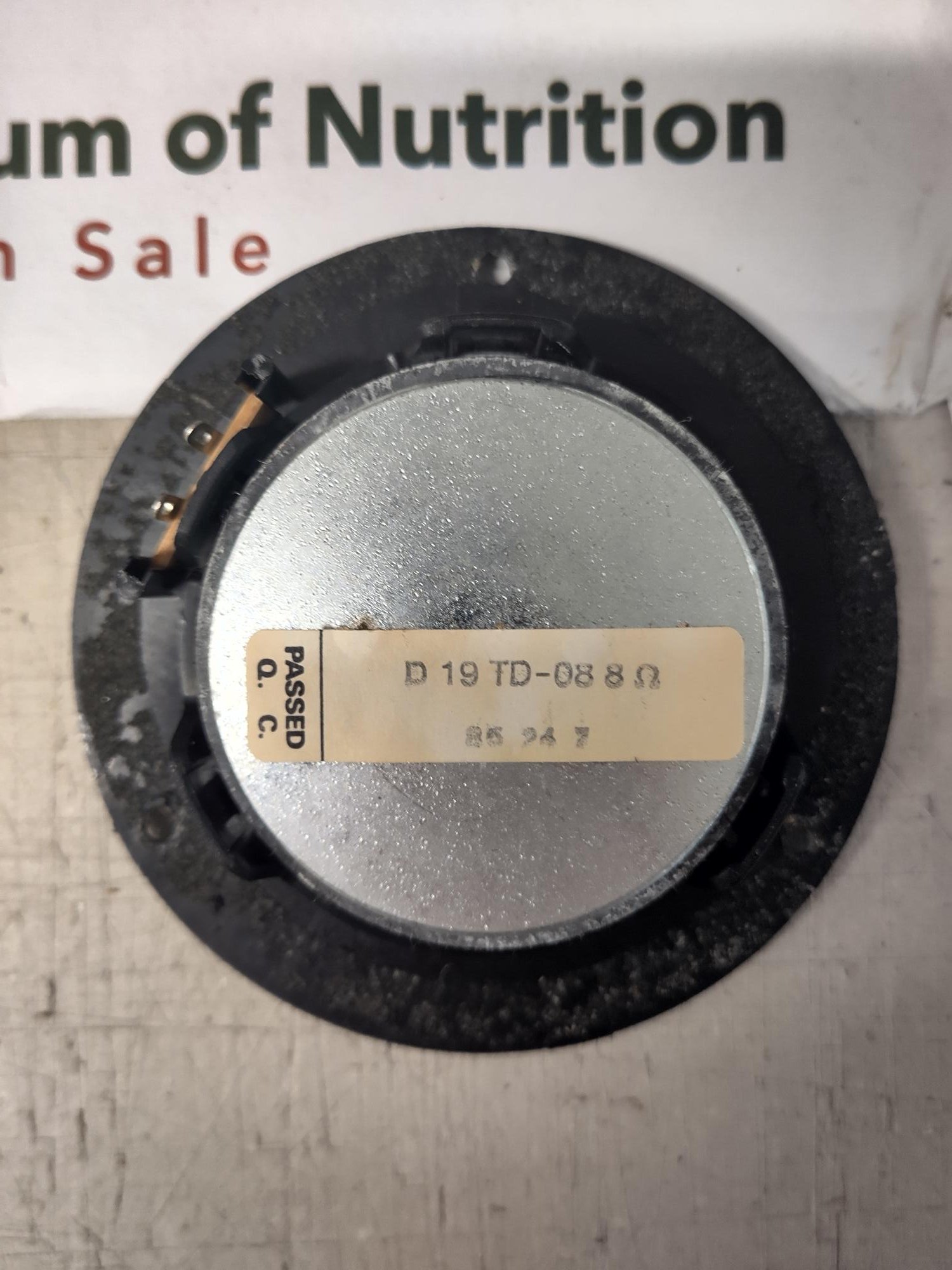

Thanks Galu, I have had a bit of time this morning to have a good look at your suggestions, attached are pictures of the woofer and tweeter details, and you are indeed correct regarding woofer.... You can also see a clear picture of the deterioration to the rubber surround on the woofer, this is similar on both, I suspect from having been stored for some years in my attic, which although not damp is probably not the best place to have stored them. I have cleaned this one up gently with some warm soapy water and then rubbed in a little silicone, the rubber feels much more flexible now, but of course there are still the cracks.
I also swapped over the tweeter to the good speaker and on test it is now completely dead! I am concerned that this maybe following me taking out of the housing to visually inspect it, the ferrofluid looked okay, at least not all dried up or gungy, the coil looked good and I immediately reassembled it without touching anything. The whole subject pf ferrofluid seems to be enormous, with lots of different opinions. So there we are..... Have a good Sunday, and thanks again 🤠

The cracks that are visible in the surround are not (yet) affecting the flexing, concave region, so pose no immediate problem.
For cosmetic purposes, you could simply disguise them with paint and hope they don't spread into the flexing region in the future.
A replacement Vifa Peerless D19TD-08 tweeter is available here: https://willys-hifi.com/products/peerless-d19td05-08-tweeter
While you are in there, it would be worth renewing those bipolar electrolytic capacitors with fresh ones like these from Wilmslow Audio:
https://wilmslowaudio.co.uk/mundorf-electrolytic-ecap-capacitors

Provided you bought the Mundorf bipolar capacitors to which I linked in post #7, you can connect them either way round in the circuit.
Bipolar means the same as non-polar, meaning there are no positive or negative ends on such a capacitor.
