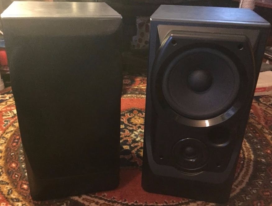

Hi - does anybody have specifications and/or details for Mission 730 bass drivers? They are 11-inch, and have 8 ohm - Made in Taiwan printed on the back. So I guess not Peerless as was usual for Mission vintage.
Many thanks in advance.

Sorry, no specs you are searching for but I suspect that a substitute unit could be a Visaton W250S-8. Peerless sls 10" 830668 might suit also. Impact Audio UK and Falcon Acoustics have these.

Love the 'car bonnet' analogy: I don't own 'the car', being the original Mission 730 beasts and not the later bookshelf units with the same name (why did they do that??). So I can't look under the bonnet. Information sent to me was that they were 8" drivers whereas other info. pointed to 11" or 255mm drivers.
Confusingly there's also legacy 730 Mark/Series 2 and 3 with what looks like differing driver arangements.
As my tag suggests, I have a set of Mission 720 originals so was interested in refurbishing the 730 units but there's no bass drivers with it. I presume foam disintegrated and they got trashed, which is a real shame.
Mission used a lot of Peerless (Denmark) drivers but archive material suggest these are made in Taiwan with polymer cones.
Other drivers are present, tweeter is soft-dome and they usually survive intact. Mid usually takes far longer to deteriorate the foam surround but I will rebuild if necessary.

Hi. I have a set of these that I inherited recently and as yet have done nothing with. It is not a polymer bass driver, it very much looks like a paper cone to me, Mine have suffered the complete failure of the foam that you mention.
I think they might be a SEAS unit from distant memory from when I looked into them at the time my father bought them almost 40 years ago. I will take them out in due course and see if I can find any further info for us both.
Ok, a quick update, They are SEAS units, the code on the back says 25F-WBX/DD 8 ohm 4/79 Made in Norway. And just for confirmation, this is a 3 way 730 mk II I am looking at, not the bookshelf variant with the same model name.

Thanks for the very useful info. Looking up the spec. on SEAS website they quote those units as 10" with a flange OD of 261mm. That matches the rebate cut underneath the standalone steel retention ring used in the Mission 730 construction.
The units I bought as replacement "original" bass drivers will not fit as they have a flange OD of 280mm, therefore it's back to tracking down some drivers of the correct size.

Quick update... I just started searching and came upon a post I've previously read about analysis / restoration of a "Clarion by SEAS" pair of speakers Clarion by SEAS
Does that look familiar!! Visually it's the same set of drivers as Mission 730 in a different cabinet....??
