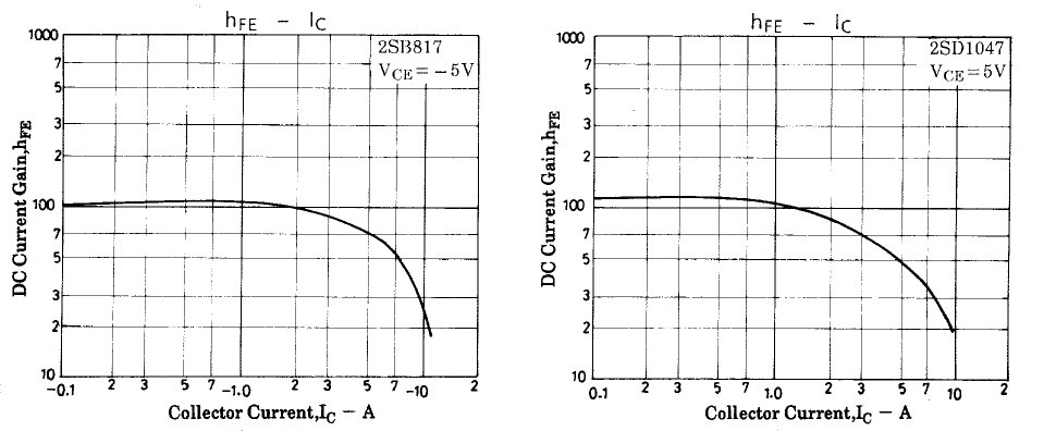

I looked up the Peak DCA55 semiconductor tester and I want one! That said - it makes its measurements at fairly low voltages and currents. Are these the right measurements to base the matching of power transistors on? Under full load, the value of hFE will be very different from that measured by the DCA55.
Vbe, hfe, are curves. The DCA has a CCS so it measures all at 2.5mA Ic for Hfe at least and its comparable spot check for same type. Full display takes a curve tracer. For Vbe it forces high Ib current so its more consistent to match but don't expect to see the same value when biasing small transistors in circuit.
From the datasheet for the 2SB817/2SD1047 it appears that hFE is (nearly) constant for collector currents up to 1,5A or so.The measurement of hFE taken at 2,5mA should therefore apply to currents up to this value. Not perfect perhaps, but a whole lot better than no measurement.
