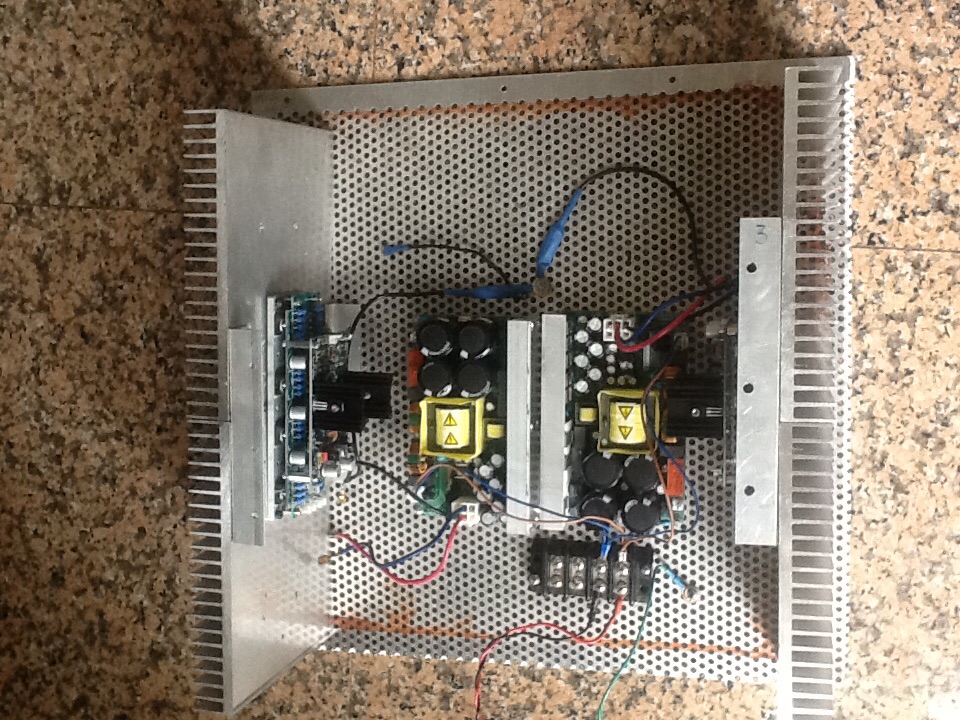

You are welcome. Please make sure that the modules are are mounted on a plane surface with thermal grease between the baseplate of the amp and the heatsink.
Don't power it up before that is done! 🙂

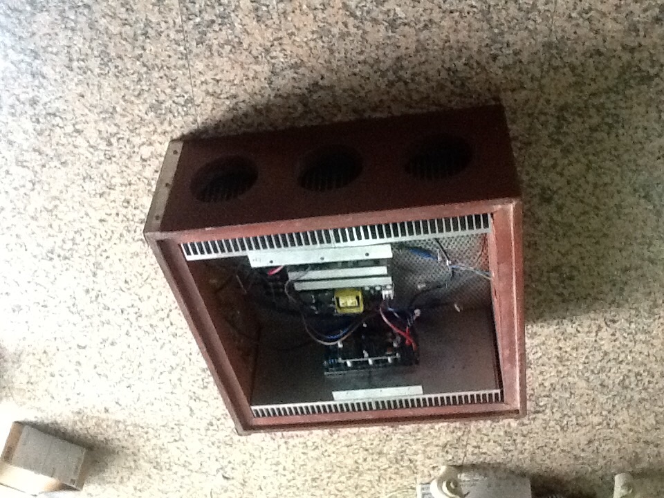

I am not an engineer but from what I see the heatsinks won't get much air flow with the woodpanels pressed against them... Do you have holes in the wood (covered with perforated metal net)? All the best, PerReady for run !
I agree with Per. That is why i wrote you about getting enough and secure cooling of the modules especially with the high bias setting you have specified.
