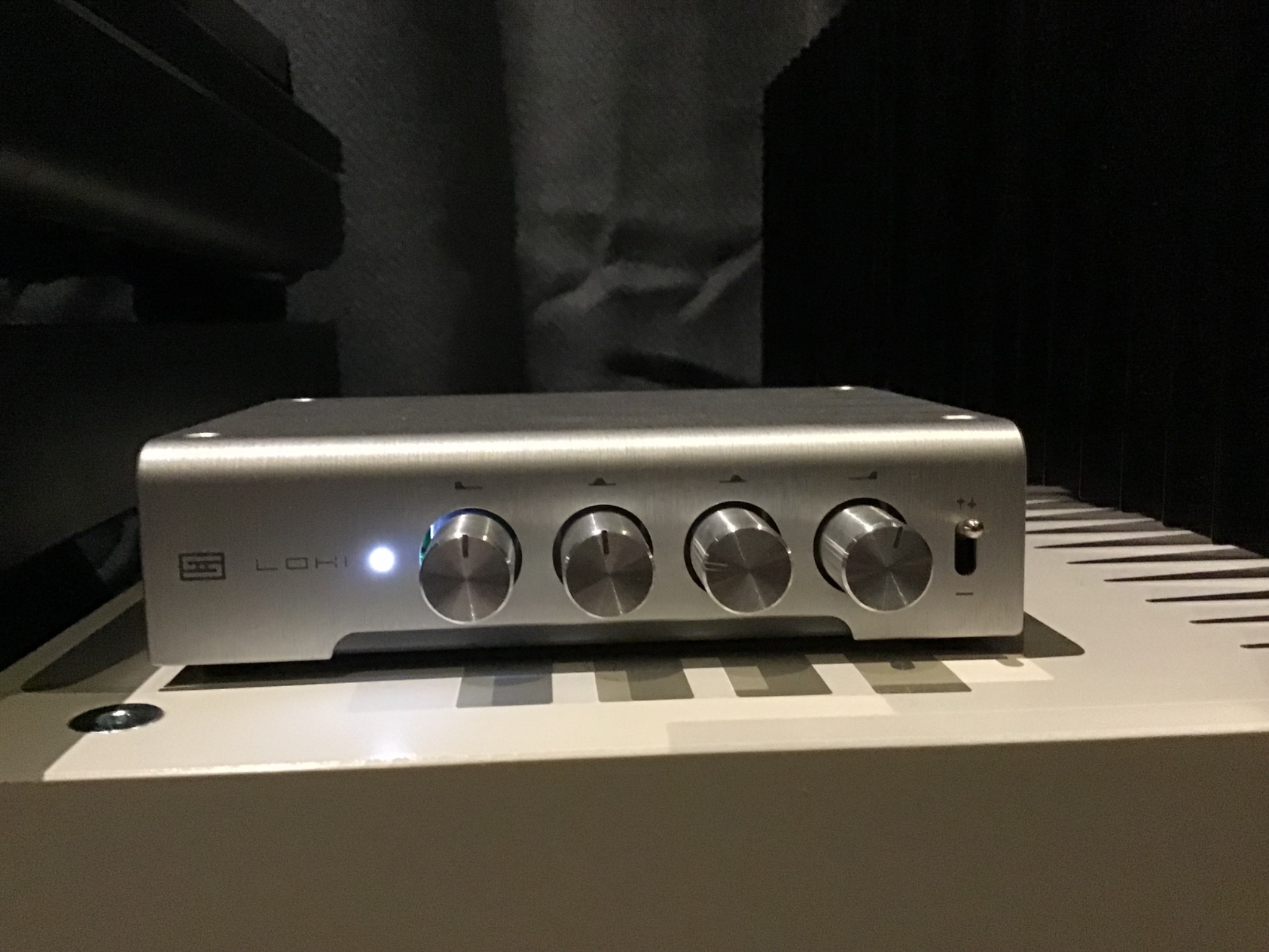

Hello. Is it possible to make a BBC dip adjuster and shelving adjuster for the high range. Like Tannoy have? My ears are very sensitive in the 2000Hz range. And I now use Shiit Loki equalizer. I tilt down 2000Hz about 3dB and shelves the up from 6000Hz about 1-2dB.

I'm sorry, but when you change a crossover it isn't only the frequency respose that changes. Phase, impedance, directivity - all change. The "need" you describe is best filled by DSP. EQ like the Loki is a very blunt tool. If you listen to digital; get something that inserts a PEQ in the digital domain and tweak to your hearts (ears?) content; someting like the WIIM may be just what the doctor ordered.

The result with the minor eq adjustment was a sucess,sounds very good now.
I am very sensitive in this frequencies,my ears are 52years and worked in noisy enviroment as a car mechanic.
So the little eq adjustment was heaven sent😀

Good. I suggest a better EQ. A parametric equalizer, like that found in the Wiim products (amongs others), will make the changes you seek easier.
