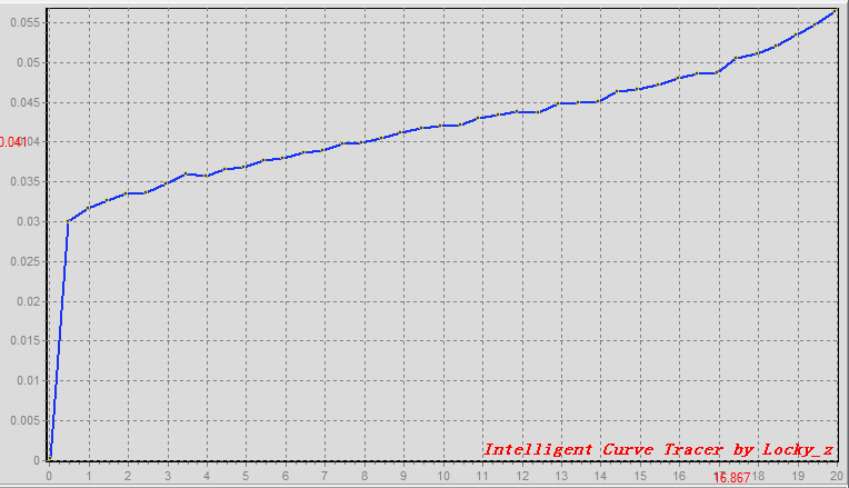

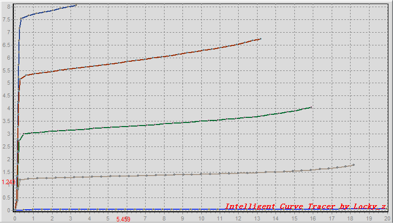

Erm... graph labels? The first I would guess is Ic(Vce) in mA over V with Ib as a parameter, the second might be Ib(Vce) @ Ic = 0, but no idea whether that's pA, nA, µA or mA over V. 😕Tested curves and leakage of a typical Germanium HF transistor with characteristic frequency as 120MHz:
Or as we were always told in physics labs, "Unlabelled graphs are useless!!!!11 😡"
Actually the horizontal axis is in Volts, standing for VCE. And the vertical axis is in mA, standing for Ic. This is a Ge transistor with Hfe a little more than 100, with each curve driven by 10uA Ib and its multiples. The lowest curve is measured with Ib=0, or the leakage. It is more clearly illustrated in the second picture.
As I mentioned at the beginning of the post, regularly such Ge transitors would have 50uA or even smaller leakage when VCE=10V.
