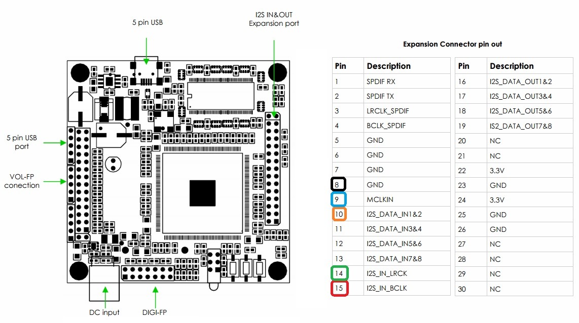

I understand that miniSHARC will not accept a consumer level of S/PDIF. What about using an USB to I2S device like this one? https://www.audiophonics.fr/en/inte...9227-32bit-384khz-dsd256-ac3-dts-p-17935.html or https://www.audiophonics.fr/en/inte...b-384khz-spdif-wm8804-to-i2s-dsd-p-14535.html

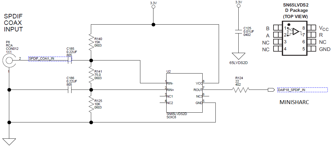

According to what it says at: https://www.minidsp.com/images/documents/Product Brief-miniSHARC.pdf ...The miniSHARC can accept SPDIF on the Expansion Connector (3.3v). Maybe you just need some common interfacing circuitry?

@Markw4 That board accepts a 75 Ohm SPDIF input. It will do what he needs it to do. If USB input isn't needed, there are other options. Here's a neat little board with a display to show the sampling rate...

There are also simple circuits you can build to convert 75 Ohm SPDIF to 3.3V output.

Neither one converts consumer SPDIF to LVCMOS SPDIF. Presumably, since miniSHARC says it has a SPDIF input then that input is not an I2S input. So, which type of input does the OP want to use?

Sorry, I was confused. I thought you wanted a way to get a 75 Ohm SPDIF input on the miniSHARC. If you want USB, then use the I2S output of the Amanero to the I2S inputs of the miniSHARC.
I can't give any advice on which master/slave configuration is best. I'm still a digital noob.
Most commercial USB-I2S boards work only in master mode so miniSharc needs to be configured to input slave mode.
Yes, Amanero can accept MCK input but that is not exactly the same slave mode as miniSHARC specifies (also BCK and LRCK as input). Although it may still work depending on the timings.

There should be no need to go to extremes so long as some basic things are understood:
I2S bus consists of two clocks and one data signal. They are named BLCK, LRCK, DATA, respectively.
Some devices also use a master clock signal which is not part of I2S bus. It is named MCLK (its frequency may differ depending on if the audio sample rate is 44kHz family, or 48kHz family).
SPDIF (including TOSLINK, AES/EBU) uses one signal to carry both data and clock information. It may be simply referred to as SPDIF (or maybe as a SPDIF-type signal).
If using USB somewhere there is generally a master clock (two clocks actually, one for 44kHz family sample rates, and one for 48kHz family) . Those usually are on the USB board. Some USB boards such as Amanero can accept and external MCLK signal.
For the I2S bus clocks (LRCK, BCLK) they can be generated by only one device on the bus. The device that generates those clocks is called the I2S MASTER, the other device on I2S bus must then operate as a SLAVE.
Usually the device sending data on the I2S bus in the MASTER. Some devices can work with the device receiving data as the MASTER, but that's not so common.
Once all the above is clear, then interfacing from USB to miniSHARC can be done in multiple ways. It can be done using a SPDIF-type signal, or by way of I2S bus. Depends on what the designer wants to do.
