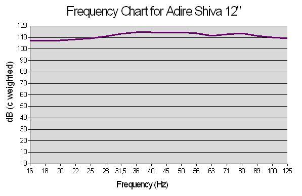

Well, for a subwoofer, you can allow a rolloff to take into account the room gain.
I use a -3 dB per octave of rolloff to achieve a flat response in room. Some people allow more.
For example, I did a subwoofer that looked like this :
-0 dB at 80 Hz
-2 dB at 40 Hz
-5 dB at 20 Hz
It's near -3 dB per octave and in a room it looked like this :
