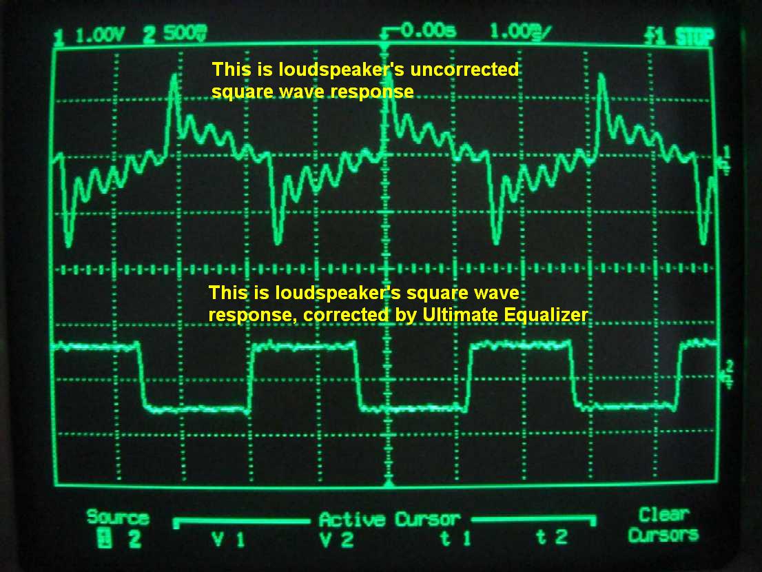

Do it digitally with the Bodzio Ultimate Equalizer.
Duelund crossover are not minimum phase or transient accurate.

The topic title refers to minimum phase, but the discussion has focused on linear phase. Why would anyone want linear phase?
The OP intent is a little ambiguous. If he meant minimum phase crossover, then most crossover sections are minimum phase. A minimum phase system would be linear phase to the extent that it had smooth and wideband response. That is the definition of minimum phase, that any phase deviations are simply those tied to frequency response shortcomings, so equalizing the system perfects the phase response.
As I've mentioned before, proper crossover topology would not be enough. Interunit time delay would have to be physically corrected also.
Why would we want it? Pretty square waves. No one has yet proven that linear phase is a prerequisite for good sound.
David S.
Use DSP such as the Ultimate Equalizer and you can at least eliminate the arguments that the response suffers because it's not linear phase. The focus can then move on to the areas most likely to be issues that are known to affect perceived response. 🙂
Dave R.

Dave,
That might well be true if one were to regard AES-papers and such as the only source of truth. In this specific question we are nowadays in the lucky position that anyone who is really interested whether "phase matters" or not can readily test this himself/herself, assuming you have access to a PC-based system for measurements and manipulation (convolvers inserted in the audio chain, in this case).
Mind that it does not you cost anything, all the needed software and knowledge is in the public domain... somewhere in the HolmImpulse-Threads I described how to basically phase-linearize a given multiway-speaker, only other SW you need is excel (or any spreadsheet SW) and a convolver (eg the one intergrated in the Foobar2000 SW-player). So you have a powerful FIR-machine running and of course you can further manipulate the kernels and/or use analog/IIR-based additional EQ. For example I dialed in a linear-phase bass-rolloff instead of the natural minimum-phase response, to "speed up the bass" even more....
With a bit of ingenuity in the procedural handling you can set up fully blind testing conditions, including fake tests etc and to my knowledge anybody who has tried this came to the conclusion that, while generally subtle, phase issues -- including polarity -- are audible (with nothing else changed in the speaker, of course, another merit of the source-manipulating approach). The changes manifest in many ways, different timbre, different perception of space/reverb, different dynamics. With some recordings it matters more than with others, and it all is very subjective (as to where preferences go) as well as a matter of taste.
Given this powerful means I think a good approach is to let go of linear phase XO in the analog domain, better use one of the many known good ways to make a decent speaker without panicking about the allpass behaviour. To make full use of adjustable phase response one needs DSP-eq'ed listening conditions anyway and then phase linearisation to any target is part of the cake (with the better systems at least).
- Klaus
One of the biggest problems in assessing linear phase loudspeakers in the past has been that such tests have not been based on all other things equal. With the PC software available today, like that contained in SoundEasy V17 or the Ultimate equalizer, a speaker can be designed from the ground up and listened to in linear phase mode of "normal" nonlinear phase mode with absolutely no changes to frequency or polar response. Or the signal feed to an existing speaker can be preprocessed to correct the output to a linear phase response. These are truly all other things equal approaches which allow the listener to reach his own conclusion regarding phase linearity.
All true. The question is not whether phase matters, but where the threshold of perception is. Certainly larger delay times will be audible, this going back to Hilliard and theater speakers in the 30s. Also certain test signals have been found that can be more revealing than natural sounds. My belief is that, on music, our currently typical well-under-a-millisecond discrepencies are below that threshold. Tests on all-pass networks e.g. Blauart and Laws, tend to confirm that
My problem is that once "linear phase" is made a priority, in my opinion, more important areas of performance are usually compromised. Just reading this thread you'll see that most here think that all they need is to stick with a first order network or subtractive network and they'll be good. Clearly interunit time delay has to be dealt with, which means complex cabinets with physical driver offset built in. This generaly gives a few more folds in the cabinet to create diffraction and reflection issues. The first order network will compromise power handling and its excess overlap will compromise off axis frequency response. If it is pursued correctly then the rolloff of the drivers, always greater than first order, will have to be equalized upwards beyond the crossover points. This will further complicate matters and compromise power handling.
For a DIY project you can set your own priorities and have at it. You will likely enjoy the results and confirm that all your design choices were enlightened. But for commercial systems, pursuing phase linearity will always have a cost and once you pursue it you will inevitably cut costs in other areas. I think this is the primary reason why linear phase was essentially a fad of the 80's: cabinets cost more and nobody ever heard the difference.
I do put credence in AES papers and follow what Floyd Toole and Sean Olive write. Numerous times they have done rigourous tests where they have not found phase linearity to be a factor in listener preference. Most interesting would be Sean's latest work where he has been able to come up with the numerical weightings of measurable performance factors that allow prediction of product ranking. In the end the required measurements are various forms of frequency response: on axis smoothnes, on axis flatness, bass extension. Phase performance is not a required factor. I would maintain that pursuing flatter phase will typically degrade those factors that are important.
- Klaus
I'd agree with this. Once you go with DSP networks then phase linearity is a fairly simple attribute to achieve and won't force compromise on other performance areas. I just don't believe it is a requirement.
