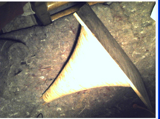

Here I'm attaching a photo of the Le Cleach horn flare that I plan to use to cast the oval concrete horns from. Not visible in this photo is that there is a small mouth flare curvature to avoid a discontinuity with the front flat portion of the horn. The horn and driver attachments and external horn mold forms are not made yet.
