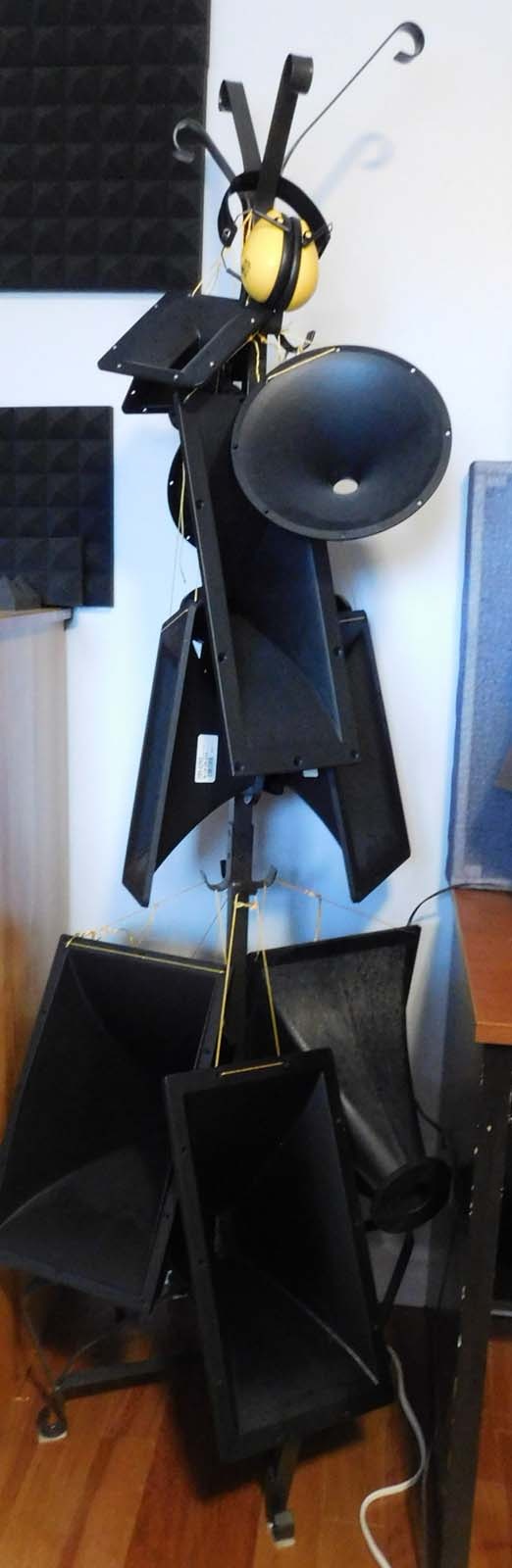

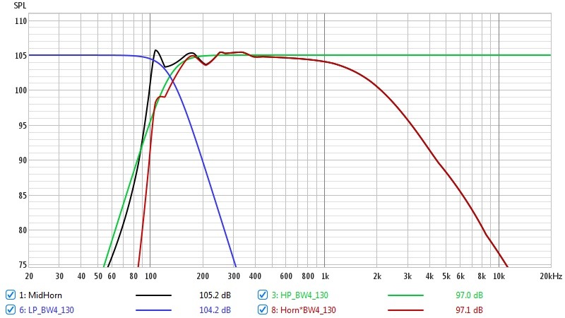

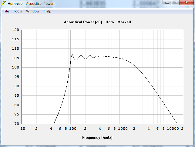

I attach the power response of a midbass horn that I designed. What hipass filter would you try on it if you were in my shoes ?
Do you think a steep FIR filter would help extend the low end usability of the horn ?
Certainly you'll get more phase shift with higher order IIR filters. All the systems are linear, so I don't see how you could take two linear systems and create a nonlinear system. The response of the system (horn+driver) is the convolved freq response of the driver and the horn and that's also linear. The problem is getting the separate driver and horn data, as they are usually combined. The DE75TN spec shows a system curve that falls off at 500Hz but its tested an ME75 horn which is the limiting LF factor (ignoring sensitivity, max SPL, THD)
We can use your Hornresp curve but we'll assume its actually the system (horn+driver) SPL axial response. However, this Hornresp graph is a power graph and at low freq, the pressure (dB SPL) will look similar to this power curve, At high freq the pressure curve will deviate from the power curve because the beamwidth is changing. Lets also assume for this example, we can ignore the beamwidth, the sensistivity, the max SPL, and the THD.
I digitized the Hornresp curve (no phase), and used BW4 filters because the system LF roll off is 4th order. We could also XO a bit lower freq with higher order filters or XO higher with lower order filters as you've suggested. I'm assuming we want to HP XO as low as possible. The first graph shows the system response and 3 *BW4 filters [100, 130, 160] Hz to show its 4th order and where the filter response intercepts the system response. In the second graph, I've selected Fc=130Hz, and I show the complementary LP BW4@130Hz, and the combined filter+system response. The combined "filter+system" curve deviates from ideal BW4 when it crosses the "system" curve at 105Hz, At this 105Hz intersection point the LP@104dB, the HP@97dB. and the combined (140dB+97dB) is 104.8dB and nearly the 105dB target. If the system+HP filter slope falls faster below 105Hz it will make no difference because it's below 97dB and sufficiently dominated by the LP.
The sound quality between CDs pushed low (for them) vs. cones has come up a few times in some of my recent reading and the type of systems I'm working with, Cone vs. low-loaded CD has the most clear data I've seen to explain this phenomenon, specifically the drastically higher IMD from a compression driver at MF, but there are also mouth artifacts at play in those ranges with horns like the K402 or JBL 2374/2384. Intuitively it seems to be more appropriate to have a larger diaphragm where acoustic sources tend to be larger (In vocals, vibrations from the chest vs. fricatives from the mouth); while it's more complex than that, as a rule of thumb, you could do a lot worse.

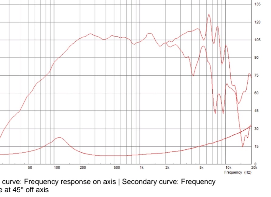

The horn power response I posted above was modeled with a Celestion TF0510 cone driver. Doesn't hold much power for a midbass, but for home use 30watts are plenty and I managed to model a very smooth response with this driver, much smoother than many other I tried.
Frequency response of the Celestion TF0510 driver attached.

I am not sure I really need this horn to extend that low as the Celestion TF0510 has a more or less straight response down to 200Hz.
So the question is if I really need 100hz Fc horn to cut the driver at 200 or if the horn can be made smaller (mouth) and shorter resulting in 150-200 Hz Fc and still be used down to about 200, with a steeper slope filter if necessary.

If you are crossing at 200Hz using a cone driver, no need for a horn with an Fc of 100Hz, as long as the driver's excursion stays under Xmax at the desired output level.
A larger mouth will have smoother response near Fc.

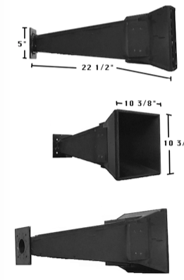

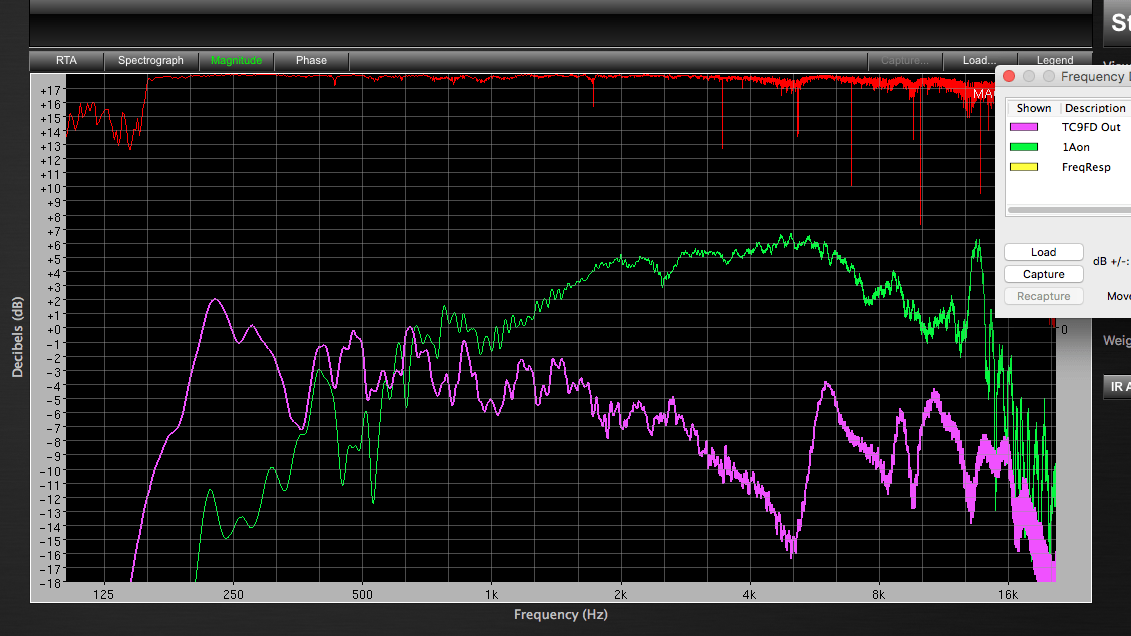

Here is a relatively small two part 2" throat conical (Maltese) horn with an Fc of ~228Hz:
And it's response with a 3.5" Tymphany TC9FD cone driver, (1 liter back chamber, no phase plug, ragged upper response) and an Electro-Voice DH1A (3" diaphragm, 2" exit):
The $23 cone driver has more clean LF output than compression drivers costing more than 10 times the amount. The old DH1A beat out newer models in every metric I could test.
There is no replacement for displacement, and HF compression drivers have very little, <1mm.
Some midrange compression drivers like the Altec 290 or JBL 2482 (both phenolic) have slightly more diaphragm to phase plug distance, allowing a 300Hz crossover.
But in my experience, those drivers just don't sound as good near Fc as cones whether it's IM distortion, or air-non linearity from the high compression ratios or whatever.

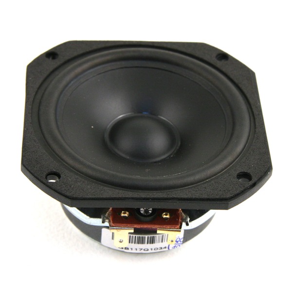

Is Vifa TC9FD attached, same as Timphany ?
