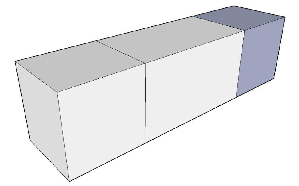

Yeah, I think I'll go with trying to use two 10x15.5x25.4cm boxes. However, could I adjust this so that the volume is the same, though with changed dimensions?
I've managed to pack the electronics for my boombox into ~24x14x14cm box so I just need to arrange that with the speaker boxes in one package...

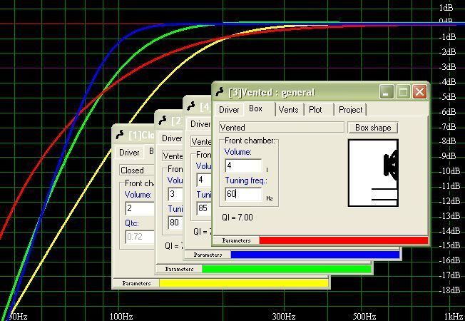

Isobaric is silly because you could simply choose a 4 ohm driver
with the equivalent parameters of the compound isobaric driver.
Taking sealed as the "standard" volume, an isobaric arrangement
would be ~ half the volume sealed or ~ the same volume vented.
One driver vented is going to be ~ twice the sseled volume.
If your going vented you will need to include a highpass bass filter.
Consequently a 6th order alignment begins to look attractive.
For the flat vented responses you'll need a butterworth bass filter
(Q=0.7) set say 20% below the port tuning frequency. The red trace
shows an alignment you could use with a high pass filter set to 60Hz
but a higher peaking Q than Butterworth, usually Q=1.5 to 2.0.
🙂/sreten.
FWIW is these volumes are too big simply choose another driver.
The TB's do not appear to be particualarly good value.
These drivers sealed + mini tweeter are a possibility :
