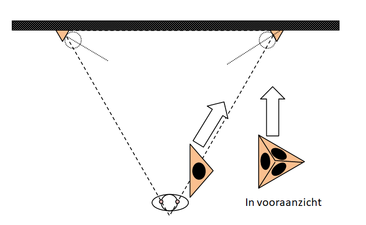

Perhaps the following approach of a wall mounted omnidirectional (half-sphere) speaker give somes inspiration:
The pyramid (tetrahedron) is mounted with its base plane against the wall.
Features of this setup are:
  • Suitable for small listening rooms
  • As with the omnipole, a good “spatial distribution” of sound
  • Only 1 speaker per box “is in direct sight” from listening position, so no comb forming.
  • No single reflection from back wall to listening position (reflection point is in same
plane as the speaker).
Disadvantages are :
- Direct speakers are seen at an angle of 30 degrees. This gives some (1.2 dB) loss plus
a little more at high frequencies due to beamforming.
- Not yet tried (at least not by me)

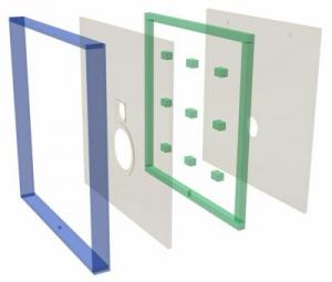

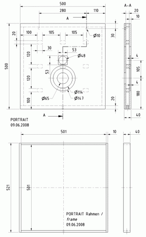

Visaton has examples to inspire for wedge corner subs and satellites.
They did the Portrait 2 way Solo Eckbox and corner TL Sub
likely more just a few links I could remember

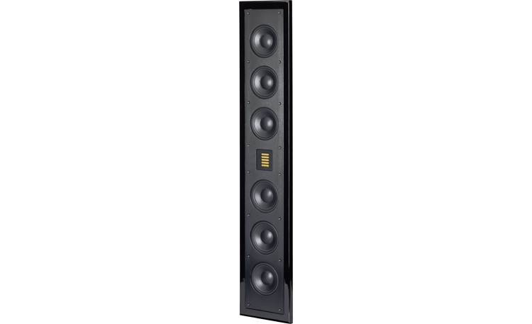

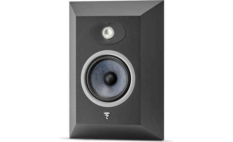

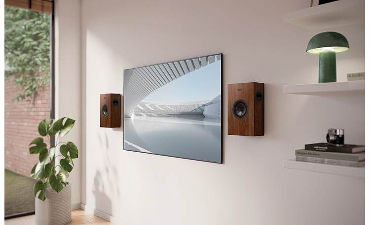

For reasonably attainable minimal depth, there are quite a few on-walls. Below is just a few of the - there are more out there. Some of these are ported/passive radiator, but I'm not sure if your description was for a sealed box from an enclosure design standpoint or if you just meant not an infinite baffle/in-wall installation.
MartinLogan Motion SLM XL

KEF Q4 Meta
https://www.crutchfield.com/S-PdXiEx29D3s/p_991Q4MWA/KEF-Q4-Meta-Walnut.html

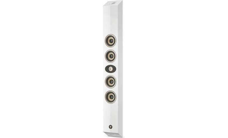

Focal Theva Surround
https://www.crutchfield.com/S-WWF1x0gHQS2/p_091THSRNDB/Focal-Theva-Surround.html
Focal On Wall 302
https://www.crutchfield.com/S-tufi7r0g4Lc/p_091OW302WH/Focal-On-Wall-302-White-High-Gloss.html

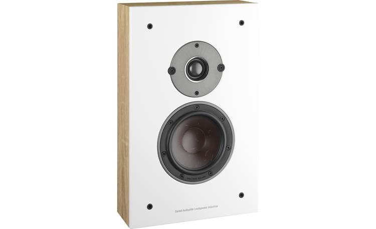

DALI Oberon On-Wall
https://www.crutchfield.com/S-F8CfuFk9dWU/p_411OBOWOK/DALI-Oberon-On-Wall-Light-Oak.html

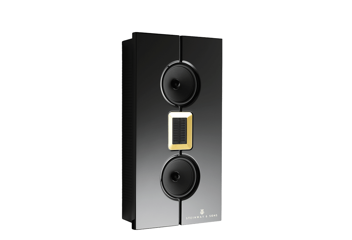

STEINWAY & SONS MODEL M L/R
https://steinwaylyngdorf.com/steinway-sons-model-m-lr/
