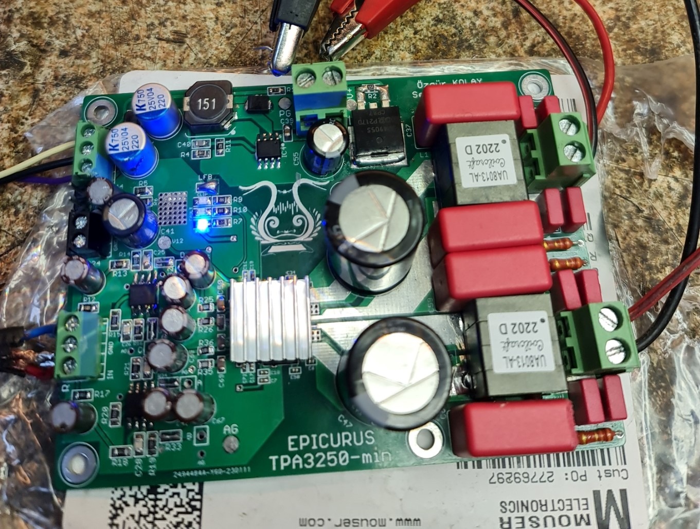

I finally had a chance to assemble my amp and try it out.
I can briefly say that it has a great sound.
Although I ran it at 450Khz and did not apply PFFB, the noise is quite reasonable. The trebles, mids and bass are full and detailed. Distortion is reasonable but it has a very musical characteristic.
It is also quite stingy 🙂

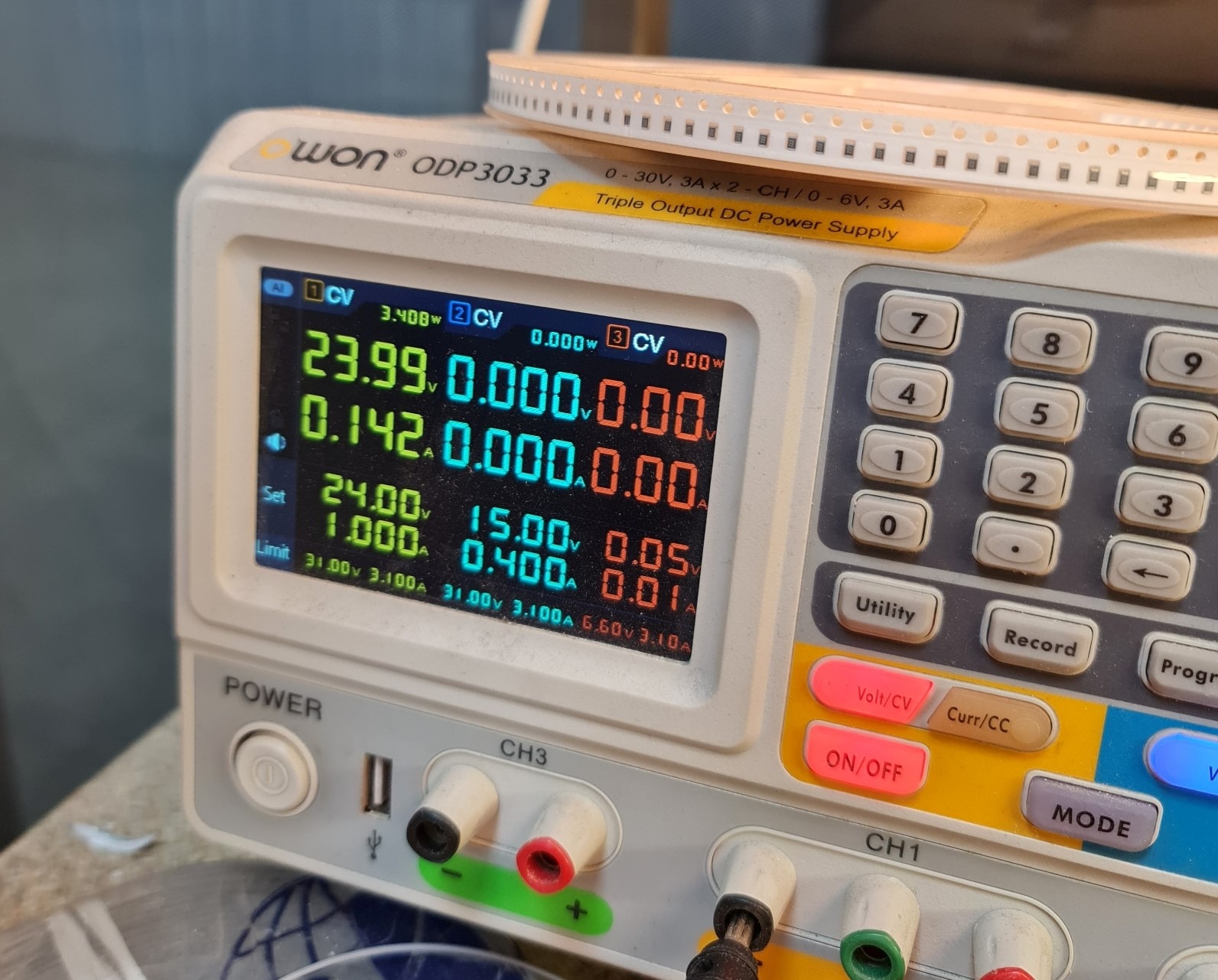

At nominal listening level with my 86dB speakers and 24v supply, I observed a current draw of only 150-160mA. It's an impressive performance indeed.
I highly recommend it.

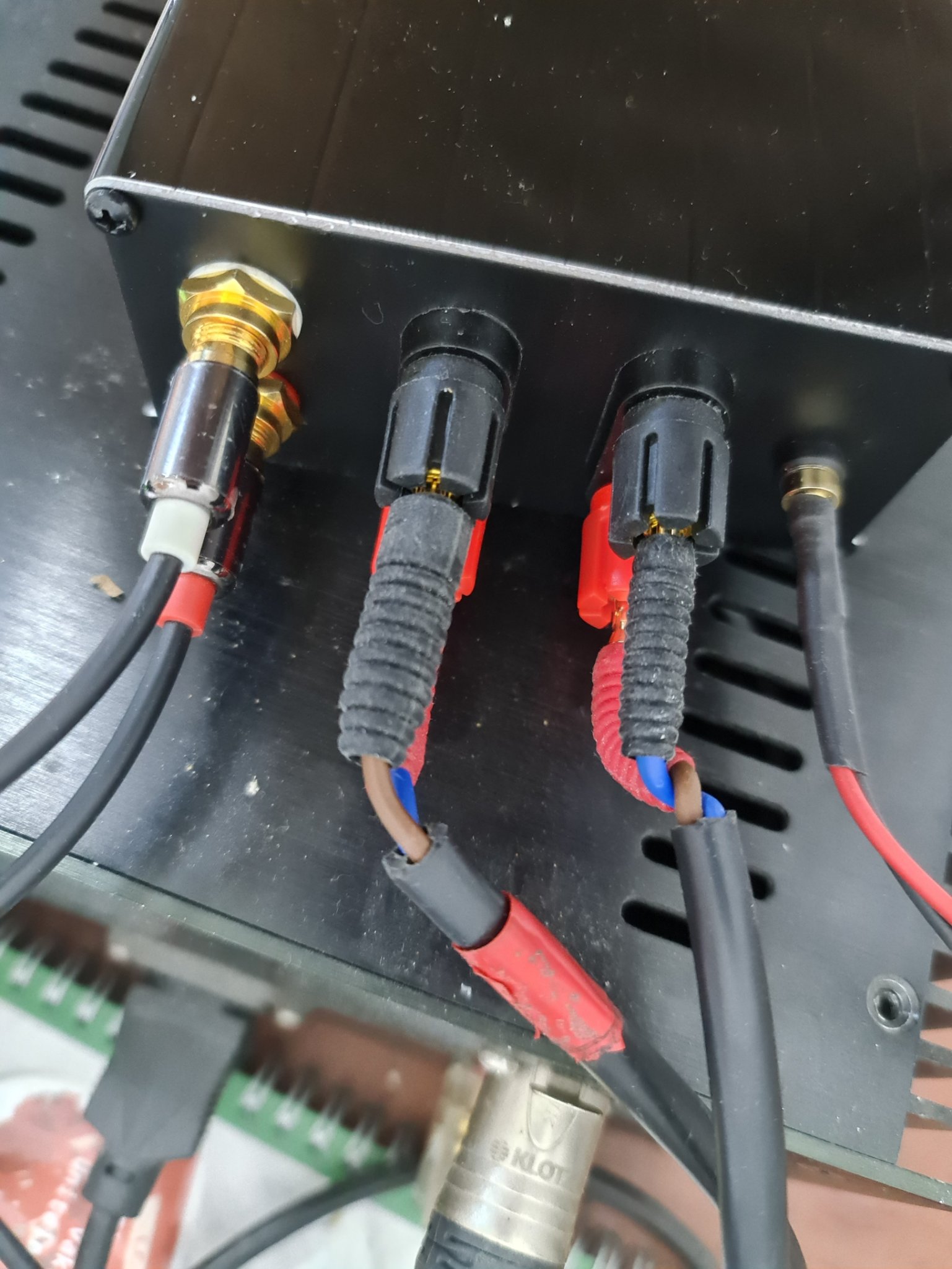

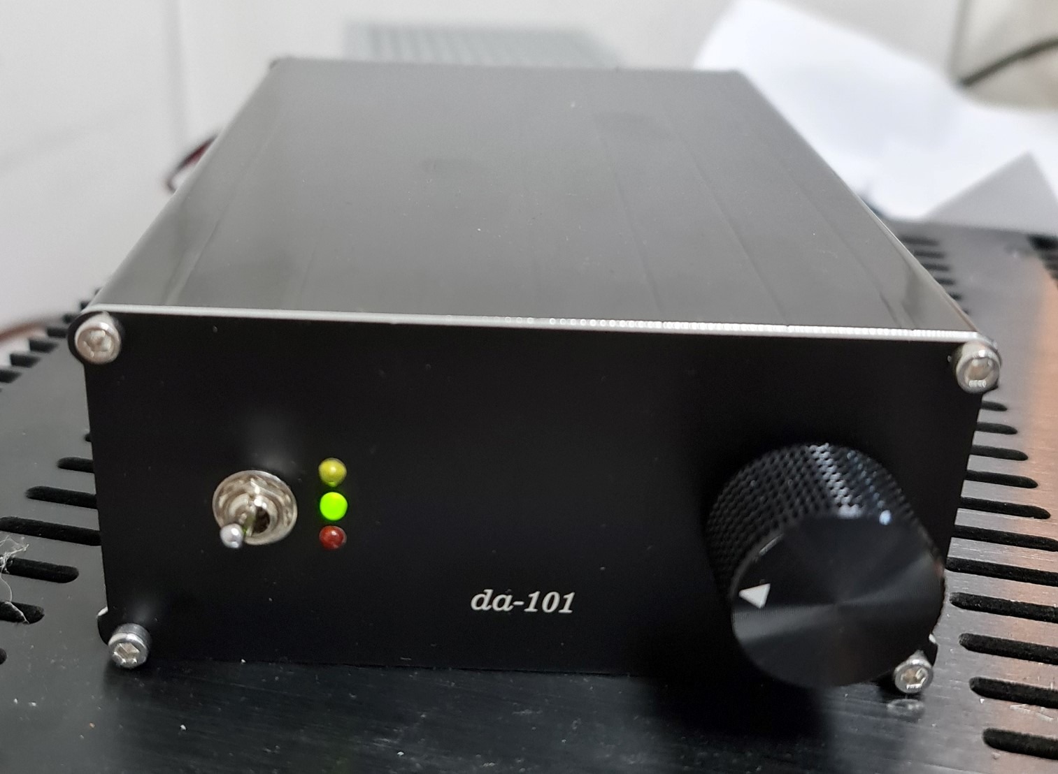

Since I don't like mess, I put the amp in a cheap aluminum box and took the connections out with cheap connectors (shame on me 🙁 ).
Power, clip and error leds are moved to the front panel. Also an ALPS RK27 10K pot is on the front panel with an alu knob (which is the most expensive part of this system)..

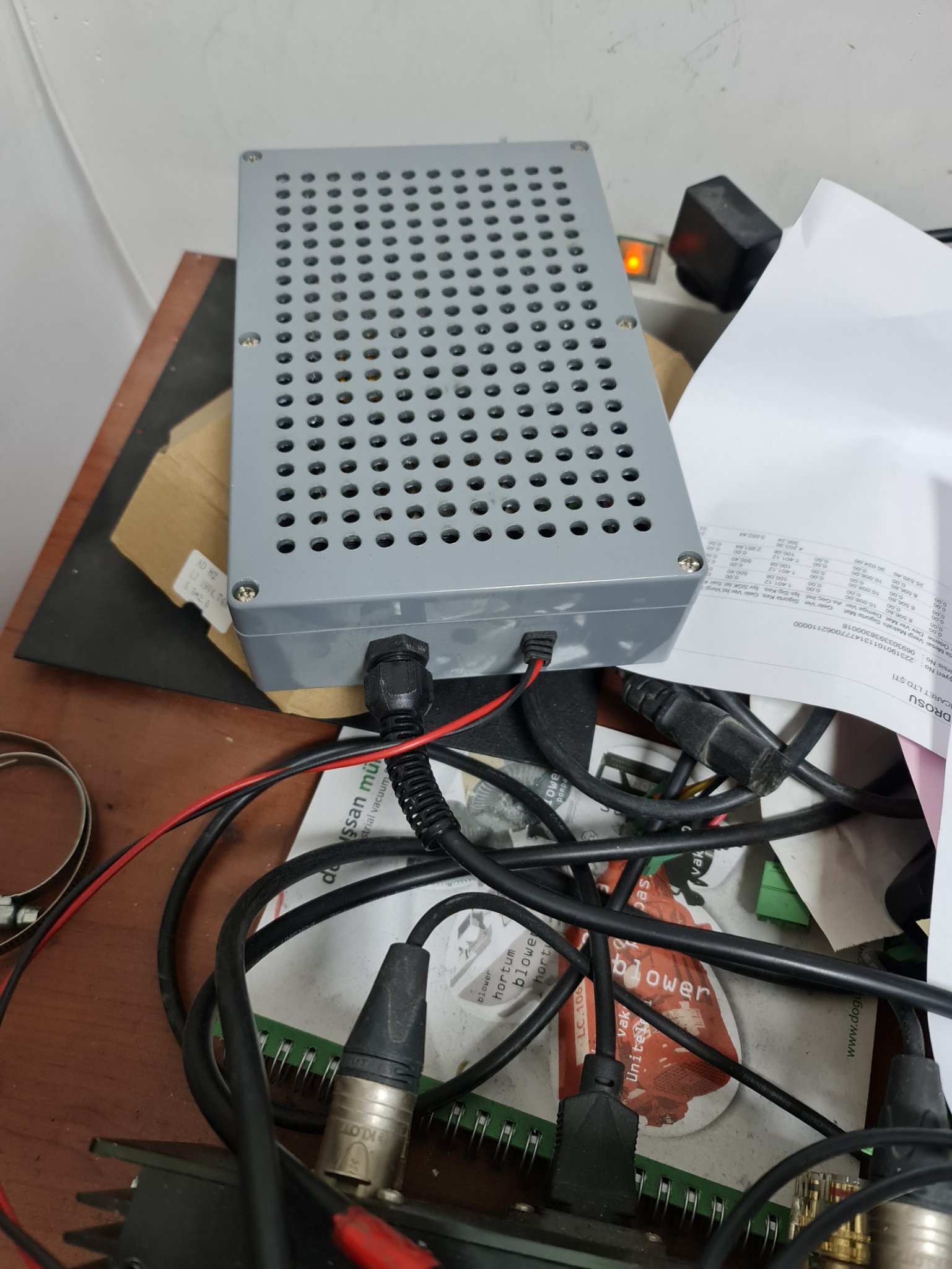

I fed my amp with a meanwell lrs-200/24 power supply set to 28v. I added a 2x3.3mH common mode choke and 1800uF low ESR capacitor to the output of the power supply, and I drilled ventilation holes in a cheap plastic box with a laser cutter and placed the power supply inside.
Obviously, the commom mode choke and low ESR capacitor I added to the output of the power supply had no effect on the noise. Therefore, I do not recommend it.
