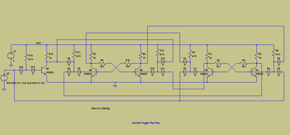

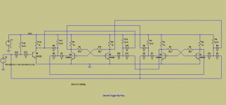

I'm disappointed, no takers for this challenge, means I have to think about it myself :)
Attached is what I have come up with so far.
Any improvements, suggestions, comments?

Hello DIYAudio,
funny this thread should exist, as I am currently looking to build nearly the same component.
I unfortunately have no idea what to do with a .asc.txt file, but I did look at heater's circuit:
I have to say, wow, that's a lot of components.
Isn't there any easier (read, cheaper & smaller) way to build this circuit?
I don't really care if it uses transistors or relays, the important things are low cost, and hopefully also low power draw.
I found a circuit using three 4x relays, however those alone would cost about 21€, and seeing as I'm looking to build 5 flip-flops, 105€ is really too expensive for me.
Are there any cheaper ideas?
powerbecker did it. It has 2 npn trans, 6 resistor, 2 cap, and 2 diode.
i removed the .txt extension into .asc, and opened it with ltspice.

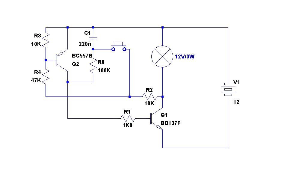

The circuits shown will not actually work as the OP wants: they require debouncing and fast, clean edges.
Some more components would be required to make them work.
This circuit will actually work, and it is not more complicated.

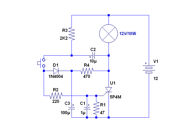

As a bonus, one more based on a SCR:

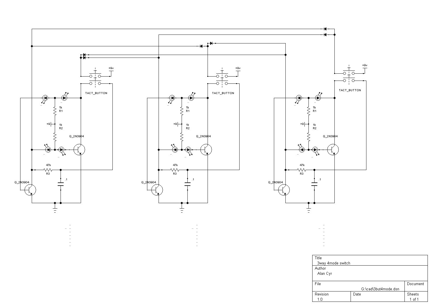

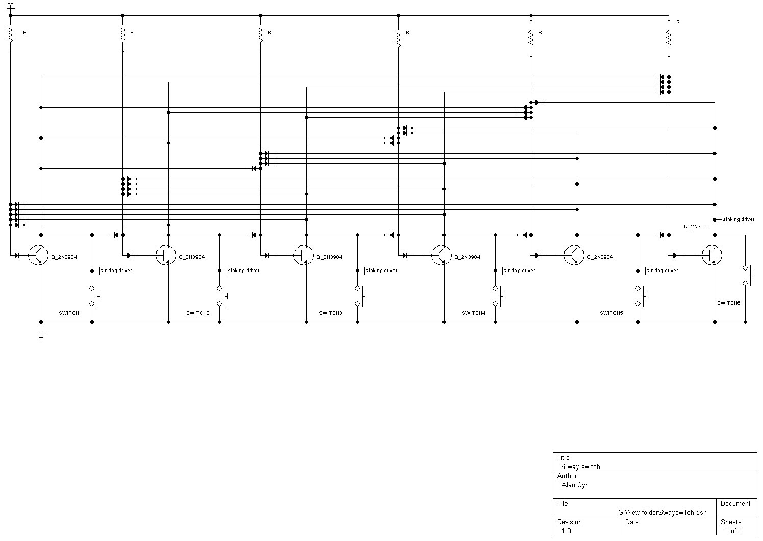

Hello PBR

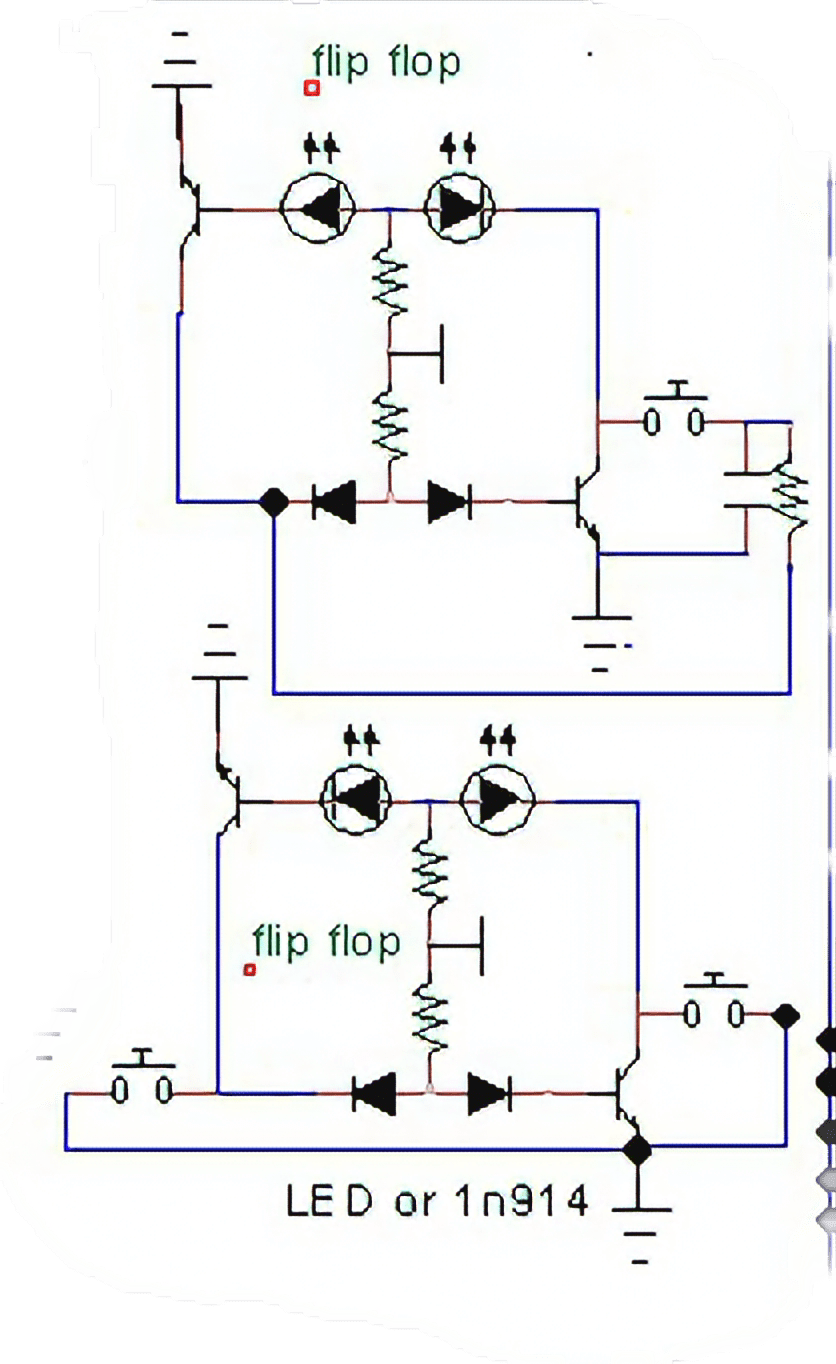

Your right they did do a good job . 60 years since a discrete component flip flop was released ? This one is a little different in some situations less parts are needed. The switching is done at the diodes. Very fast switching. Minimal parts. And expandable to multiple switch 3 way 6 way whatever you like.

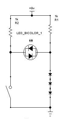

Not sure how to respond to your response was that directed at the switches at the diodes explanation? Or ?
This should help explain how. Schematic attached . It's unbalanced contact potential that makes it work.
