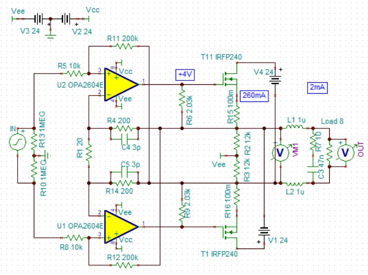

Minimal parts Circlotron
Hi, Another modify for this SUMO NINE like circlotron .
This version use the more popular IR MOSFET IRFP240 or IRF530 . The IRF530 in small signal had more distortion then IRFP240 .
@Ryssen,
Not yet , This schematic is when I study the SUMO NINE and try to make minimal parts variation .
@EUVL,
Thanks !
The PASS's "THE AMAZING FET CIRCLOTRON" is minimal too, but when simulation I can not get a acceptable result , I think op-amp SUMO NINE like may be a easy way to try Circlotron.
